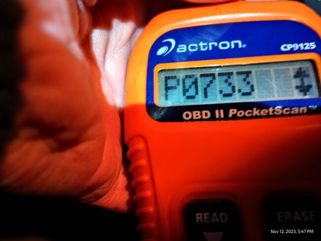

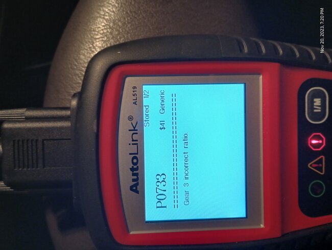

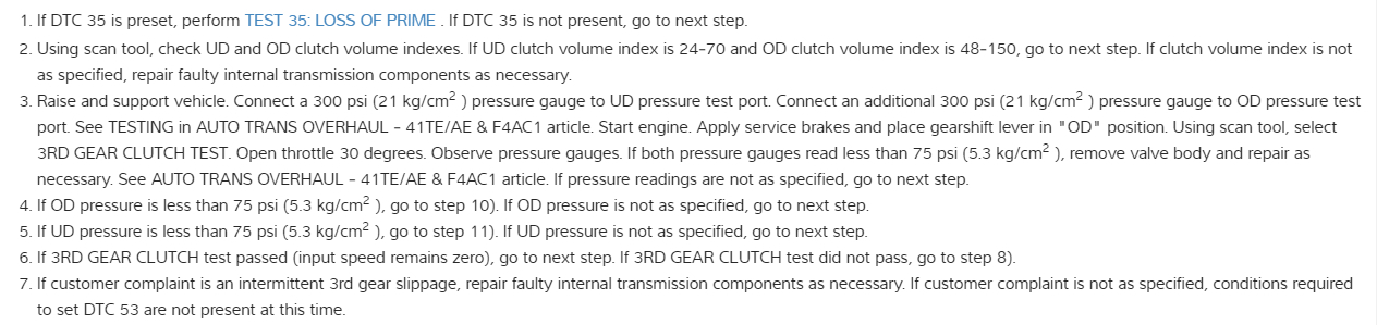

Just had a used transmission installed because of a blow out of one of the cooler lines losing nearly half the ATF +4. The shift solenoid pack is brand new direct from BorgWarner as are the Speed Sensors (from AutoZone). This transmission only has 90,000 miles on it.
Symptoms-

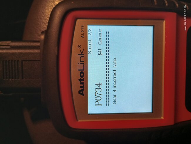

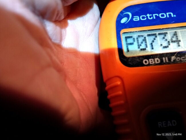

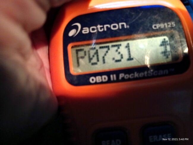

Showing signs of slipping, hard shifts, erratic behavior that prior to the blow out of fluids never had happened before. Keep getting P0733 and P0734 DTC codes telling me that the errors in shifting in gears 3 and 4. Funny thing is it was getting those same codes with the original shift solenoid on the transmission when it arrived at the shop. I had to drive it home with that shift solenoid pack because the new one had not arrived yet.
This seems to tell me the TCM got damaged during the blowout situation or from the faulty shift solenoid we recently found out was a remanufactured piece of garbage put on 4 years ago with new speed sensors. So, having never changed a TCM in a 3rd Gen Chrysler (unlike PCM malfunctions in old Grand Caravan of same year) I need to know if replacing the TCM is most likely then does this particular year require it to be "flashed" or can it be installed and go through relearn stage. I know at some point Chrysler changed the TCM to the scanner required type just don't know when.

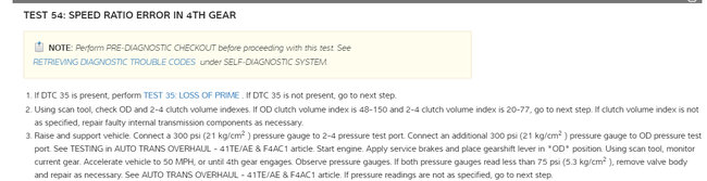

Both codes are related to line pressure issues. Have you tried flushing the transmission cooler and cooler lines?

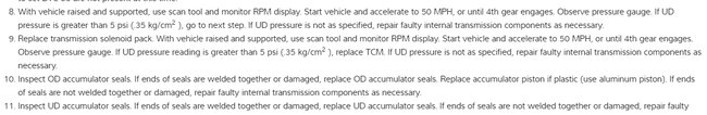

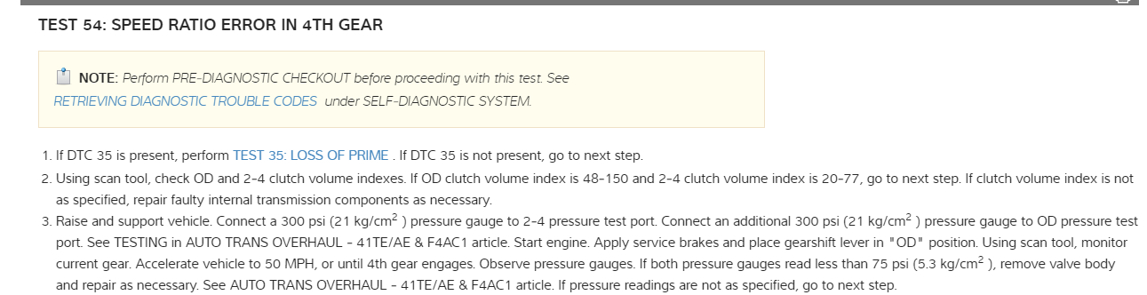

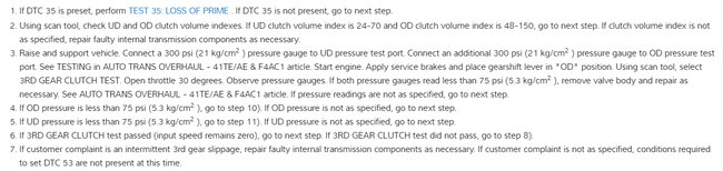

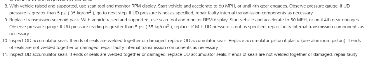

I have diagnostics for both of the codes and have attached them below. Note that test 53 is specific to the P0733 and test 54 is specific to P0734.
Take a look through them and let me know your thoughts. In my mind, since the same problem is present and related to line pressures at specific times, I'm questioning if there is a restriction in the cooler. It's only a theory at this point.
See pics below. (Test 53 / pics 1 and 2. Test 54 / pics 3 and 4) Additionally, the codes identified in the diagnostics are manufacturer codes. The P codes you provided took me to these manufacturer codes and tests.

I don't have any possible way to do all this. One, it's beyond my basic mechanic skills and Two I'm not sure if my Autel AL519 can do all that or not plus I don't have a specific pressure gauge that does 300 PSI as described. What I might be able to do is flush and blow out the cooler system which in this car is through the radiator (fins I believe) but I highly doubt there's a blockage. The reason I say I doubt there's a blockage is because when the "blowout" of the return line to the transmission happened it blew tranny fluid all over to the rear of the car, literally. The line came off the hose pipe because the clamp popped loose. The reason I'm thinking the TCM may have been damaged is previous electrical issues building up to the transmission burning out. I want to know if this model TCM requires a scan tool if I put another OEM TCM on it or do they require a reflashing? I know that Chrysler switched to the scan type but don't know what year. If I put another TCM match for the model and year OEM can I just do a simple reset and relearn without the scan tool. As mentioned, I'm not sure if the AL519 is capable of doing that reset/relearn I haven't used it much. $2,200 put in this so far $900.00 for the used transmission and $1,000 in labor getting it installed. This car isn't worth even 20% of that. All I want to do at this point is eliminate possible culprits based on known symptoms, that's all. I'm ordering a used TCM that should be here after the holiday. I can do the installation myself, no problem, as long as it doesn't pour rain or snow.

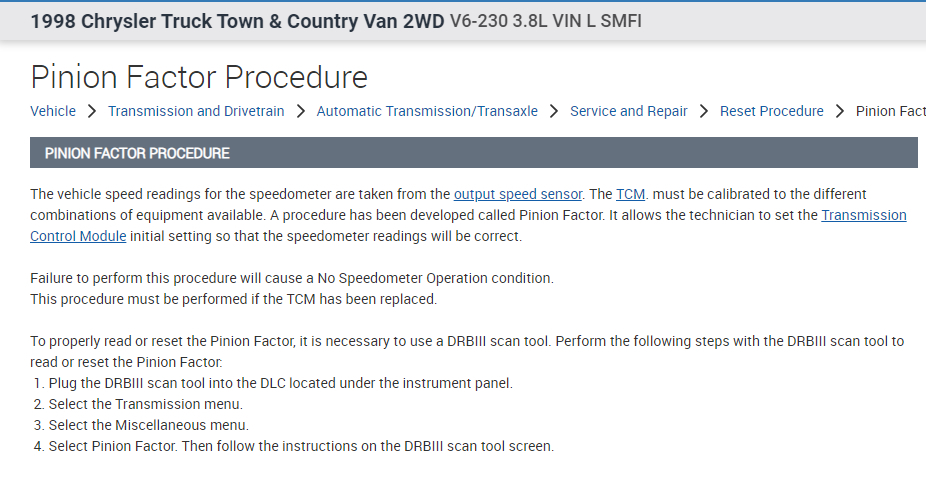

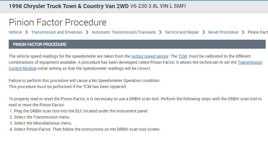

The pinion factor must be set for all new transmission control modules. If the pinion factor is not set or if it is set incorrectly, any speed-related accessories will not operate or will operate inaccurately. This includes the speedometer, speed control, rolling door locks, and other devices.
I attached the directions below for setting it. I'm not familiar with your scan tool's ability.
Let me know if this helps.
Happy Thanksgiving!!!
See pic below.

I didn't need to do all that Pinion Factor Procedure business. The TCM I put in it is an exact match right down to the alpha characters at the end (Firmware Version), it was a used one from exact same year, model vehicle as ours. TCM is functioning correctly now, the old one got damaged from electrical problem during the burnout of the transmission. As soon as my new scanner arrives, I'll run it through the software checks.
