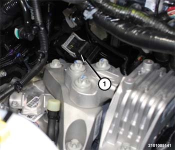

Where exactly is the TCM located? if i update the TCM doesn't that automatically mean i have to update PCM also?

The TCM is located on the trans-axle. You need to lift the vehicle and remove the left front tire to access it. Here are the directions for removal and replacement. It is below the Also, there are updates for programming of the TCM. And, you don't have to flash the PCM if this is done. If the TCM is replaced, then it will need done.

7. Remove the engine cover.
pic 1
8. Disengage the lock (1) holding the wire connector to the TCM.
9. Separate the wire connector from the TCM.
10. Remove the bolts holding the top of the TCM to the trans-axle.
11. Separate the TCM from the vehicle.

See pic 1
4. Engage the lock to hold the wire connector to the TCM.
