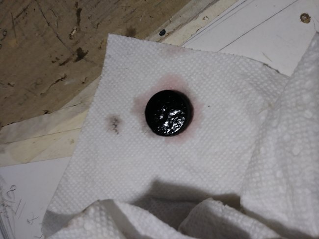

A604
  • 38 POSTS
I disconnected hose's from cooler put air pressure through it only got about a 1/4cup of fluid out of it is that normal?

CARADIODOC
  • 34,414 POSTS
On the few radiators I pulled apart for scrap metal, the cooler was a brass cylinder about ten inches long and perhaps 1 1/4" in diameter. I don't know what's inside that cylinder. I've also seen photos where the cooler was nothing more than a coiled piece of metal tubing that would probably be two feet long when stretched out. Consider that if an application requires a more-substantial cooler, it will be a small radiator mounted right in front of the radiator. Those are mostly cooling fins and not much tube. I wouldn't expect to get much fluid out of any of them.
Remember too that while transmissions reach the same temperature, around 200 degrees, that engines do, engines develop a real lot more volume, or BTUs. A candle gets a lot hotter than a car engine, but the engine needs a lot more cooling area of the radiator to get rid of that heat. The transmission develops its heat at a much slower rate, so it doesn't need as much surface area to dissipate it.
