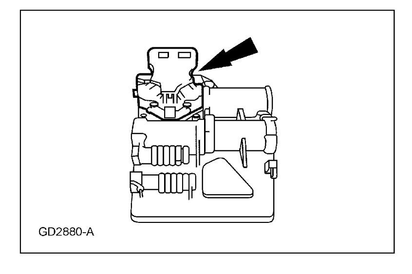

The solenoid is part of the solenoid pack on top of the valve body inside the transmission.
I attached a picture for you.

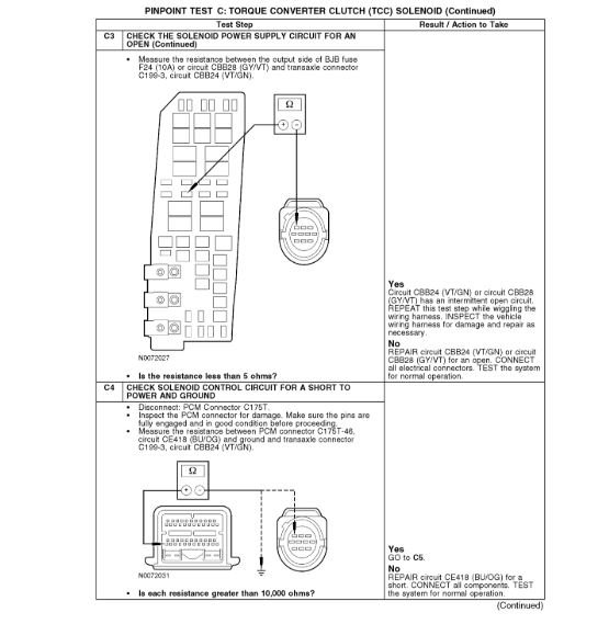

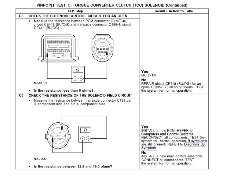

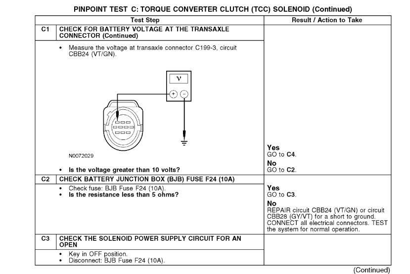

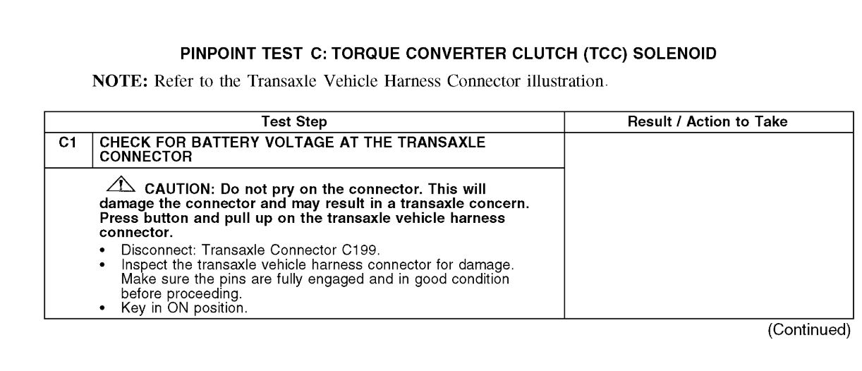

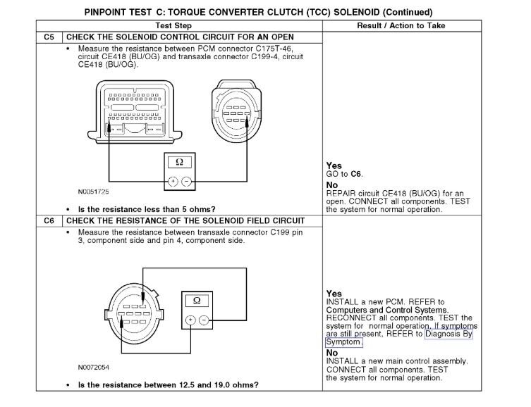

Okay, first, there is no cleaning these solenoids.
I would have the fluid changed and the filter as well. A clogged filter will cause the delays that have as well as the code.
The code is for the circuit, not the solenoid itself. I attached the flow chart for the code.

You are welcome.
There is a wiring harness that goes into the transmission itself. That is the connector you have to disconnect.
