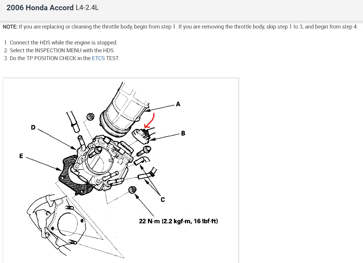

I am not sure what your mechanic is telling you but there is only one electrical connector for the throttle body. Please check the images below.

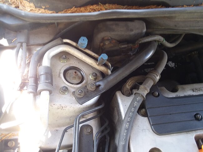

Here's a screenshot of a video I just watched, looks to me, that there is just 1 TBS, as you say, and it is located on upper left corner of engine.

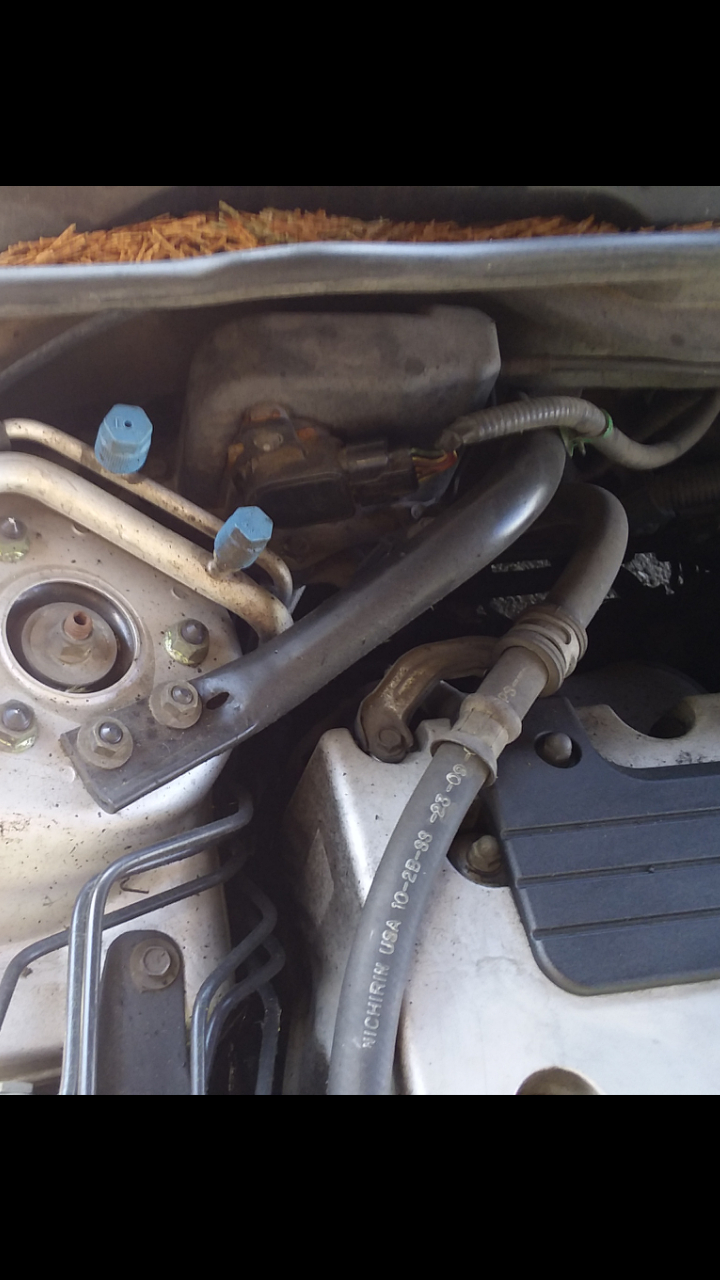

I will try again to attach a photo of 'under the hood.'
I think my mechanic may be misinforming me, saying there are '2' TB Sensors. Online, it says only 1, located at far Left upper corner of engine area (see Screenshot).

The sensor in the photos is not on the throttle body?

Oh dear, I give up! This is where the online mechanic video shows the TBS is. My understanding, is that the Sensor is inside the TB. Is this incorrect?
