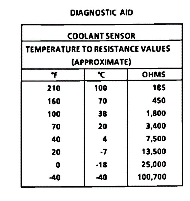

I need you to check something. Disconnect the temperature sensor. Use your multimeter to see how much resistance there is. Then based on the ambient temperature, see if the ohms align with the scale below.
I have a feeling, based on the ECT sensor's signal, the computer may be overcompensating for fuel. By disconnecting the one injector, you are cutting the supply in half.
For example, if the ECT is indicating it is -40F below zero and it's 80 degrees outside, the computer would add fuel for the engine to run. It would be too much and cause flooding. If the ECT is indicating it is 210 degrees and the ambient temperature is 50, it will want to lean things out. It's only a theory at this point.
Let me know what you find.
