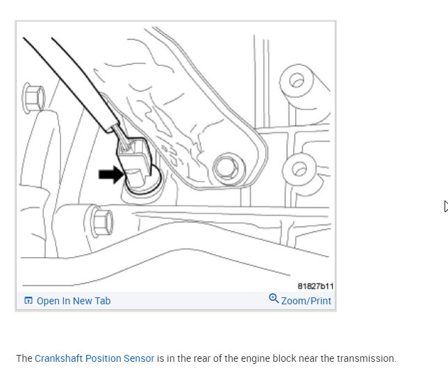

Hi, I have this problem with my vehicle, when starting the vehicle it takes couples of seconds to turn on? Also when it's on it sounds smooth and good but then when I shift to drive it jerks pretty bad, and when I press on the gas the rpm's is going on 3,000 close to 4,000 and speedometer is barely going 10 mph why is that? It has to reach 3,500 to 4,000 to change gears what can it be? I changed the MAP sensor, crankshaft position sensor, changed 2 ignition could,did an oil change, and charged the battery.

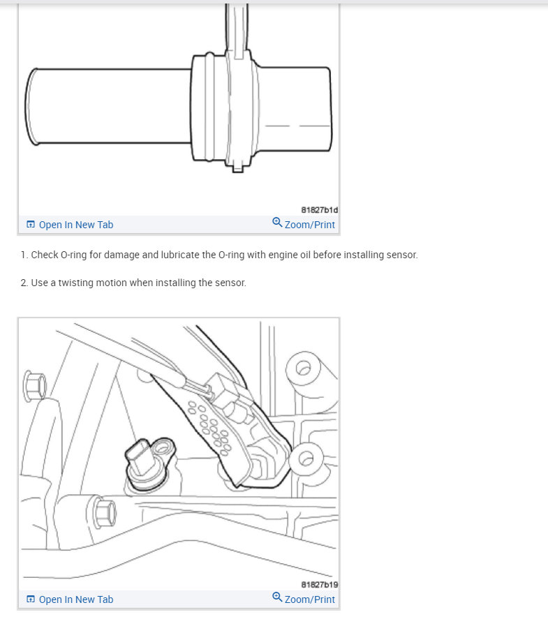

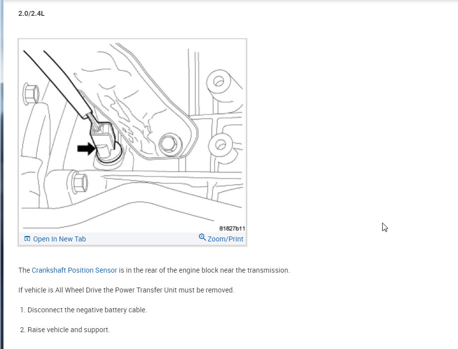

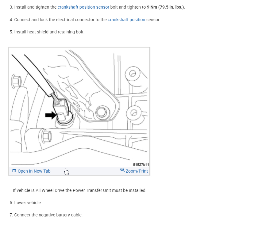

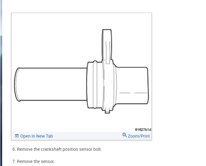

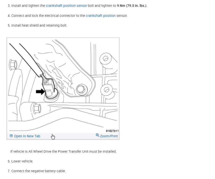

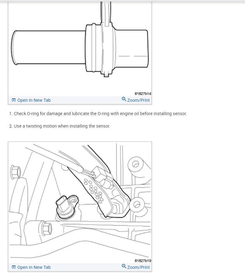

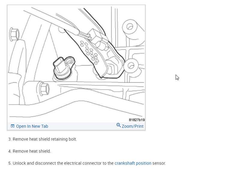

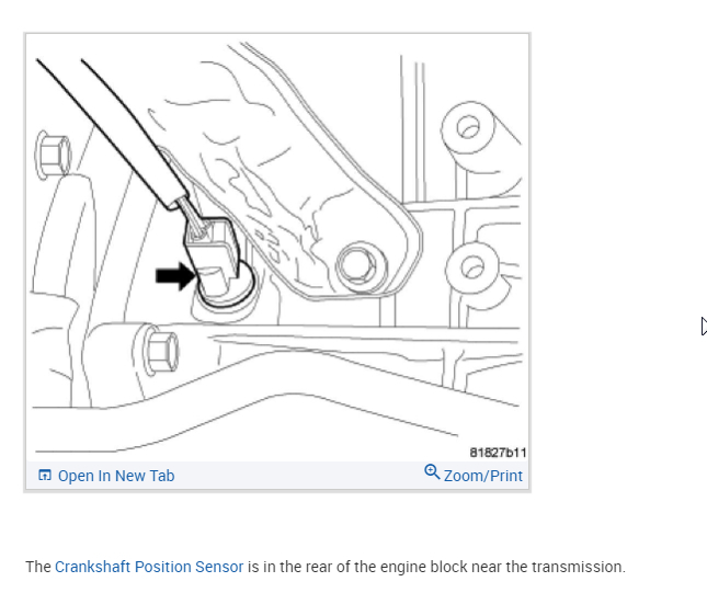

Okay. With that information I suspect the crank sensor is the issue. What happens when these begin to fail is they do not report the engine position for the PCM to fire the plugs and injectors at the correct time. However, if you crank the engine long enough and the PCM learns the engine position off the cam sensor it will start the engine. Normally when this happens it will set the crank sensor code that I assume you are getting.
Can you provide the actual crank code you were getting and we can test this to confirm it is the sensor? I you want to go ahead and replace the sensor that would be fine as well because I am pretty sure that is the issue.
However, if you do replace this sensor, you need to have a learn procedure run with a scan tool after it is replaced or you will have a lot of different issues like misfires and various other performance issues.

I actually did replace the crankshaft sensor. How do I go about doing the learning procedure ?
Apr 19, 2020 at 1:36 PM
Unfortunately you need a scan tool capable of performing a Cam/Crank relearn procedure. If you have one it is an actual procedure that you select and the scan tool does it with the PCM to relearn the sensors.
