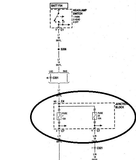

See the two fuses in the circle, one is for left tail lamp, the other is for right tail lamp. Not only check the fuses, use a test light, check voltage at fuse. Those fuses get voltage from headlamp switch. At the rear, black wire is ground. Need voltage and ground. I did look up a couple of those codes, don't think they have anything to do with tail lamps. The p0705 talks about transmission range sensor. The p1694 has to do with buss messages from PCM.

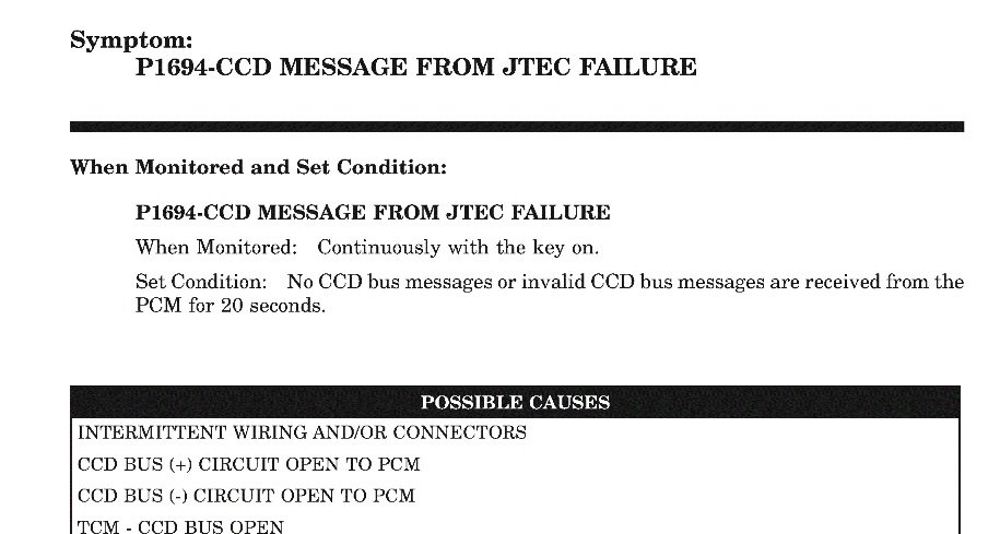

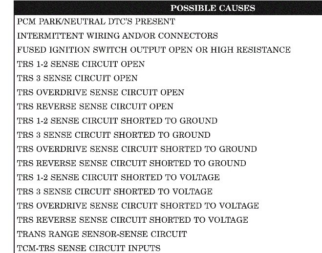

JDL
  • 16,098 POSTS
This is for p1694 also, possible causes for p0705. Hope it helps.
