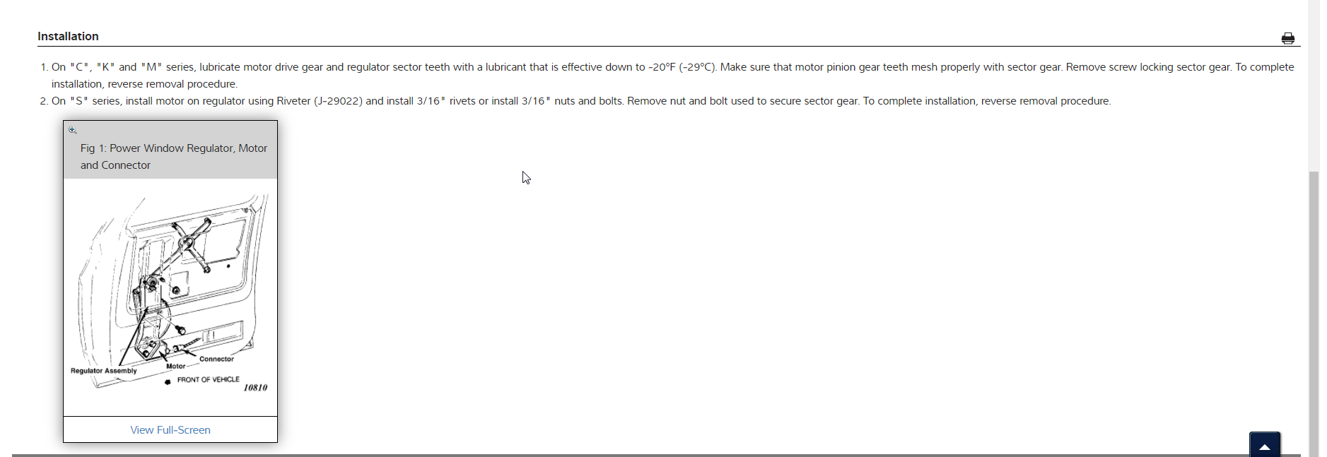

Bought the vehicle listed above used (K-5). Electric window in tailgate motor is missing. Have new on, but need installation instructions.
Jan 27, 2018 at 6:38 AM
This process is no different then replacing the window motor on a door. You just remove the panel and put the motor in as it states for a door. I am attaching that process below for your review. The manual does not list a process for the tailgate so we can just apply this to the tailgate and you should be good to go.
Also, here is a guide on how to remove a panel:
https://www.2carpros.com/articles/door-panel-removal
Let us know what questions you have. Thanks
