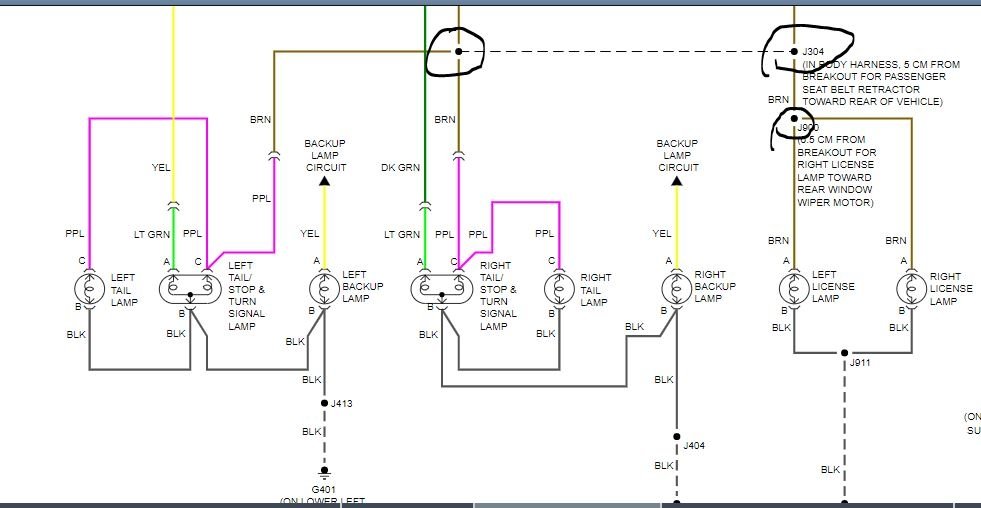

Hello from Tulsa Oklahoma. I recently had a problem with the rear park/running lights not working. After a lot of head scratching and cursing the engineers of the Uplander I found by the luck of the car gods a short in the wiring and now the running/tail lights work. However the tag lights do not. Is this not in the same circuit? I can't find a fuse designated specifically for them, which doesn't surprise me. It took a half a day to find the interior fuse block. Anyway thanks in advance. Any input would be appreciated.

The power comes from the same place. If you look at the schematic I attached, you will see that the brown wire that powers the license plate lights attaches to the tail lamp circuit. However, there are a couple splices that may be causing the problem. Check to make sure nothing is broken or corroded.
