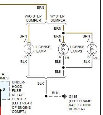

i have a 1996 K-1500 Chevrolet with the aftermarket bumper that has the two round push in tag light. The ones that if you live on dirt roads the get dirt and mud on them and they loose ground or the bulb shorts out. Well a very kind police officer informed me the other night that mine were not working. Luckily he has a similar truck and knows that they tend to do that so all I got was a warning. I was on the way to some friends and once there turned out they had one they bought for someone else's truck but ended up not using it. So I wired it up took some sandpaper to the hole and stuck it in but no go. On the way home i decided to see if I could eliminate the problem, So I soldered a wire to each of the sockets on the outside. I checked from the end of the wire to the socket and got 0 ohms resistance so I know the solder took hold. I put a bulb in each one and stopped under my hood and touched it to the battery. Both lights worked. Wired them in turned on the lights. No tag lights. I pulled out both bulbs and read 12 volts between the center contact and the socket on both put the bulb back in still no lights. Anybody got any ideas here because I am baffled. I tested them before I put them in and they worked. I have the right voltage but they do not work.

You did everything right, but for some reason the bulb isn't making contact. Most commonly, the power supply (center bottom) of the light socket will drop in too far and then the light does not touch it for power. If you have power and ground, that is my guess at this point.
If that is the case, replace the socket. I have never been able to repair those sockets. It is almost as if the plastic under the power supply melts and the power drops too low for the bulb to reach.
Let me know if that helps. Also, just for the heck of it, with the lights on, push in on the wire from behind the socket. If it is loose, the bulb should light.

Welcome back.
If the bulb was shorting, it would blow a fuse.
Okay, lets start over. I attached the portion of the wiring schematic for you to see. Now, according to the schematic, there are two brown wires, one to each of the two lights. Then, there are two black to ground on the frame.
If you are getting power to the brown wires and you have a good ground, I cannot see how it does not work unless the sockets are bad. I misunderstood earlier. I thought you did not use the new socket.
What I want you to try is this. Make a long jumper wire that will reach from the black ground wires from the lights and run it directly to the negative battery terminal. If they work, you have a bad ground. I realize you have cleaned a new ground, but it may fail under a load. This way we can confirm if a good power supply is going to the light. If it does light, we need to make a new ground. I cannot tell you how many times I would check continuity for ground and it checks good until a load is placed on it.
Try this and let me know what happens.

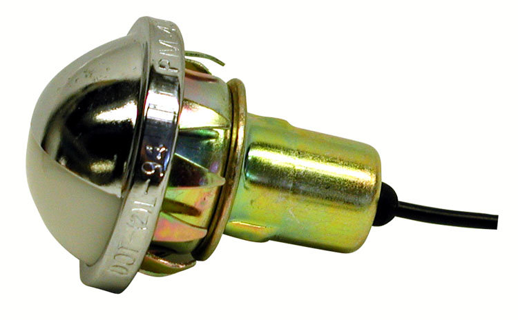

Okay Joe, this is not a factory bumper. This has the single wire tag lights that have been around for years that are suppose to ground when you push them in the hole but when that failed is why I solder a wire to the socket to create a better ground. I was just discussing this with a friend and we thought about running a jumper direct from the battery checking both power and ground as they did work when I battery tested them before installing them. So that will be in the morning and Ii will post my findings. One thing I did not think to mention as it is not a constant issue but sometimes the left turn light on the dash does not come on yet the bulbs are blinking on the outside. Did not know if maybe that is related some how as it is all exterior lighting except for the turn lights in the dash.

This is the style I have, but on mine I have soldered a ground wire to the outside of the socket.

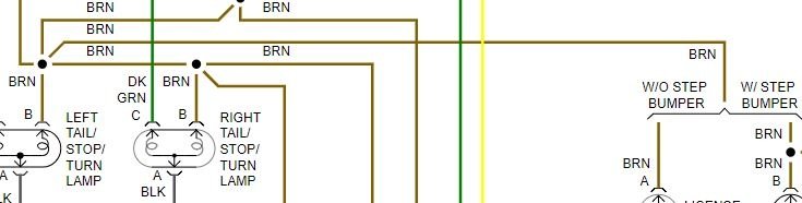

Sorry it took so long to get back to you we got hit with a winter storm this morning freezing temperatures and 40 mph wind. Here is what I did and the results Ii built and ran a dual line jumper from the battery to the back of the truck. Made sure they had power meter read 13.81 volts first I cut the ground loose from the bumper and hooked that up and turned the lights on still nothing. Then cut the brown wire and hooked it to the jumper bot tag lights lit up just as they did when I battery tested them before installing them. Then to verify it is a power issue I hooked the ground back to the bumper and both lights lit up. So that eliminates all questions about grounding problem. Before crawling out from under there I checked the brown wire it had 12.37 volts. I still do not get where the problem is one would think that would be enough voltage to run the tag lights. Now the question is, where does the power in the brown wire come from and do I replace the wire or go with the toggle switch plan?

Interesting. So, there is 12v volts in the brown wire and it does not light up, but when you supply a jumper wire to power, they do.
The only thing I can think of is there is not a big enough draw on the brown wire when you test it for it to fail. However, the bulbs draw enough to cause it not to work.
With that in mind, here is what to do. The power to the brown wire comes from the left rear tail light. It attached via a splice in the wiring. My guess is there is a weak connection at that point. What I would do is simply go back to where the splice is located and check it. With the lights on, wiggle that splice around to see if the lights flicker.
If they do not, cut the brown wire running to the lic lights and replace it. It must have a break in it at some point.
I attached the schematic that shows where they splice together. Do this and let me know how it goes.
