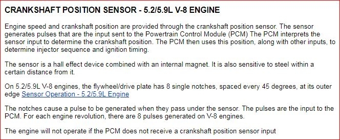

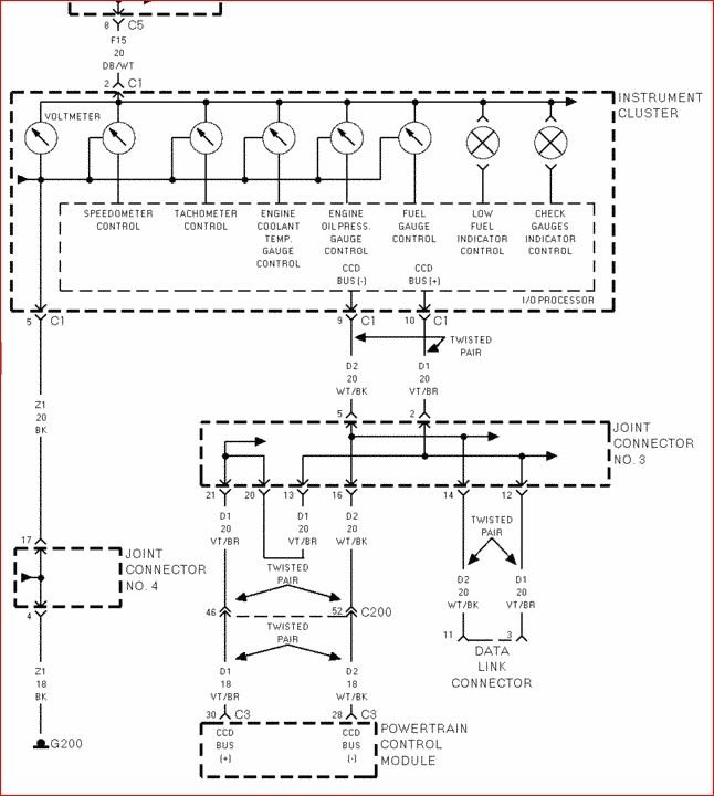

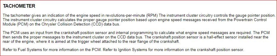

I would think there has to be something else that happened. The reason is, the tachometer is run off of the crank sensor. However, the crank is an input to the PCM and then the PCM sends the signal to the cluster via the data bus to display RPM on the tachometer.
Plus the distributor is run off of the camshaft not crank so even if something happened to the distributor it wouldn't effect the crank sensor. Also, if the PCM does not get a crank sensor signal, the vehicle will not start. You didn't mention it not starting plus, how else would you know that the tachometer is not working.
Unfortunately, I don't see a correlation between replacing the cap, rotor, and wires to the tachometer not working. I can only recommend getting the vehicle scanned for any diagnostic trouble codes. If you have access to a scan tool to get the DTCs then maybe monitor the cluster and see if you are getting a signal from the PCM about RPM. If you are then there is an issue most likely with the cluster.
