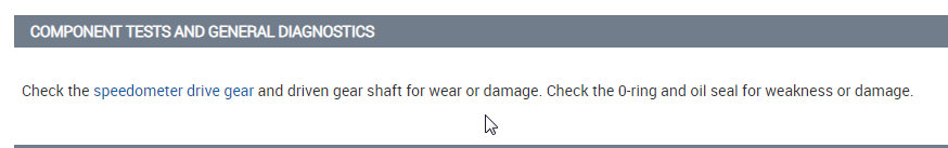

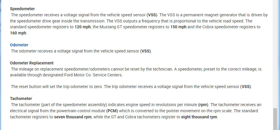

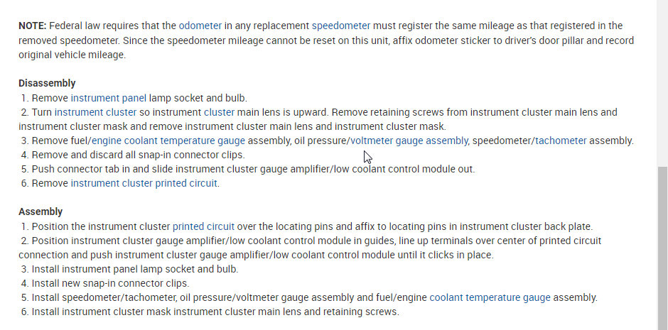

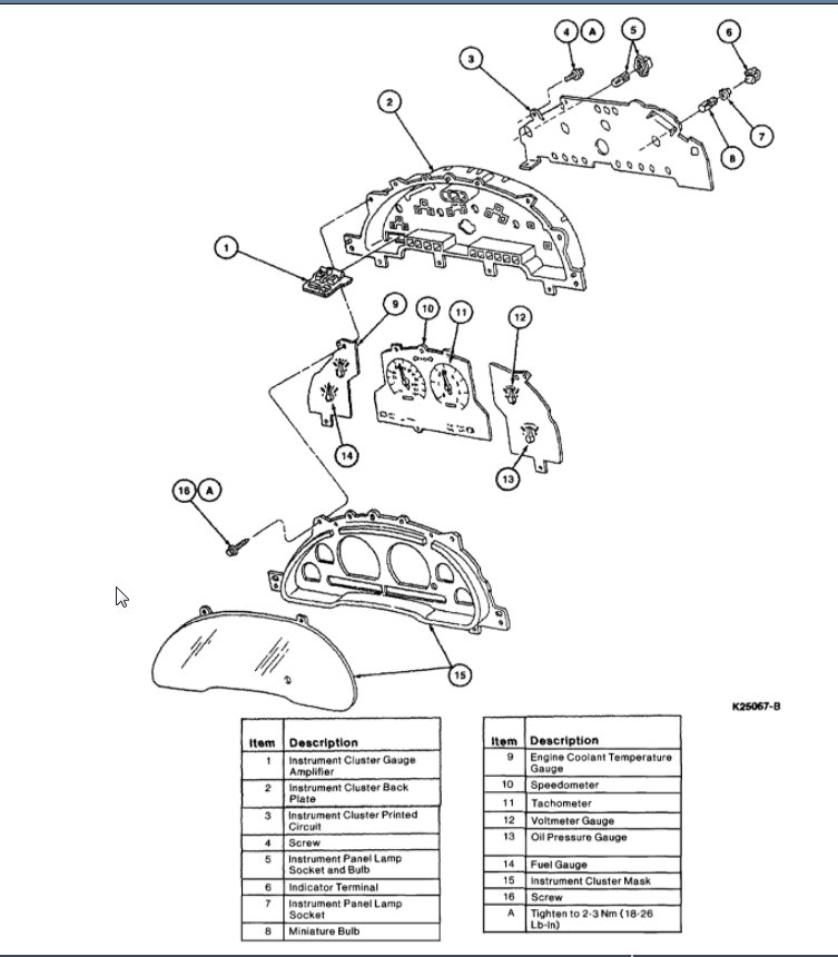

The fact that both the speedometer and tachometer do not work some times points to the cluster itself.
Take a look at these attachments. More then likely there is an issue with the circuit board or connections at the cluster. The speedometer and tach are part of the same assembly. So the fact that both stopped working points to the cluster because while they are part of the same assembly they get their signal from separate places. The speedometer gets it from the speed sensor. The tachometer gets its signal from the PCM. The only thing they have in common is the cluster.
