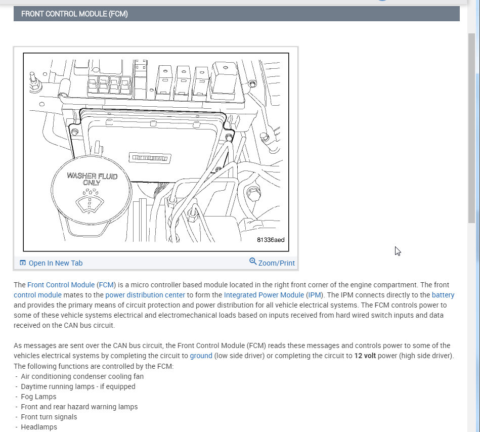

The left turn signal stays on, the wipers stay on, the headlights will not come off of bright, all this only happens when the key is on or the car is running when you turn the car off it all goes off. I have already replaced the multi function switch it stopped for the day then started the next day doing the same thing i have tried to reset the system by take both battery cables of letting them stay unhooked for 10 minutes and reconnecting them still doing the same thing.

Okay. Unfortunately that just points to what I suspect is the issue which is the FCM.
Let me know if you can get codes. Thanks

JOE MILLER4
What is the front control module?
Sep 22, 2020 at 12:44 PM

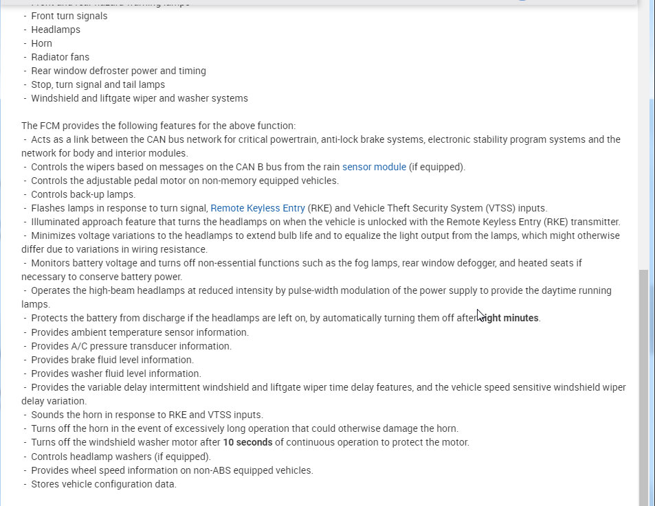

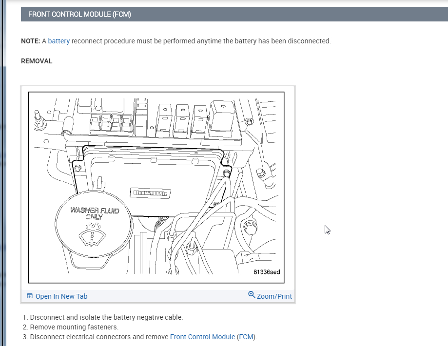

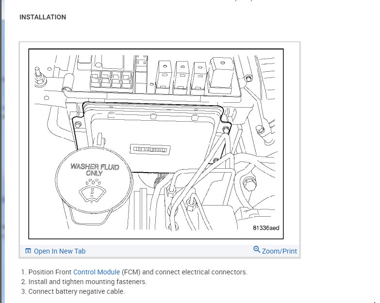

I attached the description and operation of the FCM and the process on how to replace it. Let me know what other questions you have about this.
If it were me based on this information, I would replace this and then retest the vehicle.
