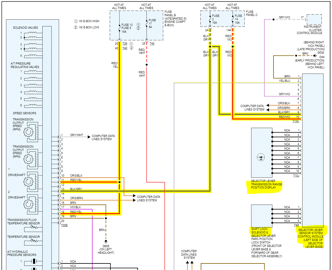

Gear shifter stuck in gear and reverse/drive/neutral and screen on cluster is flashing PRNDS
2008 AUDI A3
184,000 MILES • 2.0L • 4 CYL • TURBO • 2WD • AUTOMATIC
STRONGSIDE760
Battery is new, but it seems like it's starts slow sometimes like it's drained.
Nov 26, 2021 at 3:32 AM
  • 110,244 POSTS

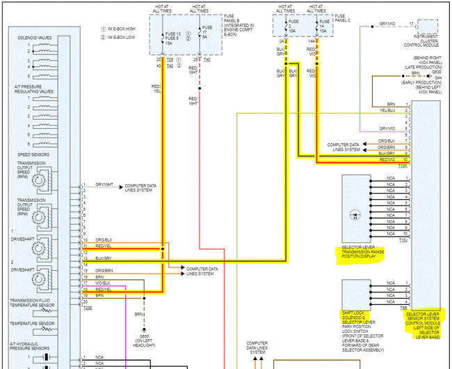

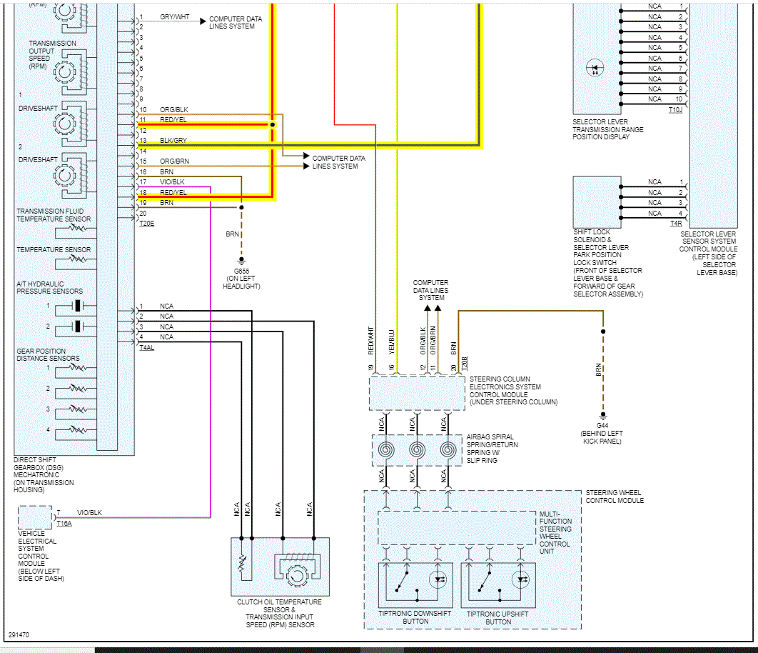

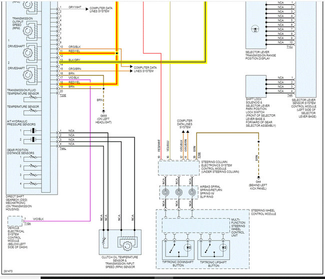

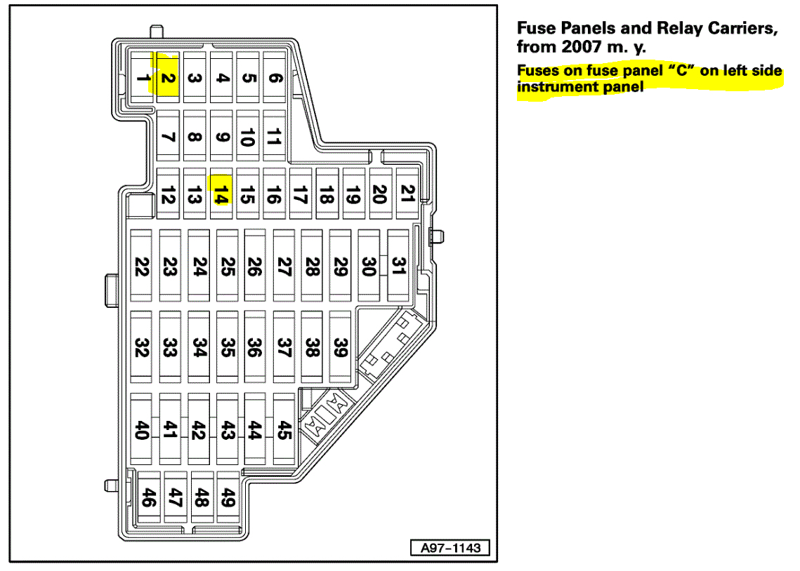

There is a select lever sensor system control module in the center console on the left of the shifter. This module plays a role related to both of the issues.

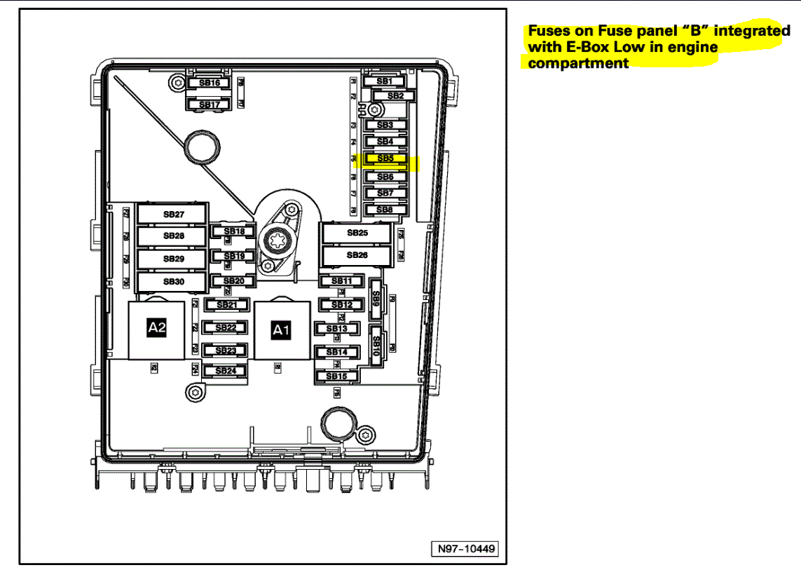

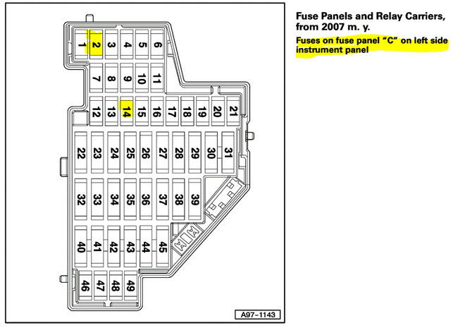

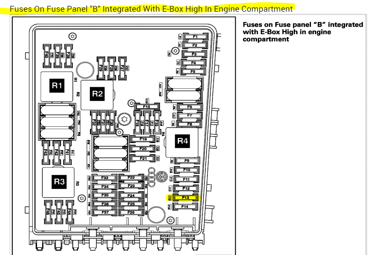

To get started, I need you to check three different fuses. In fuse panel C, check fuses 2 and 14. In fuse box B, it will be either fuse 5 or 13. The fuse number is based on the location of the box. See pics 3-5.
When you check these fuses, not only is it important to check the fuse condition but also, you should confirm there is power to and from it. Here is a link you may find helpful:
Do this first and let me know the results.

Checked the fuses they are all good and power Goin through them sometimes I'm able to drive the car and sometimes it will be running just not going into gear when the cluster PRNDS starts to flash and the ESP fault error comes on.
