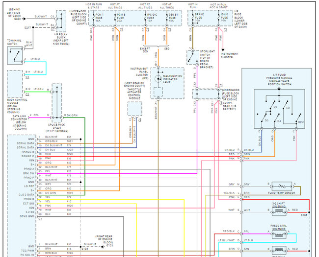

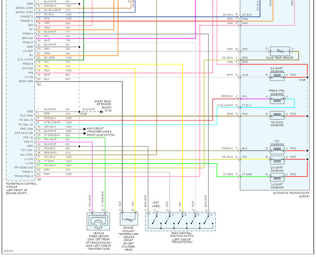

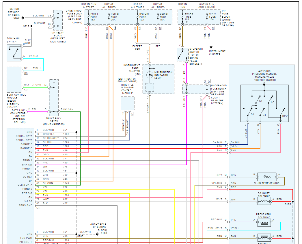

Did engine swap to 6.0l using 4l60e transmission. Did re-pin on harness using this guide: https://youtu.be/vZDXET1w1PY?si=SbLrY0crAHPXavOy. Have poor shifting, slipping and codes. Check connector and harness twice. Everything looks right. Perplexed. Please help.
Mar 4, 2024 at 6:48 AM
  • 54,840 POSTS
I would double check the pin location. also, did you swap the PCM and complete wiring harness? Here is how the transmission should be wired. Here is a guide so you can check the wiring connections:

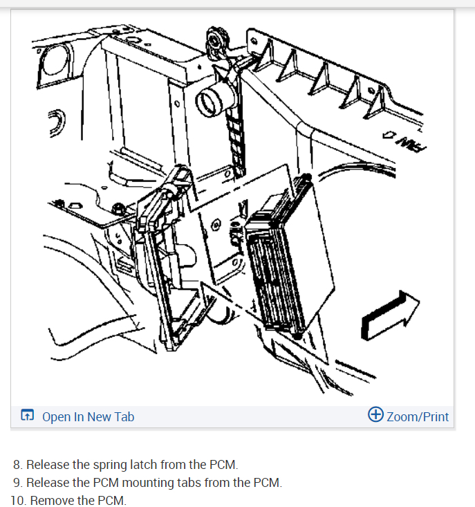

I checked the wiring and completed the wiring to the ECM. I did not swap out PCM. Is that inside the transmission?
Mar 4, 2024 at 11:23 AM

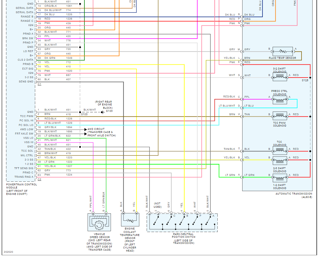

The PCM is the same from the 4l60 just reminded at pins 42 and 79.

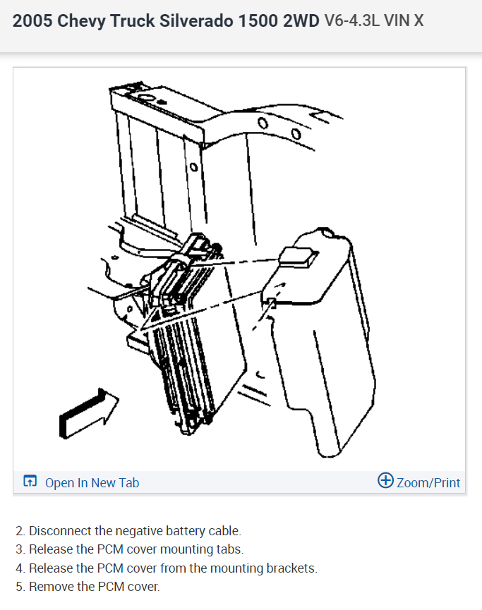

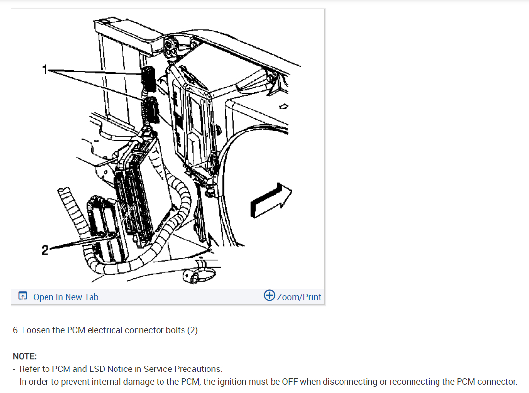

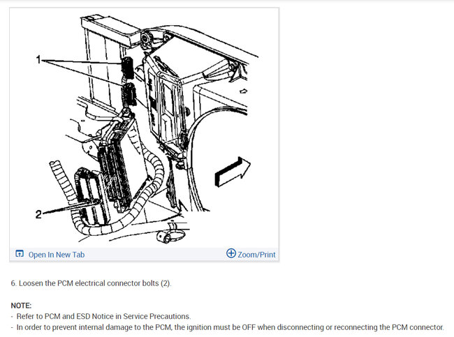

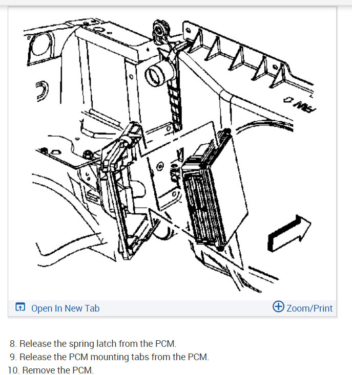

  • 54,840 POSTS
Sorry its Monday! You included the codes my bad. Yes, the PCM is located next to the radiator.
P0740 - Torque Converter Clutch Circuit Malfunction:
P0758 - Shift Solenoid 'B' Electrical:
P1860 - TCC PWM Solenoid Circuit Electrical
So, the wiring looks like it might be incorrect. I would remove the transmission electrical connector so you can match the colors the wires going into and out of the main transmission connector. Here is the location of the PCM. Check out the images (below). Let us know what you find.

So, I did check out the wires yesterday at the tranny. Moved original pin S to U. Created new S pin to ECM pin 79 and new T pin to ECM pin 42.
Mar 4, 2024 at 12:10 PM
CRYPTOKING
  • 27 POSTS
That's how I wired it. Is that wrong?
Mar 4, 2024 at 12:11 PM
  • 54,840 POSTS
I am not sure how you wired it, I would double check the colors going into, and out of the main connector to make sure it matches the wiring diagrams I provided. Can I ask why you repinned it in the first place?

The harness is from the 6.0l and the transmission is a 4l60. Had to do the re pin from what I was told.
Mar 4, 2024 at 12:19 PM
  • 54,840 POSTS
I would try putting it back to the way it was.
