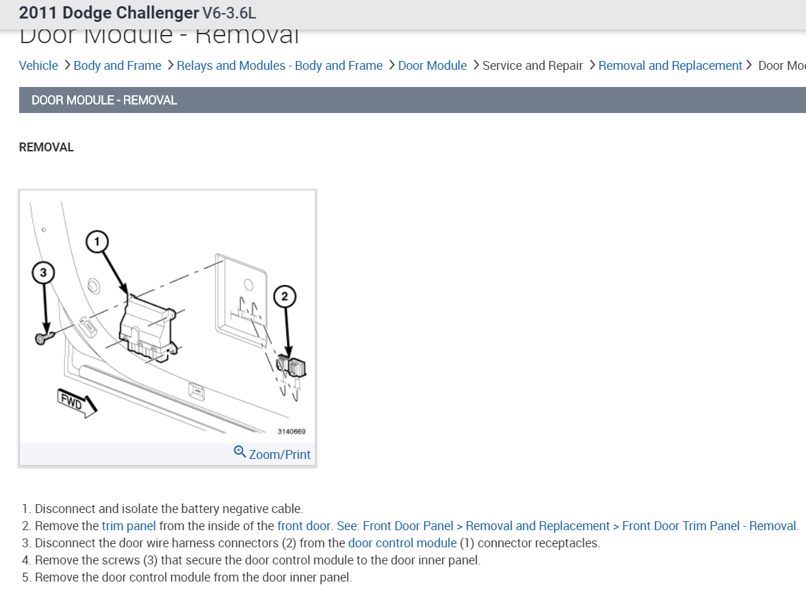

Is it possible to swap the drivers door module between a 2011 Challenger and a 2013 Challenger? if so , what would be required to do it? Would I need to "flash" the ECU?
Aug 2, 2018 at 11:03 AM
  • 55,399 POSTS
If the part numbers are the same then you can swap them and you will need to get the module initialized. It should cost about $130.00 at a shop. Below is the door module location.
