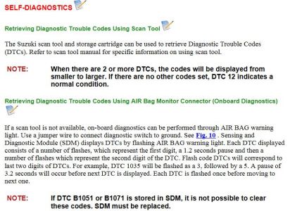

The air bag light on the dash came on and the warning bell/buzz for the right seat belt not being connected is not working and also my clock keeps flashing and I can not set the time. Someone told me that this is caused by a defective "Slider Switch" and because it is conected to to air bag system it would cost a $1,000 for the switch. Is this true? Please help.
Thank you
May 7, 2009 at 2:11 AM
KHLOW2008
  • 41,814 POSTS

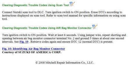

Hi Andy Ulichny, Thank you for the donation. In order to know what is wrong with the system and the cause, you would have to peform a diagnostic check to retrieve the code. Let me know the codes retrieved.
