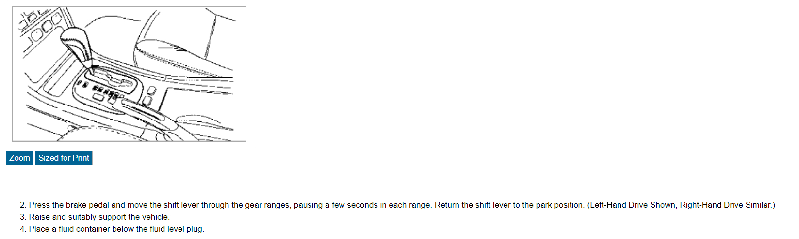

i have a 2005 suzuki verona and it sometimes lets me run in drive and than suddenly i will lose drive and have to go to 3rd to keep running this happens off and on and than while in 3rd at times it lets me shift back into drive. this is a off and on routine and never knows what gear it wants to be in
Apr 30, 2010 at 1:04 AM
DAVE H
  • 13,383 POSTS

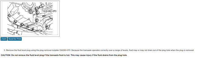

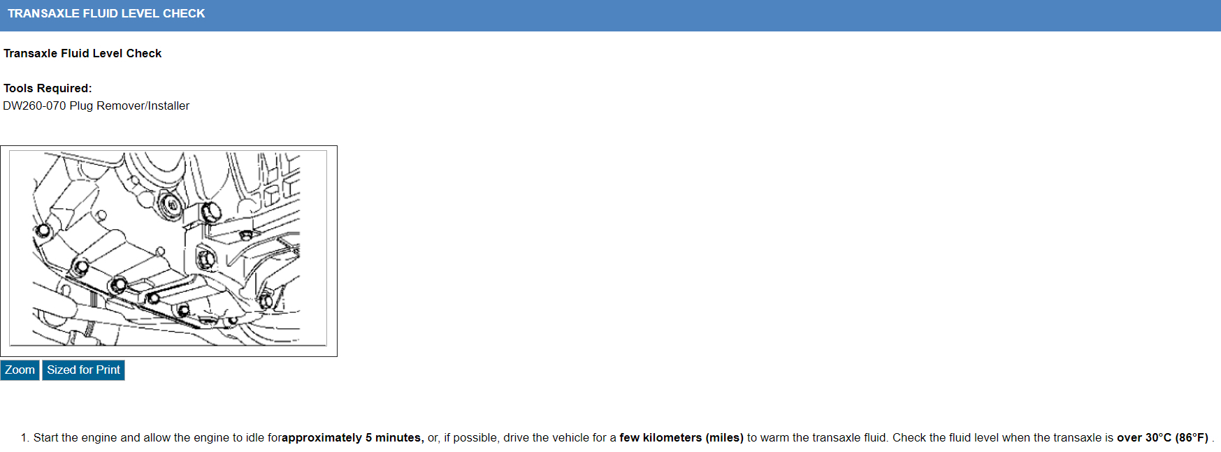

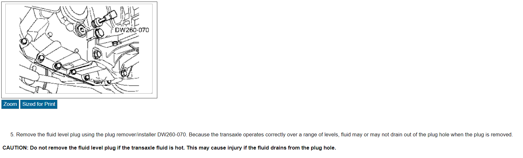

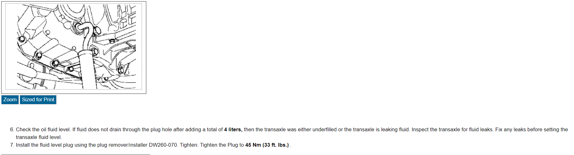

This happens when the transmission fluid is low. Here is a guide to help you check it with diagrams below to help you on your car.
