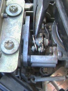

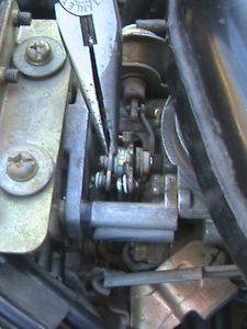

One more thing to note, and this may have something to do with the O2 sensor. I noticed when I bought the vehicle (Refer to pictures)
https://www.2carpros.com/forum/automotive_pictures/302995_DSC00238_1.jpg
https://www.2carpros.com/forum/automotive_pictures/302995_DSC00237_1.jpg
This bracket/ring was not even connected to the choke control or spring that regulates the choke, Somehow it had fallen off or became disconnected, leaving the choke on/open 100% all of the time. It was like this when I got it, and I am wondering if this was open all this time and not regulated, would it affect the O2 sensor in anyway?
I noticed this before my first test, but thought nothing of it...wasn't to familiar with the carb or parts, but after the 2nd emissions test that I did rather good on, I saw the round bracket below the assembly, brought it back up, seated it back into it's place and connected the spring. It was after this repair, and changing a vacuum valve that was faulty, that I went off the charts on my 3rd test. The vacuum valve that I replaced and the MCV (Mixture Control Valve) are between the air supply and carb. I didn't have to replace the MCV because I tested it after replacing the vaccum valve and it was working again.

Ok if the chock happens to close a little as the throttle is opened then it will run richer then it should and fail smog. So I would fix the choke problem. Now has this carb ever been rebuilt so that it can be adjusted? If you are not sure then remove the air cleaner and send me a good pic or two of the carb and I will look to see if I can tell.

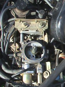

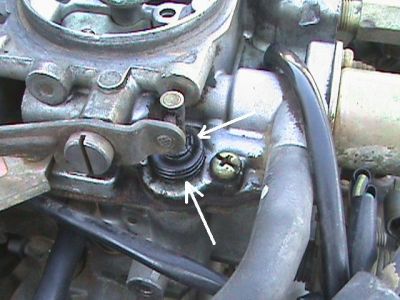

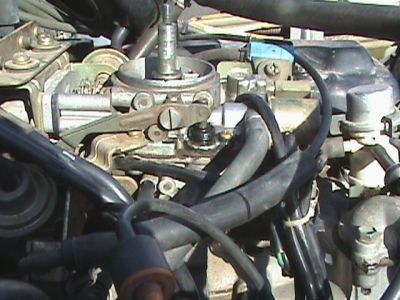

As far as the carb being rebuilt...not quite sure, I fixed the choke problem I believe. The following are new pics of the carb, cold, and hasn't been started since yesterday. The choke is closed finally. Before I fixed the linkage it was always open. I did notice something on the carb as I was taking pictures. You'll notice in the first pic, I marked the rubber valve/plunger thing, if you look at the top arrow, you'll notice it is pointing at the very top of the plunger. It seems to be very brittle and torn/cracked. It seems to be leaking, and the plunger itself is wet on the outside, as well as on the carb body. I'm thinking I have just found my problem, but would like to be sure this might have anything to do with running rich or excessive fuel consumption. Thanks again for all your help. But then again, if this seal is broken,wouldn't this cause less fuel getting to the carb?

That is the accelerator pump and that rubber boot is the just that a boot to keep dust and dirt out not fuel in. I would say that this is not going to cause it to fail smog. Now does it look like you can adjust the fuel mixture on it? If so then I would have it smoged then have them adjust it and resmog it. See they can adjust it as they look at the exhaust output and dial it in for you so it will pass. I still think that the carb should be rebuilt if it has not been or if the fuel mixture can not be adjusted. Let me know what you can. Thanks
