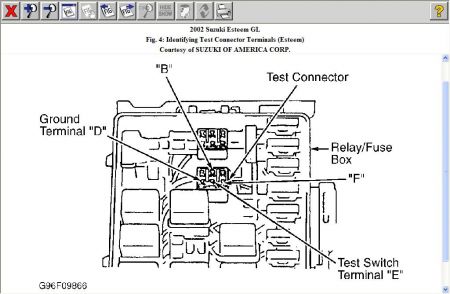

Hi canbyte, Ignition coils, fuel pump and heat related sensors can and do give way when heated up. One thing that just came to mind is the charging rate. If the alternator is not producing sufficient charge, the engine would bog down. I have seen cases of charging rate dropping drastically after running for a few minutes due to a bad crankshaft pulley. Get a voltmeter to test the charging rate. The ignition timing is adjustable for 1.8L and if you have a timing light, try hooking it over the wire connectors to the ignition coil, some timing light works this way. However you need to connect jumper wire between test switch connector terminals "D" and "E".
https://images.2carpros.com/forum/automotive_pictures/192750_DLC02Esteem_1.jpg
EFI of the newer versions do not have any vacumn advances, they are ECM controlled. You are right about the dignostic scanner needing 2 people to have on road test but if they can't find the problem, that is what they should be doing. If a shop is not willing to go and try to find the cause of a problem, how can they improve on experience? Let me know what you find out and about the alternator and ignition timing and we will continue from there.

For the ignition timing, the specs should be 4 to 6 degrees with jumper installed between terminals "D" and "E" of test conneector.
With scanner it should be set to Fixed Spark Mode.
