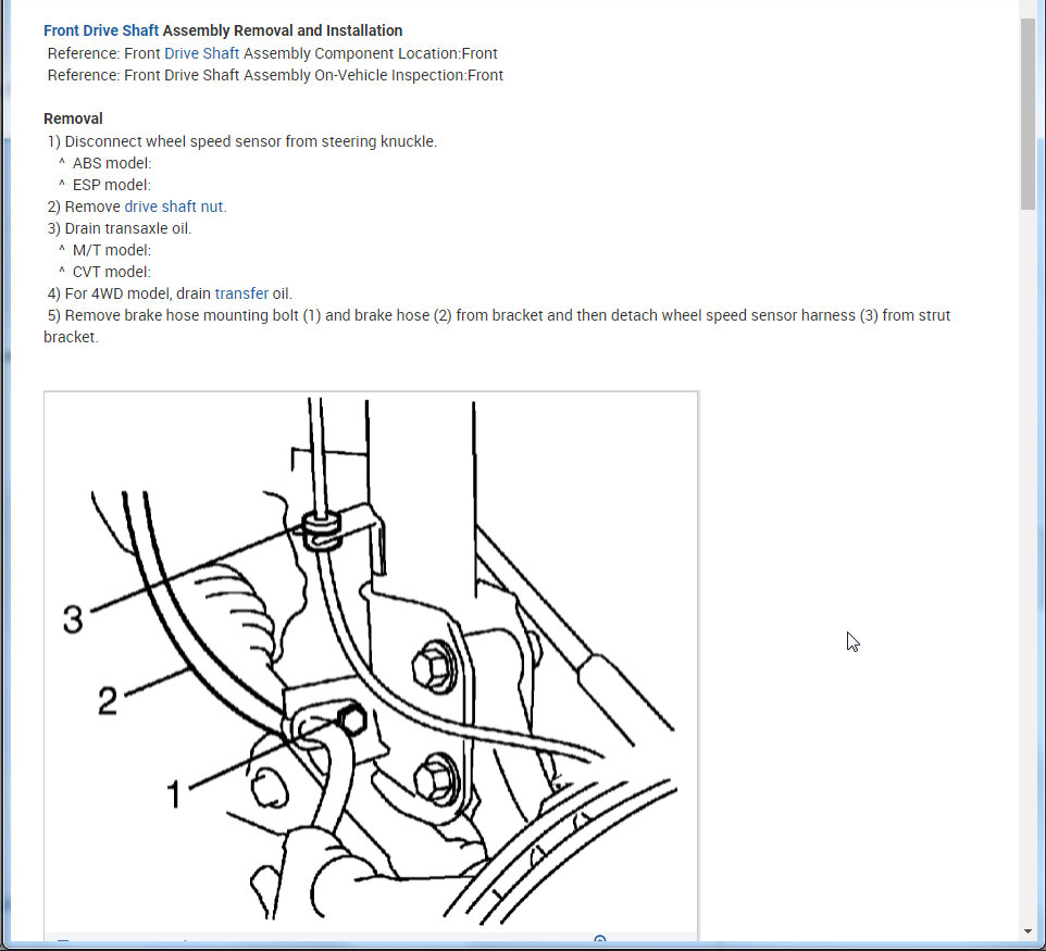

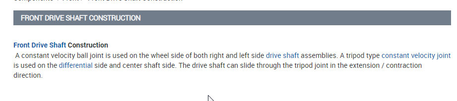

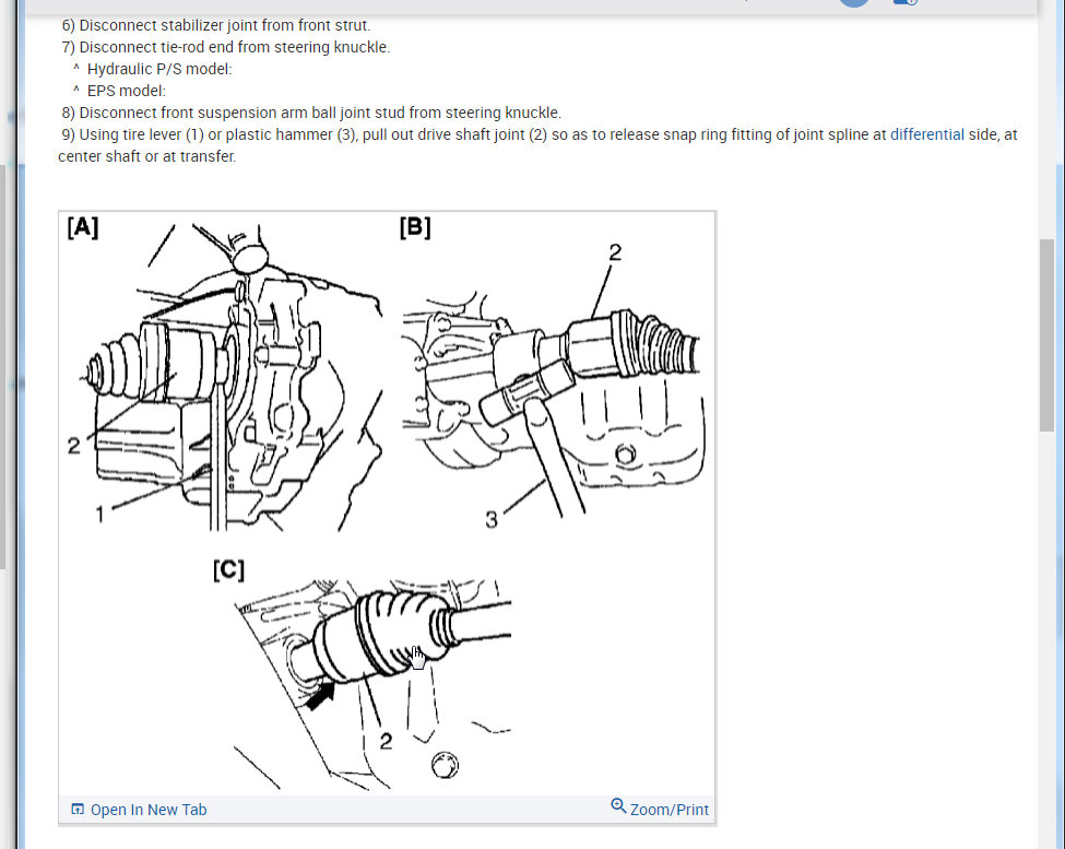

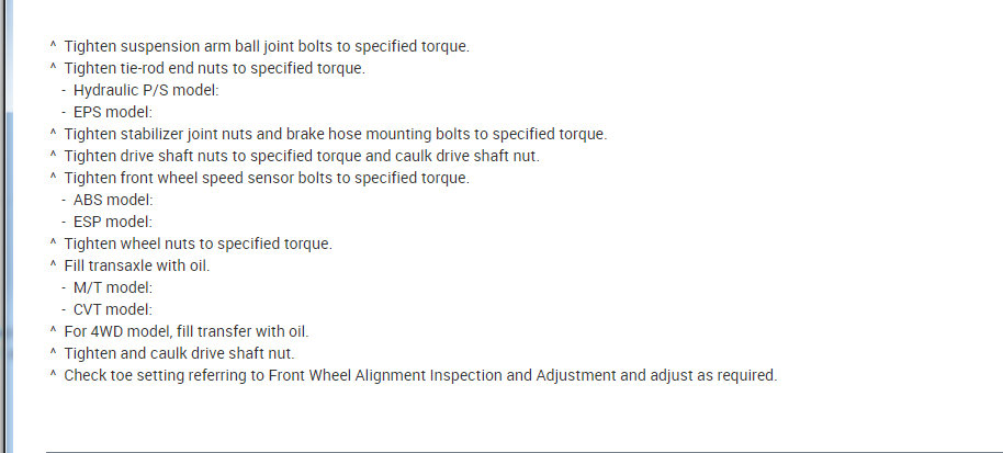

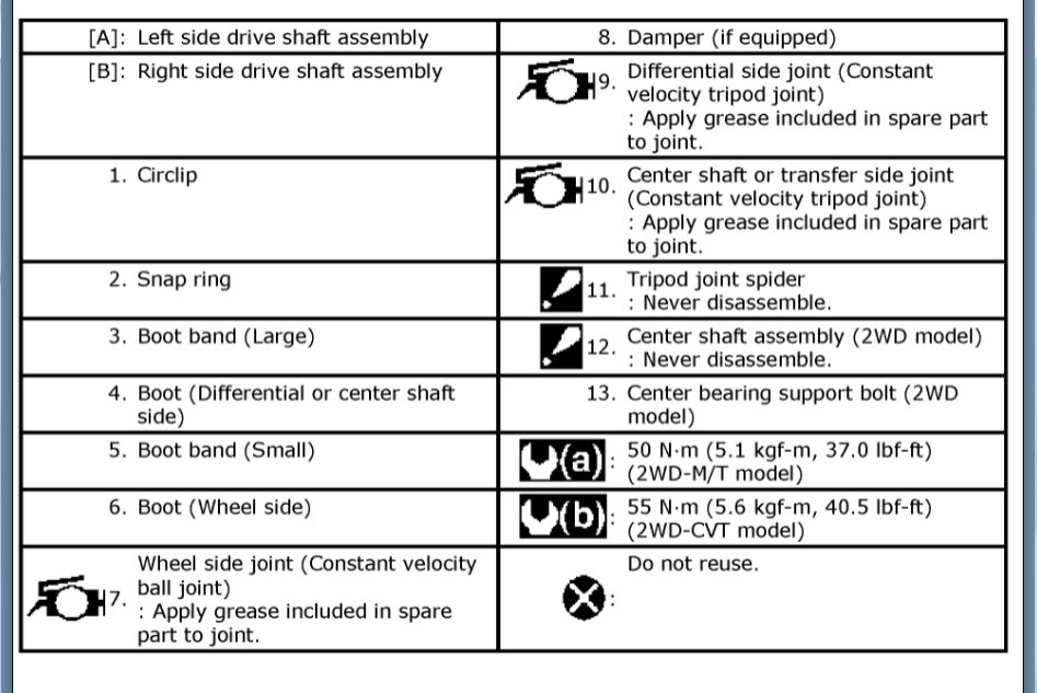

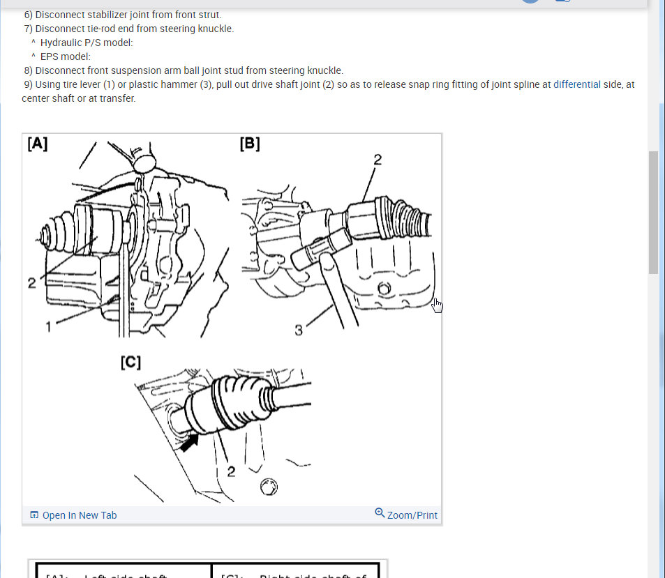

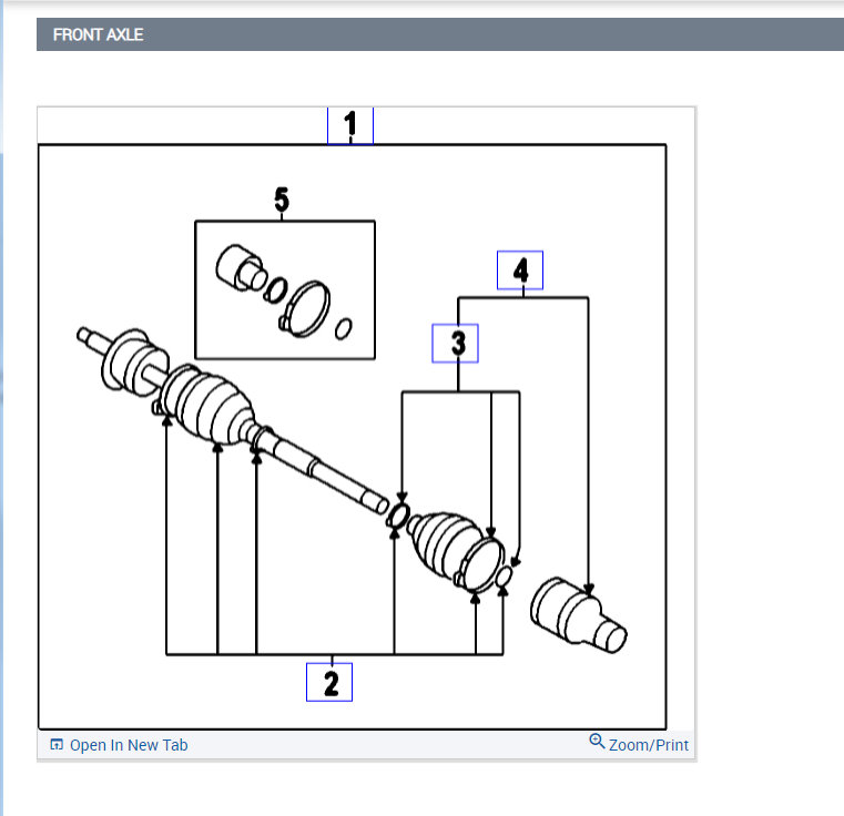

Drive shaft joint constant velocity boot severely deteriorated nearside front inner on a car.
Apr 28, 2021 at 11:43 PM

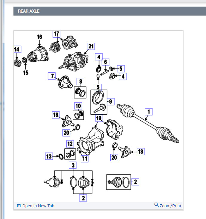

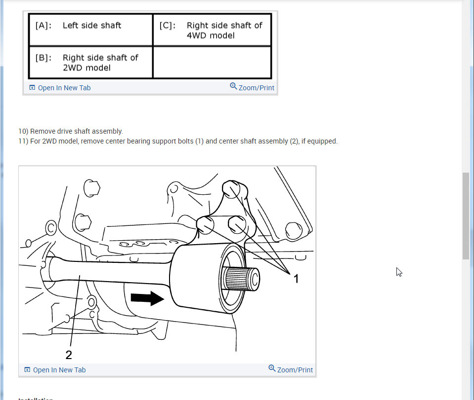

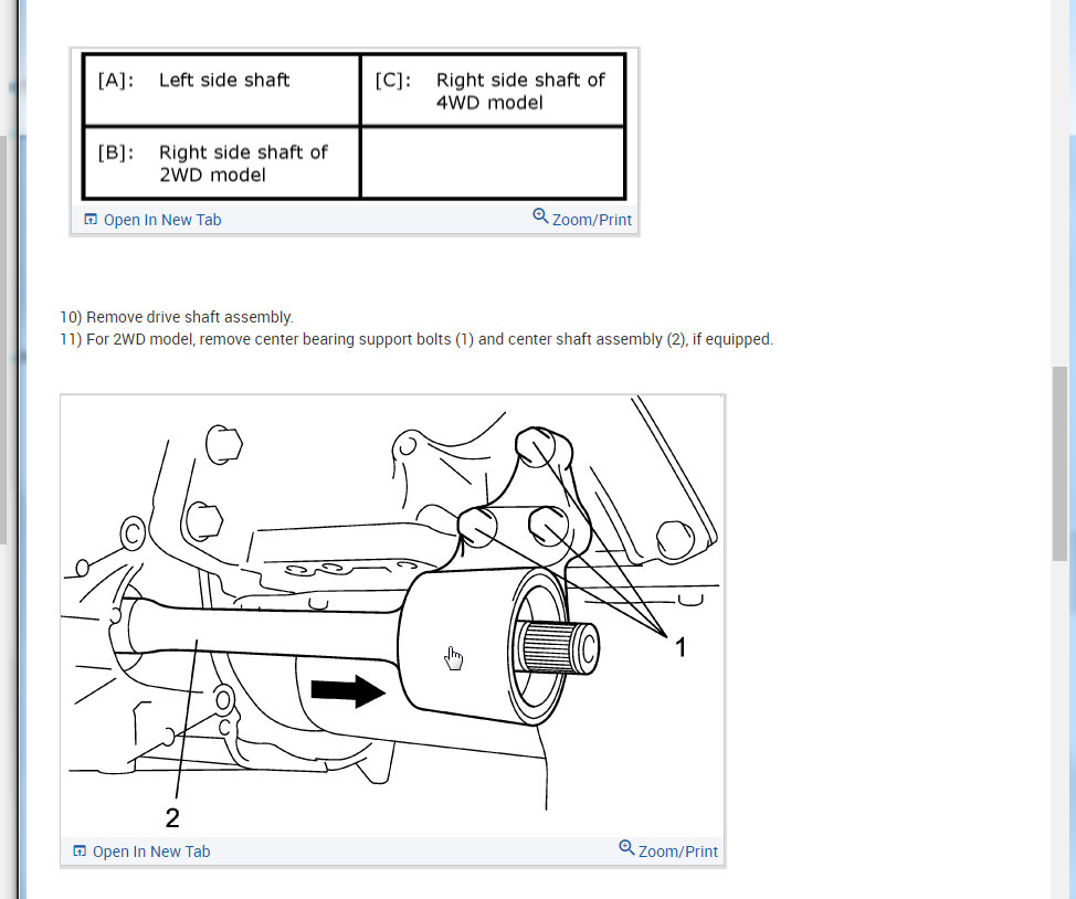

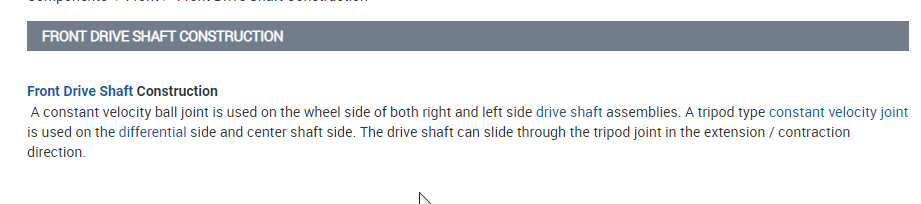

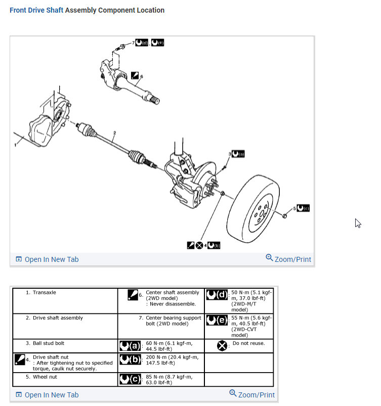

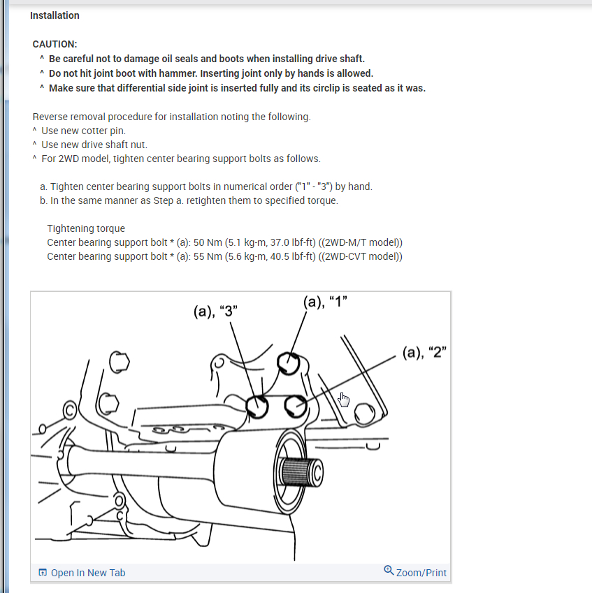

Unfortunately we don't have a manual on this vehicle as it is not offered here in the USA. However, here are a number of guides that will help with this repair.
https://www.2carpros.com/articles/how-to-replace-a-cv-axle-bearing
https://www.2carpros.com/articles/how-a-cv-joint-works
https://www.2carpros.com/articles/replace-cv-axle
Below you will find the info from a like vehicle is offered in the USA and it should be very similar.
Please run through this material and hopefully it gets you the info that you need. Thanks

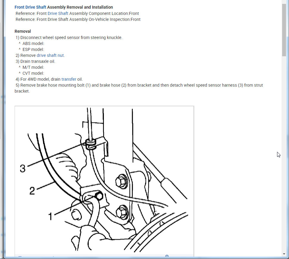

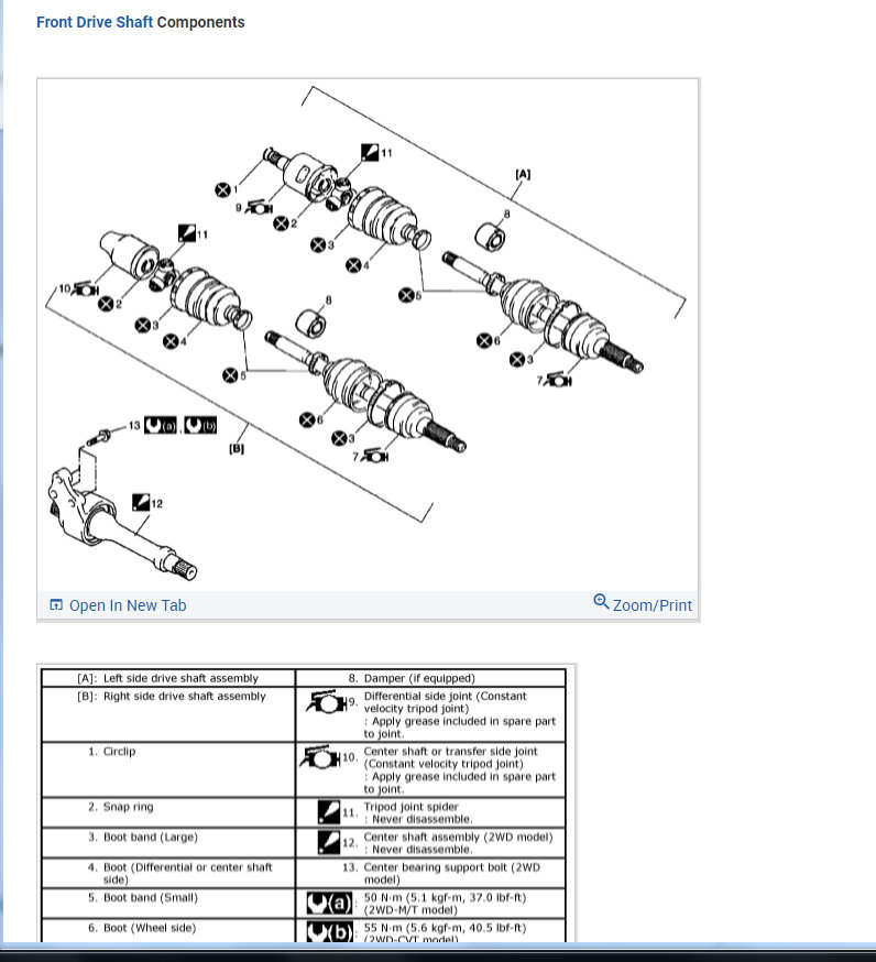

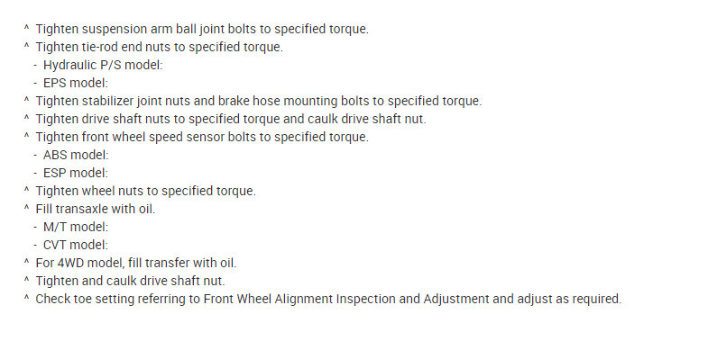

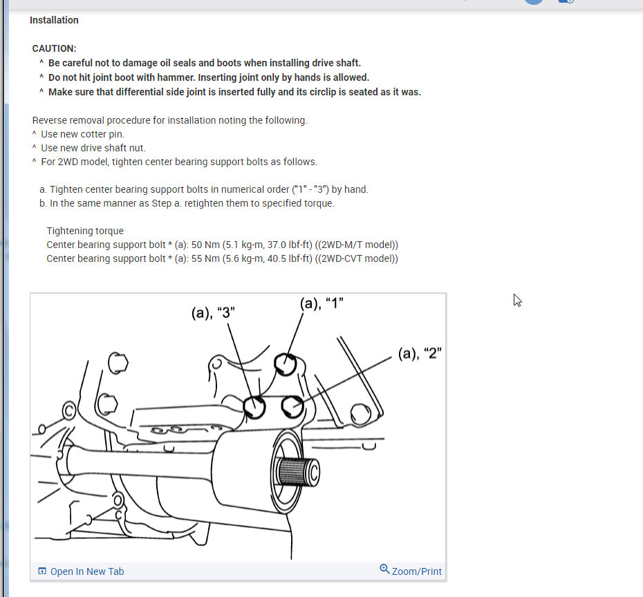

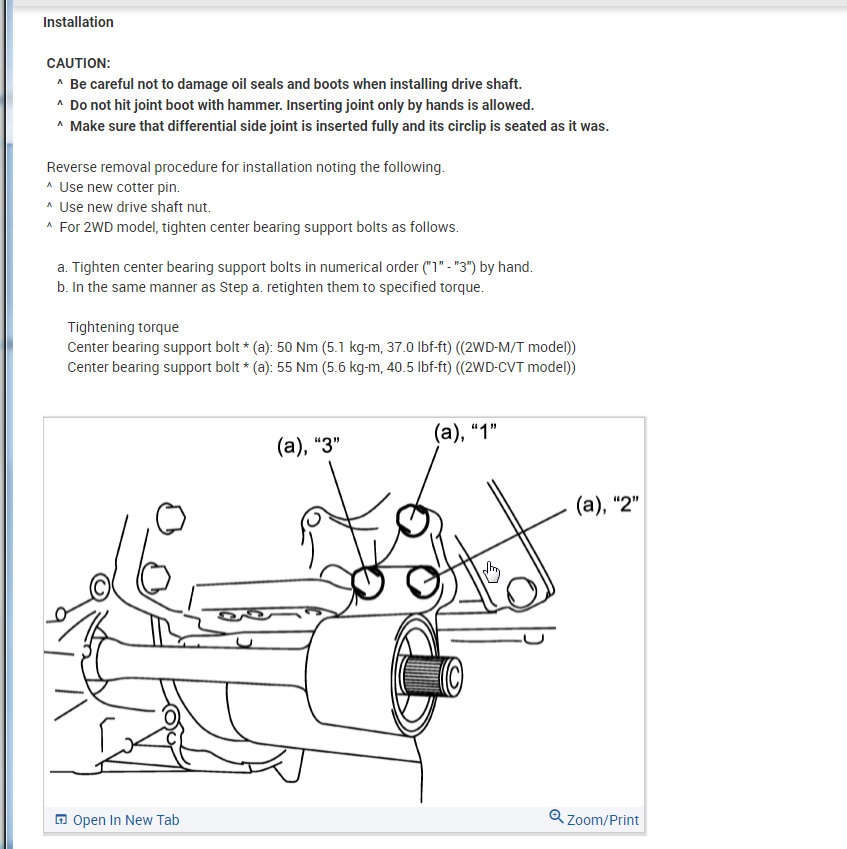

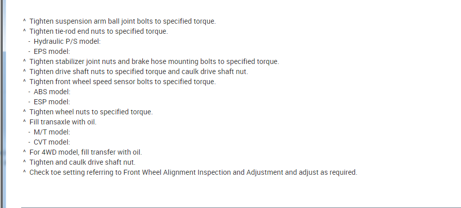

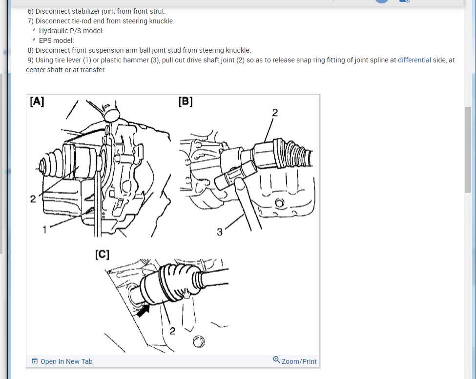

I assume you are talking about the front CV axle. Here are some guides that will help with this:
Below you will find the process from a like vehicle that is offered here in the USA. Unfortunately we don't have a manual on this vehicle so this process will be pretty close to what your vehicle has.
Let us know if you have other questions. Thanks
