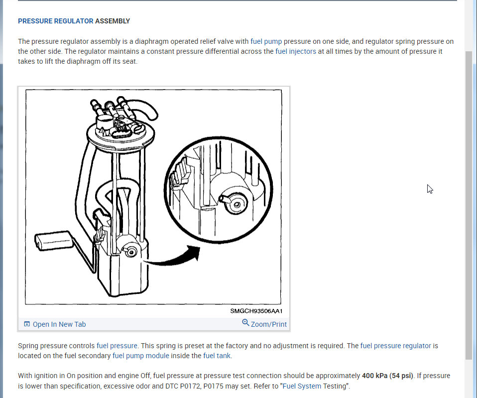

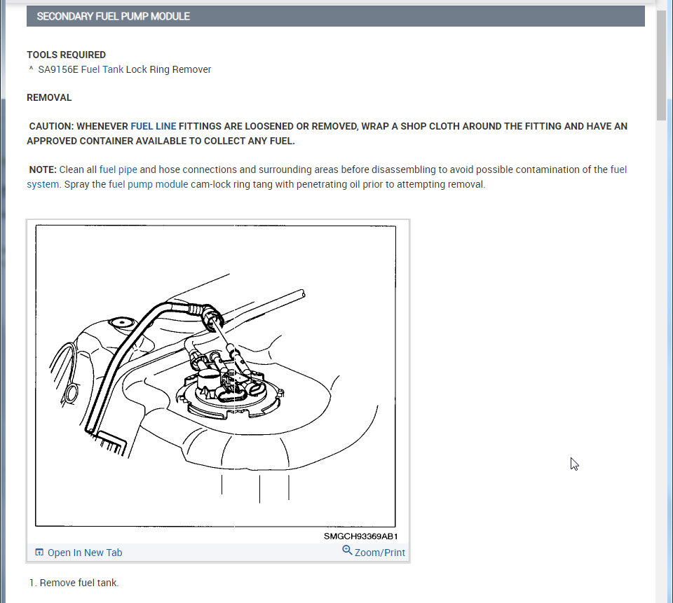

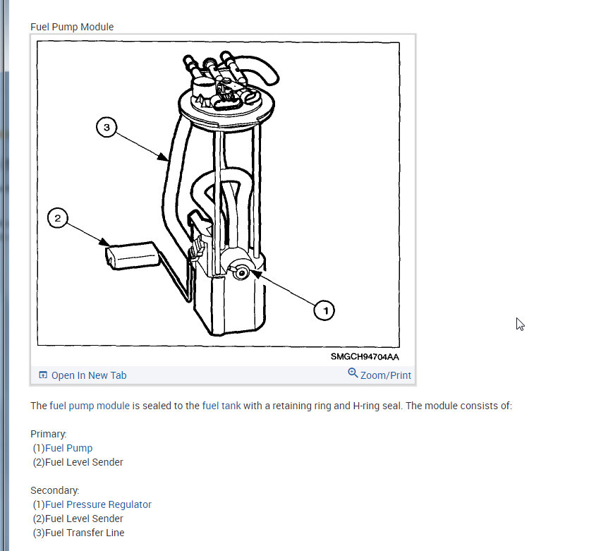

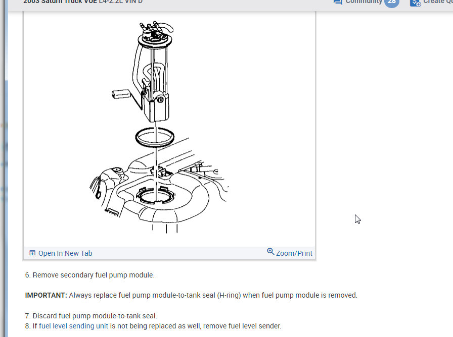

That is great information. That is exactly what we needed. I do still think the pump is the issue but it is the regulator that is part of the pump and responsible for maintaining even pressure across the injectors and keeping it from bleeding off.
I attached info on this specific component.
Feb 9, 2021 at 12:31 AM
MARIA STINSON
  • 8 POSTS

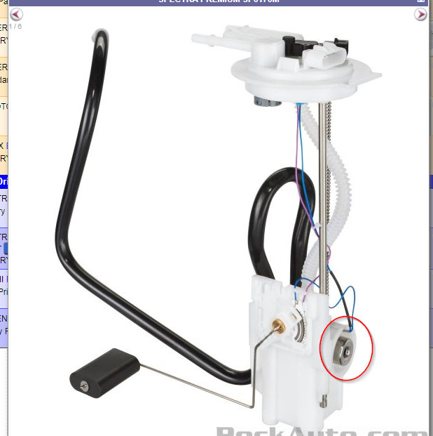

okay, sounds good. i noticed in the attached image it says it is on the secondary fuel pump module. does that mean it's on the fuel transfer pump or is it on the main/primary fuel pump?

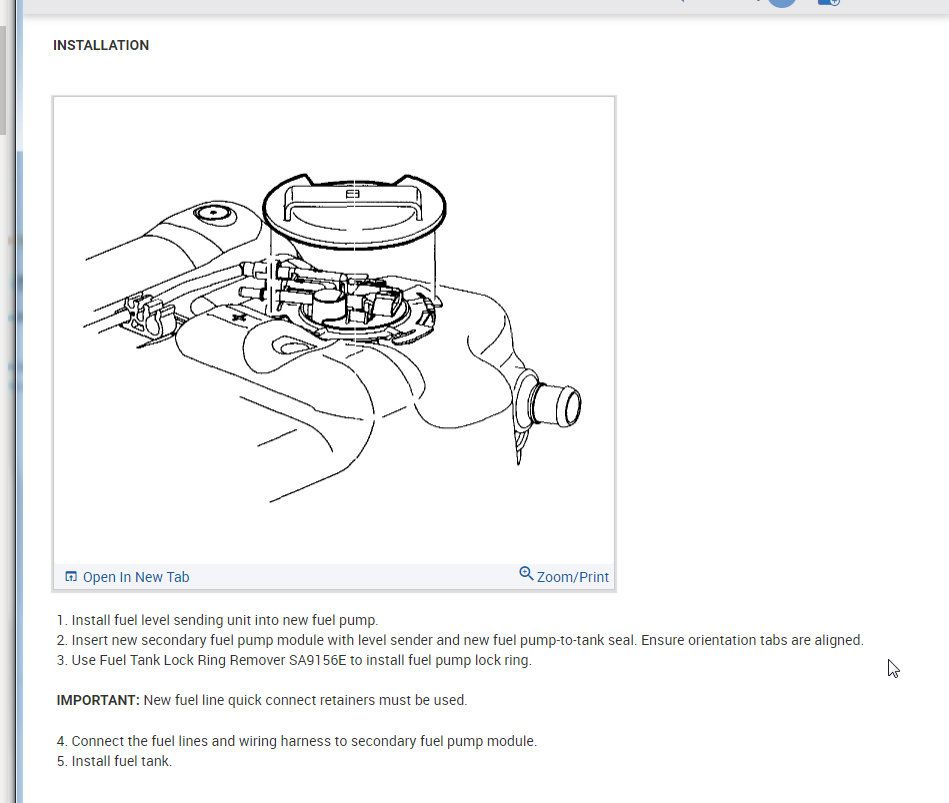

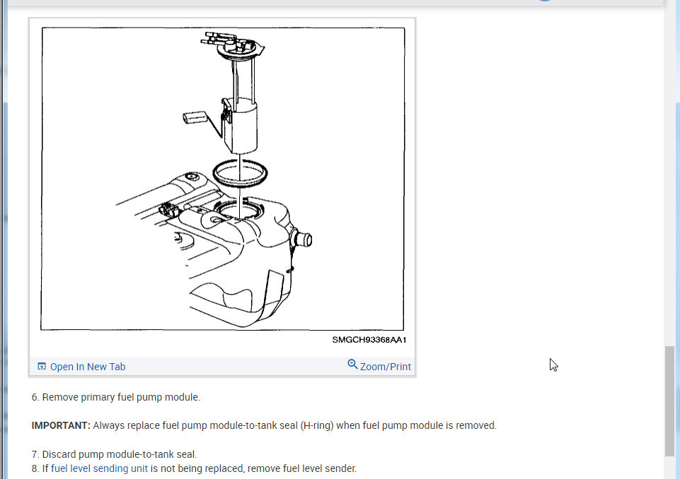

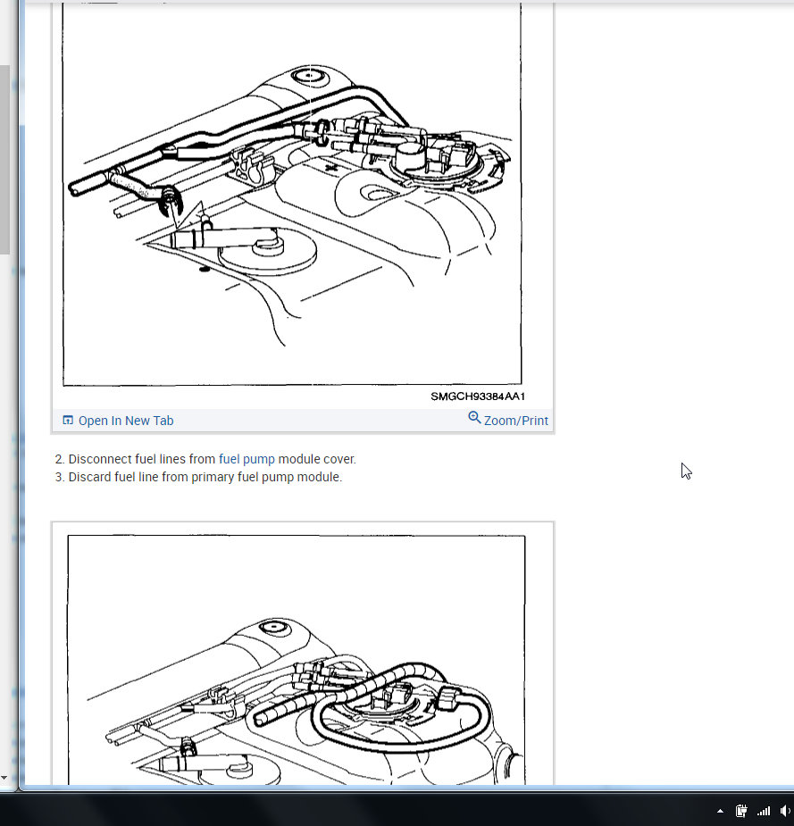

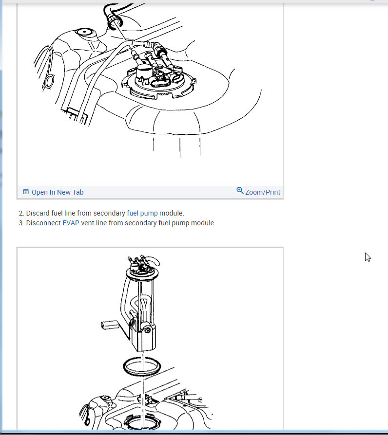

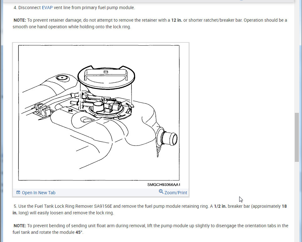

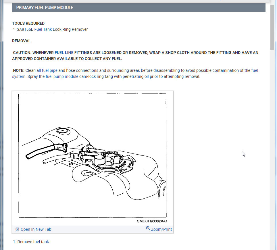

It is part of the main fuel pump. Saturn is weird. Take a look at the last 2 attachments. It shows the module which consists of a primary and secondary side.
Basically it is just needs a fuel pump that is in the tank.
