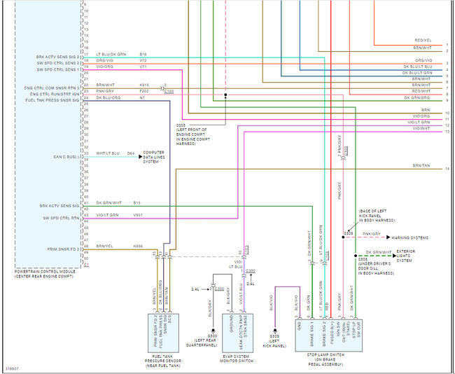

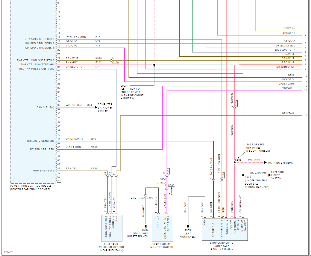

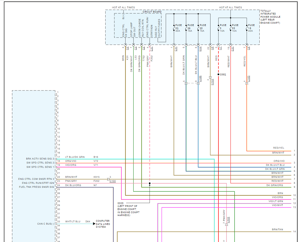

On the Po572 -
What voltage to expect coming in to and out of the Brake Light switch.
The brake lights worked prior to all of this.
The brake lights worked just before I went to pickup and install a new switch.
And I certainly will check to see if the brake lights work again - tomorrow.

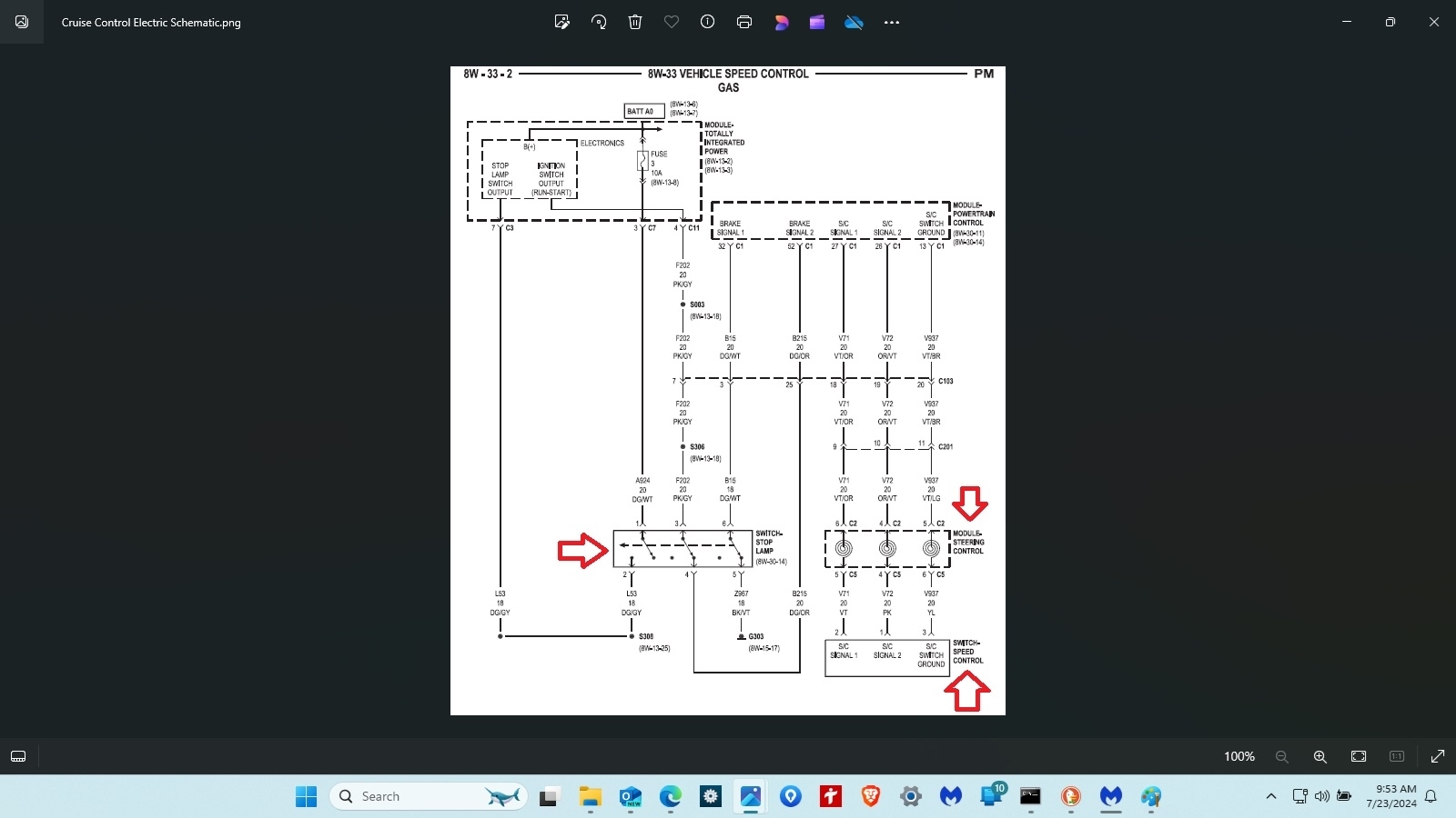

But the reading I have done - tells me that the brake switch also sends power
to disengage the cruise control - and the electric controlled torque converter.
So - doing a terminal to terminal voltage check and resistance check back to ground
likely would be a starting point there. I do not have that schematic - nor know the location of the cruise control module or it's grounds. But doing a pin by pin - I know to do - I simply do not have the values and terminal points to go directly to - as a plan of action.
If the brake lights work - and they did.
I have no reason to not believe that they will again tomorrow morning.
Then this reply is what I see all over the place -
"DTC P0572 stands for "Brake Switch 'A' Circuit Low.". This code is logged when the brake switch's circuit "A" shows signs of low voltage. This may be set due to brake switch failure, a faulty PCM, or wiring issues. Common symptoms to watch for include brake lights that won't turn on and cruise control."
So -If the brake lights function -
Am I expecting fused B+ power to come down to the switch and go through the switch
for output to the brake light bulbs and in companion send a circuit signal to the cruise control unit to disengage cruise - or is it some different current flow.

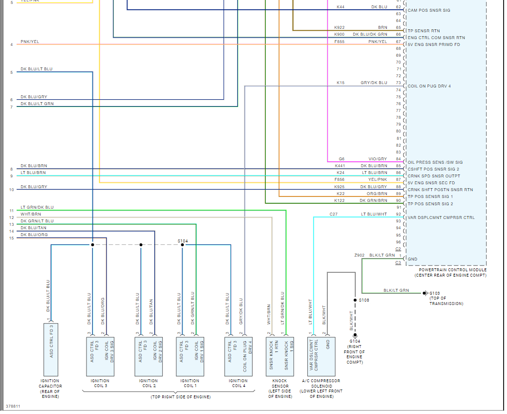

I found this page.
That shows the timing marks on the serp belt pulley and the pointer on the cover.
And the camshaft timing marks.
https://www.jeeppatriot.com/threads/camshaft-timing.337673/?post_id=1868149&nested_view=1&sortby=oldest#post-1868149

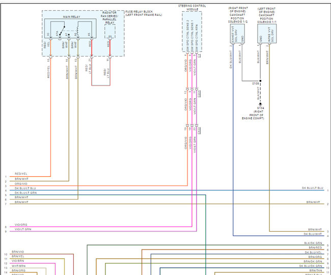

I found this page
That shows an electric schematic for the cruise control.
https://www.jeeppatriot.com/threads/cruise-control-issue-could-anyone-help.343085/
So - I will keep looking, keep checking and looking to trace circuits.

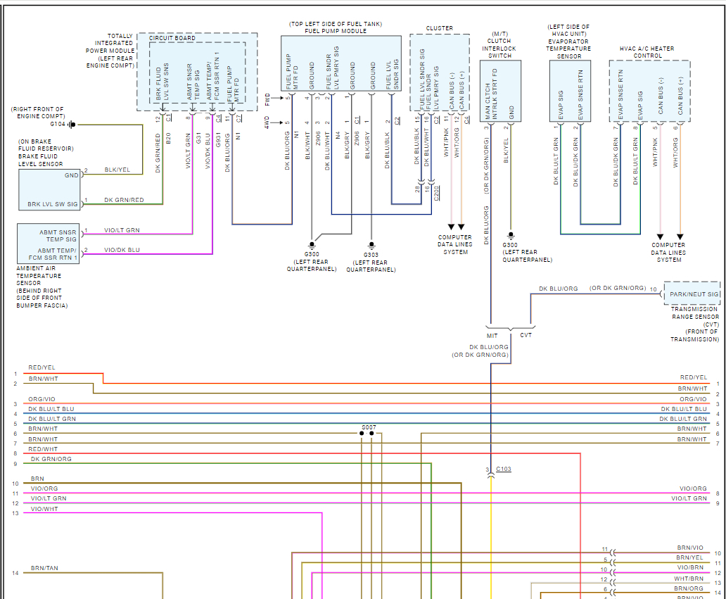

AS water was in the Control Unit mounted on the air filter housing -
And
Water would allow current to travel to the point of least resistance any where.
Replacing the Control unit has allowed the engine to start and run.
As now - There is a chronic error code with the brake light switch circuit.
P0572

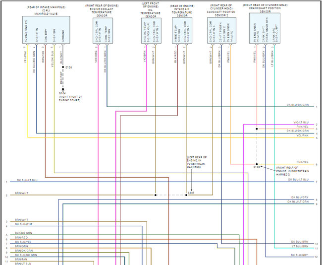

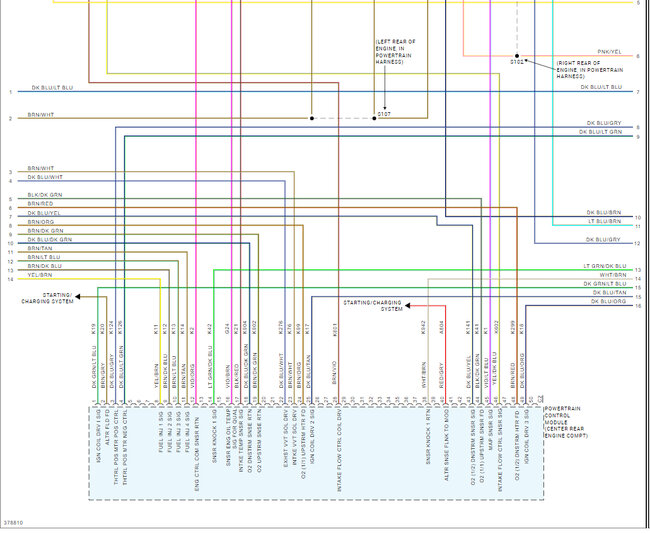

I have reached the point - where I need to identify the wiring configuration
in C1 and C2 of the 2 bulk wire connectors on this control unit.
And
The Integrated power module - which is the lower half of the fuse / power distribution
in the left side of the engine bay.
And -
Do further mind tracing of how -
That the Cruise control fault code could be hard set -
Not to be removed from the memory bank.

Post #9 on this page - shows the lower end of C1 and C2 attaching to
The lower side of the fuse panel / power distribution hub mounted in the
left front fender well - in front of the battery.
https://www.jeeppatriot.com/threads/wiring-harness-connector-and-component-location-diagrams.342288/

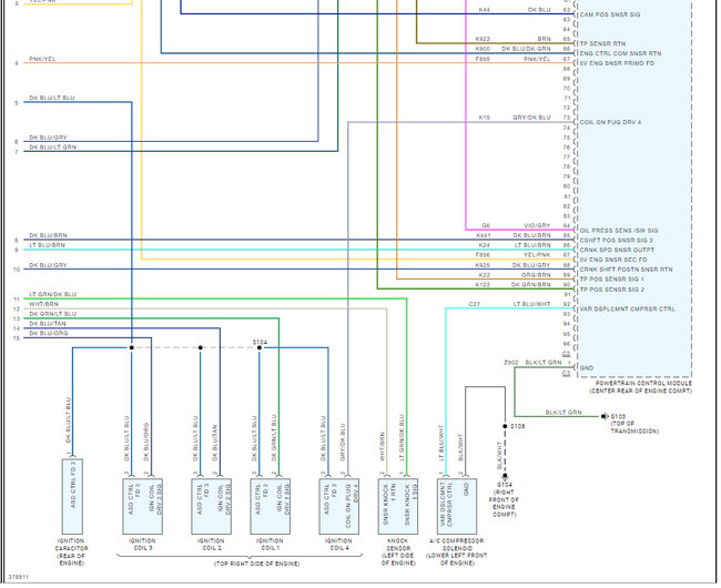

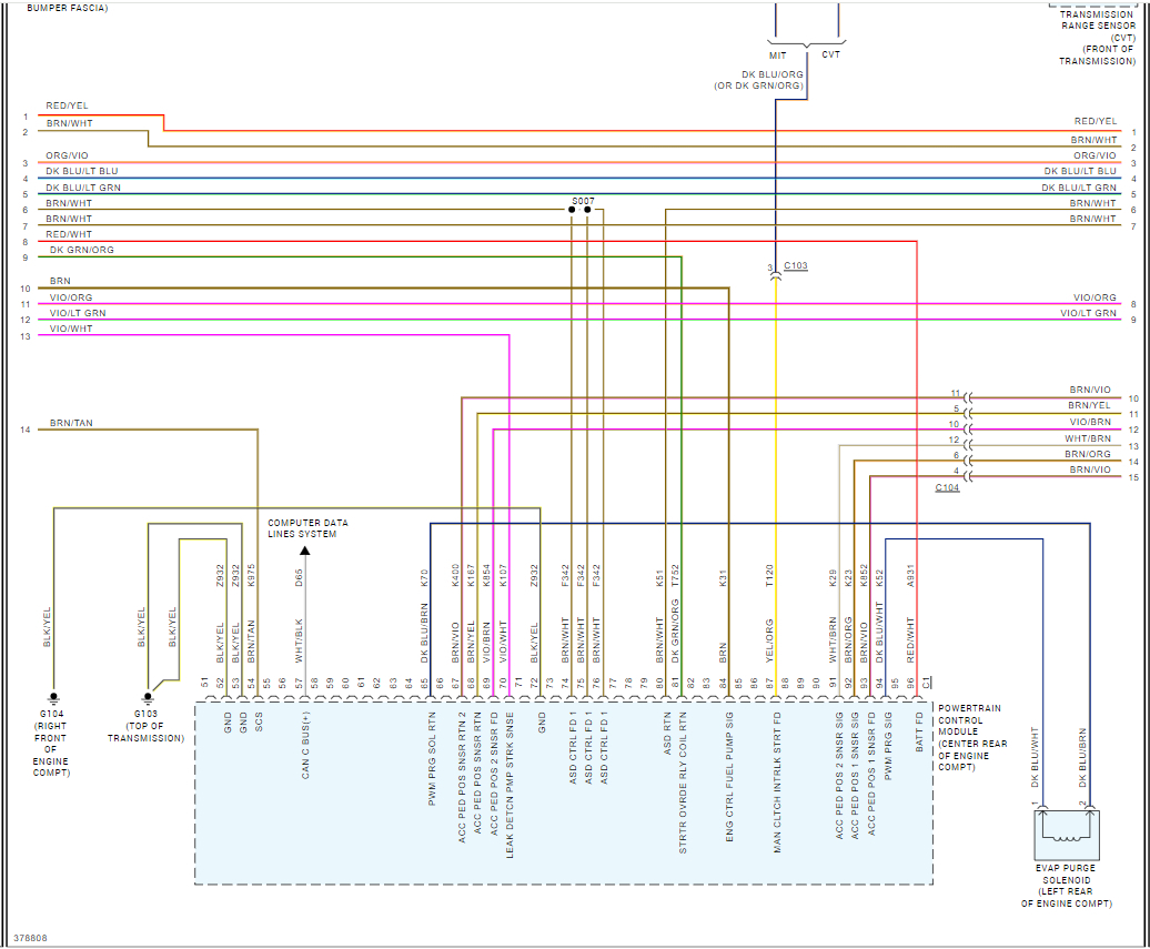

So, I put out a help request to the PCM supplier this morning -
Asking if they could identify which of the 2 bulk wire connecters
are P1 - and if they could also show the location of the pins as they
are numbered and colored - in 2 columns.
If the signals are there to the correct pin locations for inputs -
Then I would suspicion that the electronic portion of the "Totally integrated Power Module" a section of the fuse panel - power distribution became burned out when I attempted to start this engine - with water in the PCM wells - P1 and P2.
Jul 23, 2024 at 7:52 AM

I will attempt to find the wiring configuration and
perform a current path set of tests to and from the brake light switch
to and from the PCM - Including a voltage drop test for the ground on pin 13.

You have done a lot of work, do the people at Itan give you wiring diagrams, it seems like that is the place to go for problems like this? Does anyone at Itan help you? If not here is a guide to help you with the testing and I have included the engine and PCM wiring diagrams so you can do some testing.
I can also tell you I have seen a problem with the TIPM in these cars that can create strange problems. Check out the images (below). Let us know how it goes.

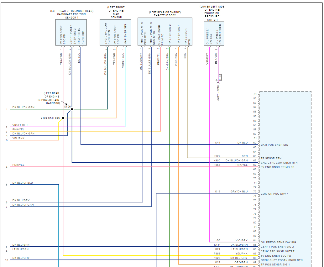

Since this morning -
Armed with schematic -
I identified one of the power wires that was supposed to be B+ hot at all times -
And it was not so.
I did what I needed to put a fused B+ on that wire -
And it brought about
permanent fault codes for the MAP, TPS and CTS sensors.
AI suggests that these 3 sensors have a 5v voltage signal being sent out to the 3.
I don't know if -
AI is talking out it's perverbial butt - based upon other search results or not.
But - I will study it as well as I have the heart - until my head of steam just goes flat.
I have ordered a replacement fuse box / power distribution -
And that is likely Friday or Monday.

I did not tell you - but since I powered up that green wire on the C - brake light switch circuit - the ABS has locked up the brakes. The vehicle will not go forward or backward - without a great deal of strain. So, I will detach the ABS wire from the module and see if the wheels are now free.
