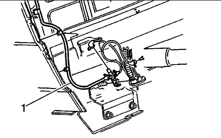

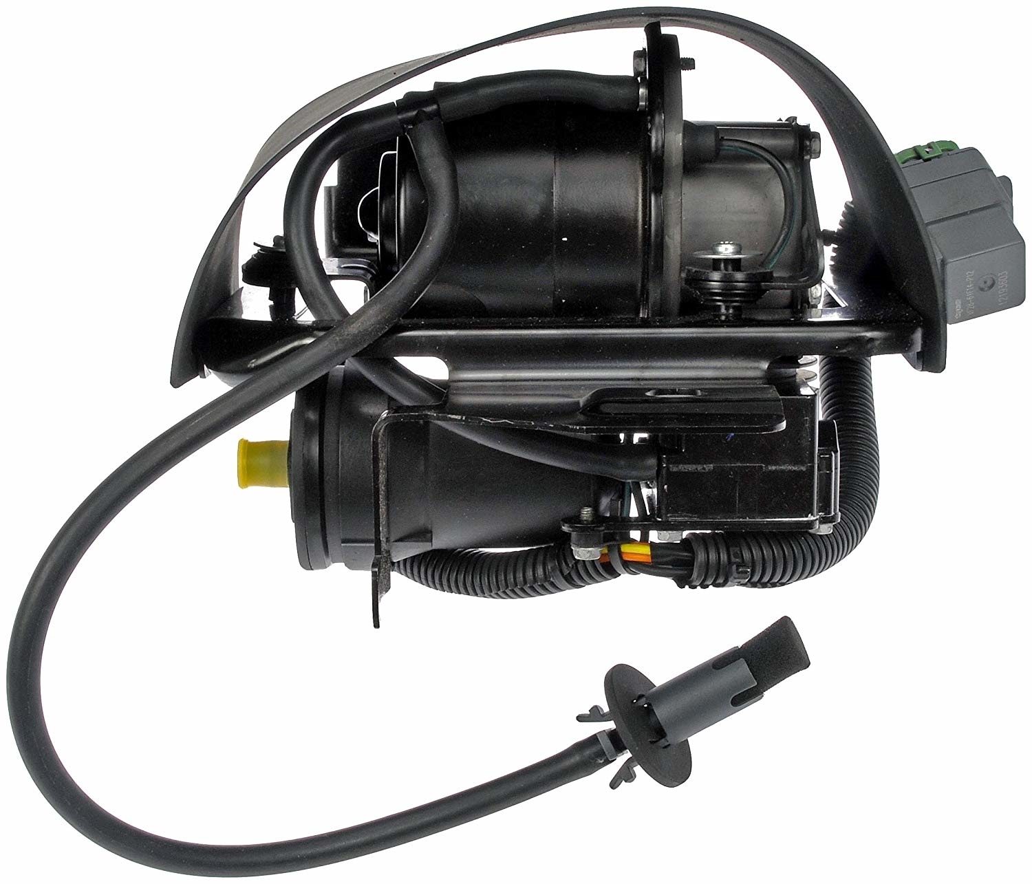

The air hoses on the rear suspension air compressor were all broken off and missing. I cannot find the connection for the long hose that comes out of the compressor. Can anyone provide picture of where the long hose connects to?
Sep 12, 2019 at 1:19 AM
Good afternoon,
I attached a picture for you to view. Is this what you are talking about?

No, do you see the long hose out the compressor on the picture I posted, the hose with the fitting at the end, I need to know where the hose connects.

That is the output hose that connects to the rear shocks.

Roy,
So apparently the long hose connection I was looking for does not have a place to connect to.
it is just a suctions hose and what it has at the end of the long hose is a piece of foam that works as an air filter.
But still thanks for your help Roy.
Sep 12, 2019 at 10:57 PM

Yes, it is working now and the "check the stability suspension" is not on anymore.
