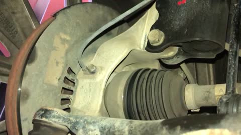

Thanks Joe, attached is the video.

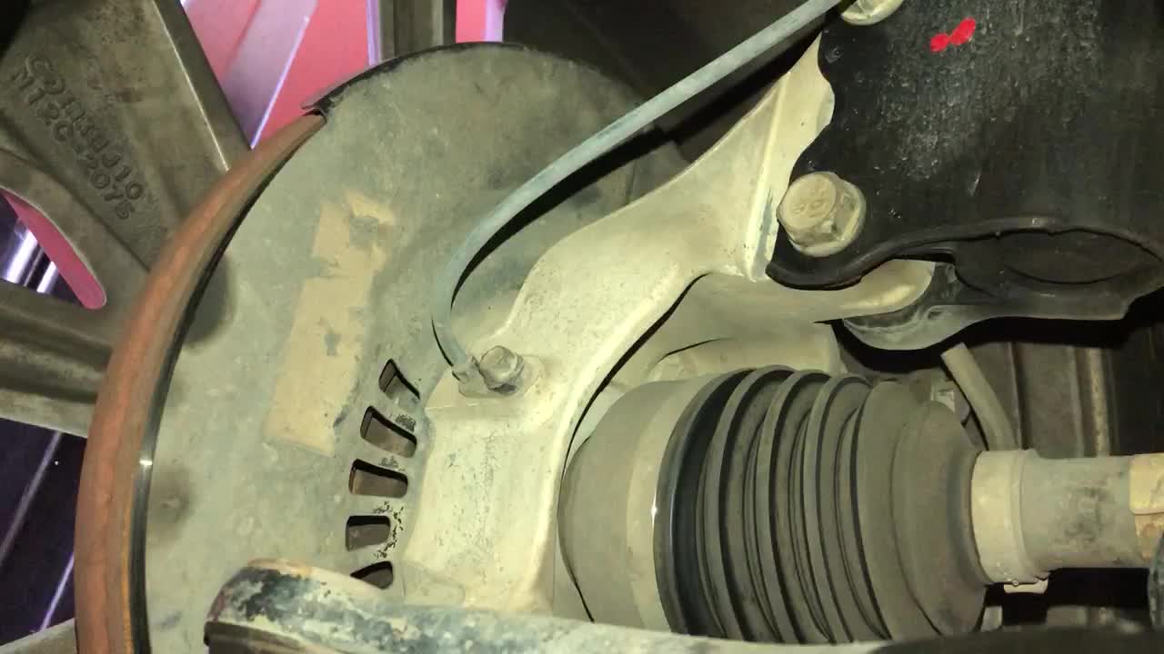

Do you think this could be the probable cause?

I did hear it. It sounds like something is loose. Keep in mind, I'm not there to hear it, but it sounds like a rattle. Your second video, is it the in and out movement you see in the axle you are concerned about? If that is the case, don't worry. They will move in and out a bit.
Considering all you have done on the front end, check to make sure there isn't a broken exhaust hanger or heat shield. I also have another question. Is this noise only evident when the vehicle is moving?
Also, when you hear the noise, does it stop or change when the brakes are applied?

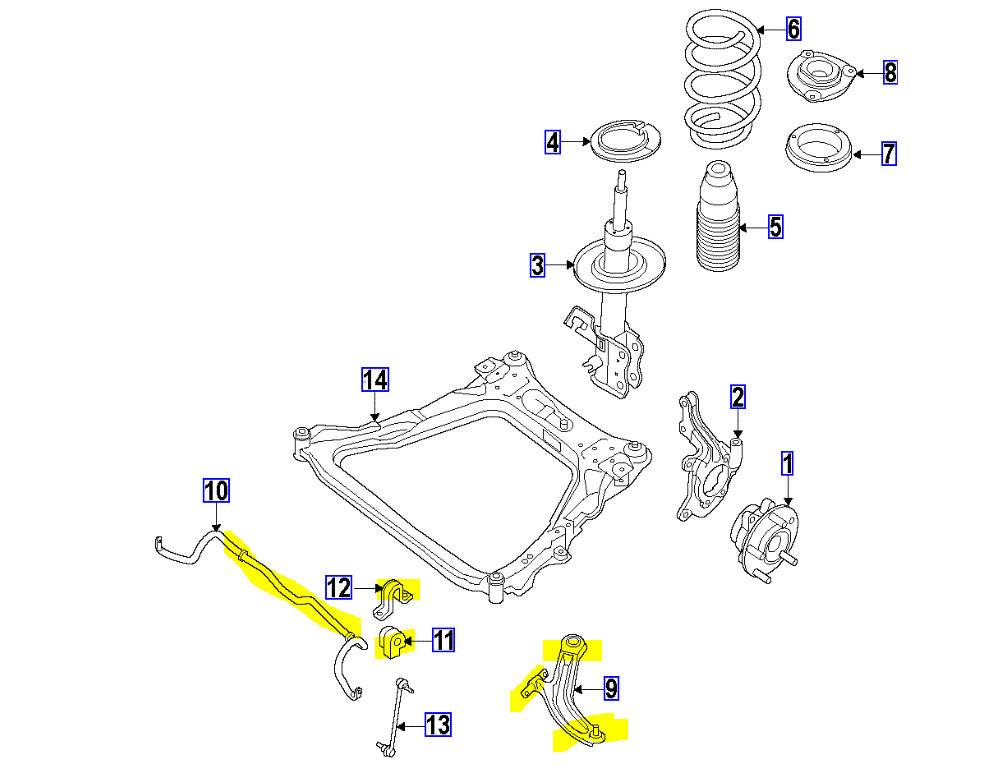

I would think a control arm bushing would not go away. That is what is confusing me. It wouldn't hurt to check suspension parts. If you look at the attached pic, I highlighted things to check for play and to confirm they are tight. I realize you had new parts installed, but perhaps something is loose.

Thanks again Joe! Whilst the mechanics that I take the car to have said nothing is loose, however continues to get baffled as to why the noise comes only the in the first few miles.
