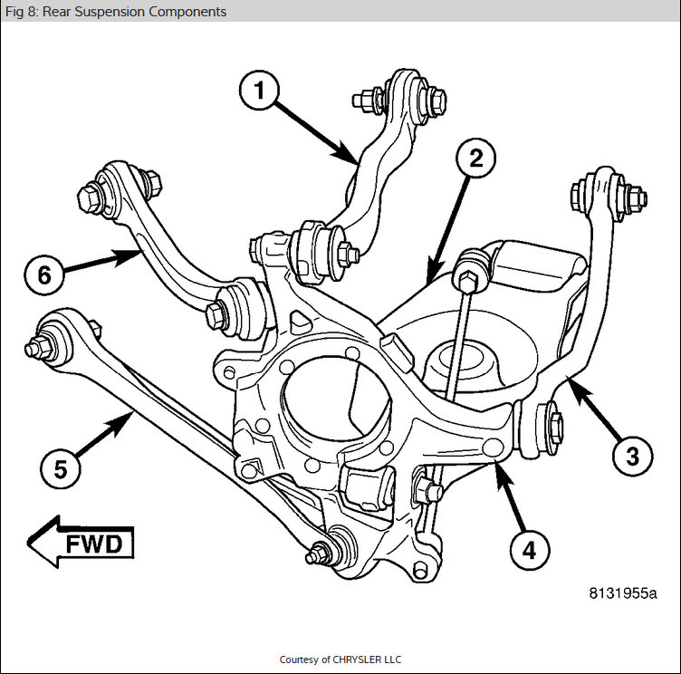

Replaced my rear upper and lower control arms. I could not replace the upper aft control arm because the manufacturer installed bolt head side next to gas tank, no way to get out without cutting bolt. I only replaced 3 arms. Now the rear end when I hit bumps on road and highway tends to wobble. Is there an adjustment that. Needs. To be done?

As I went through the options for your car I also found out there is RWD or AWD so I don't know which you have. Below is a diagram. If this is your suspension then there are no adjustments.
These are not commonly replaced parts, may I ask why you had to change them so I can get a better picture of what is going on?
