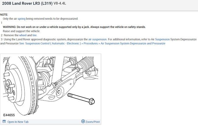

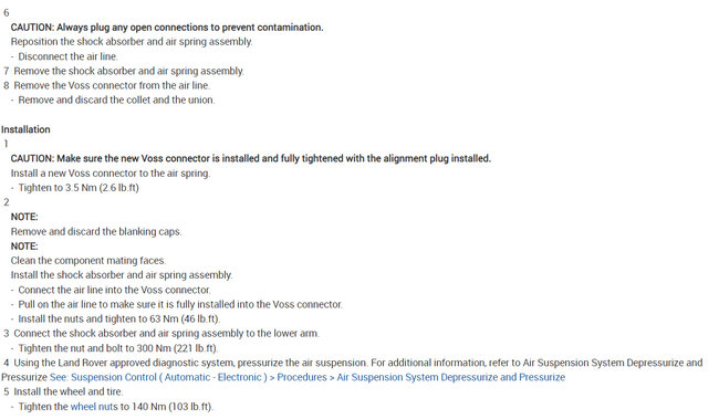

I hear a hissing sound from the front of my truck.
Aug 27, 2024 at 12:27 PM
  • 55,694 POSTS

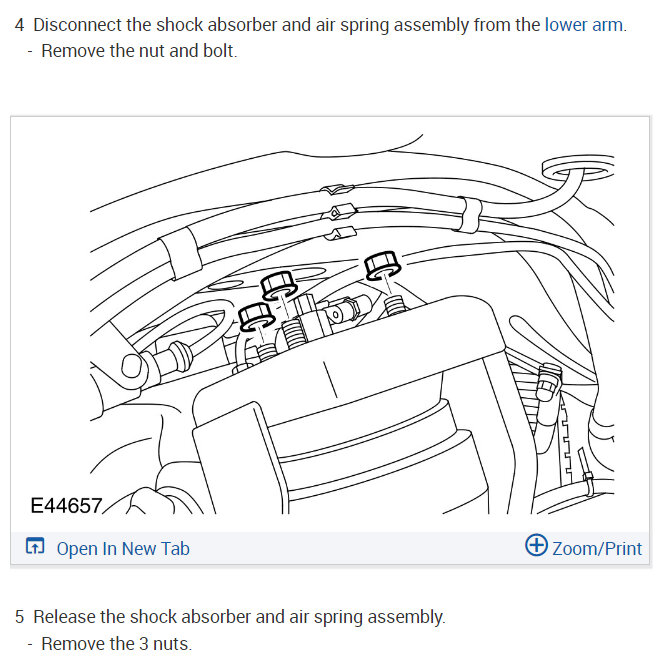

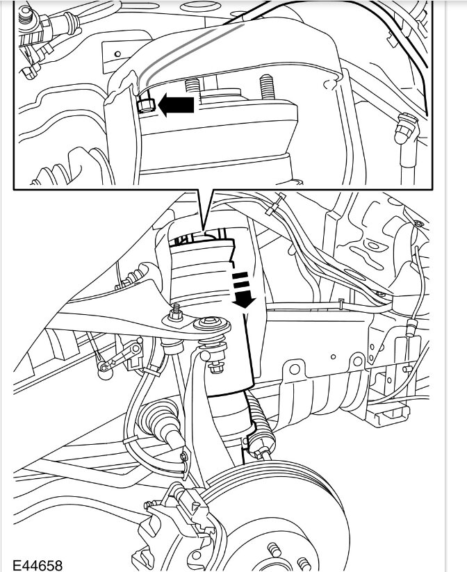

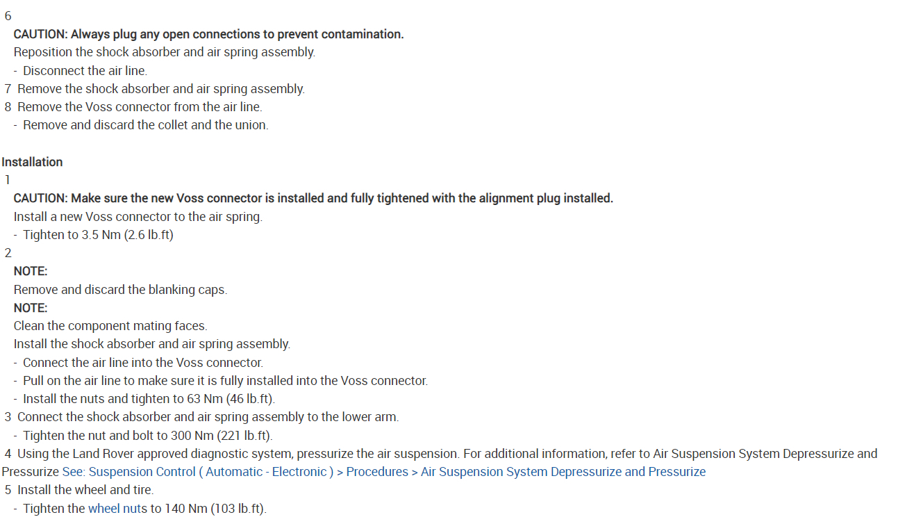

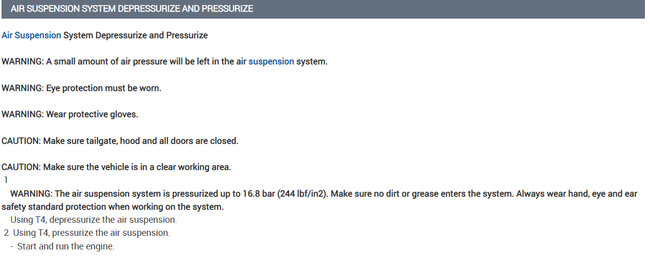

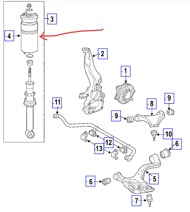

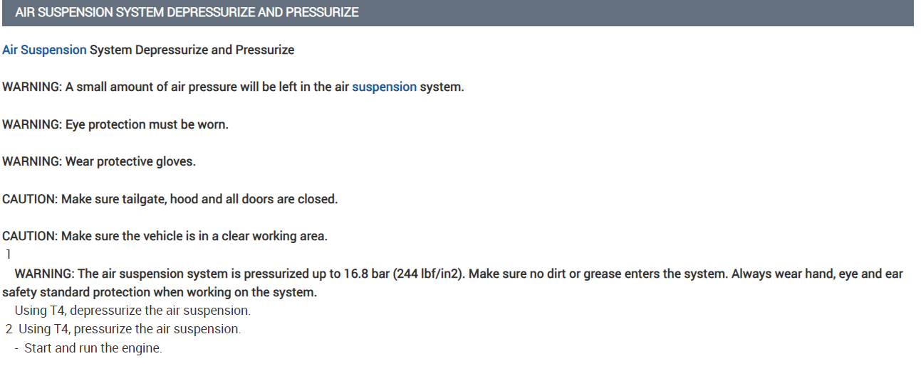

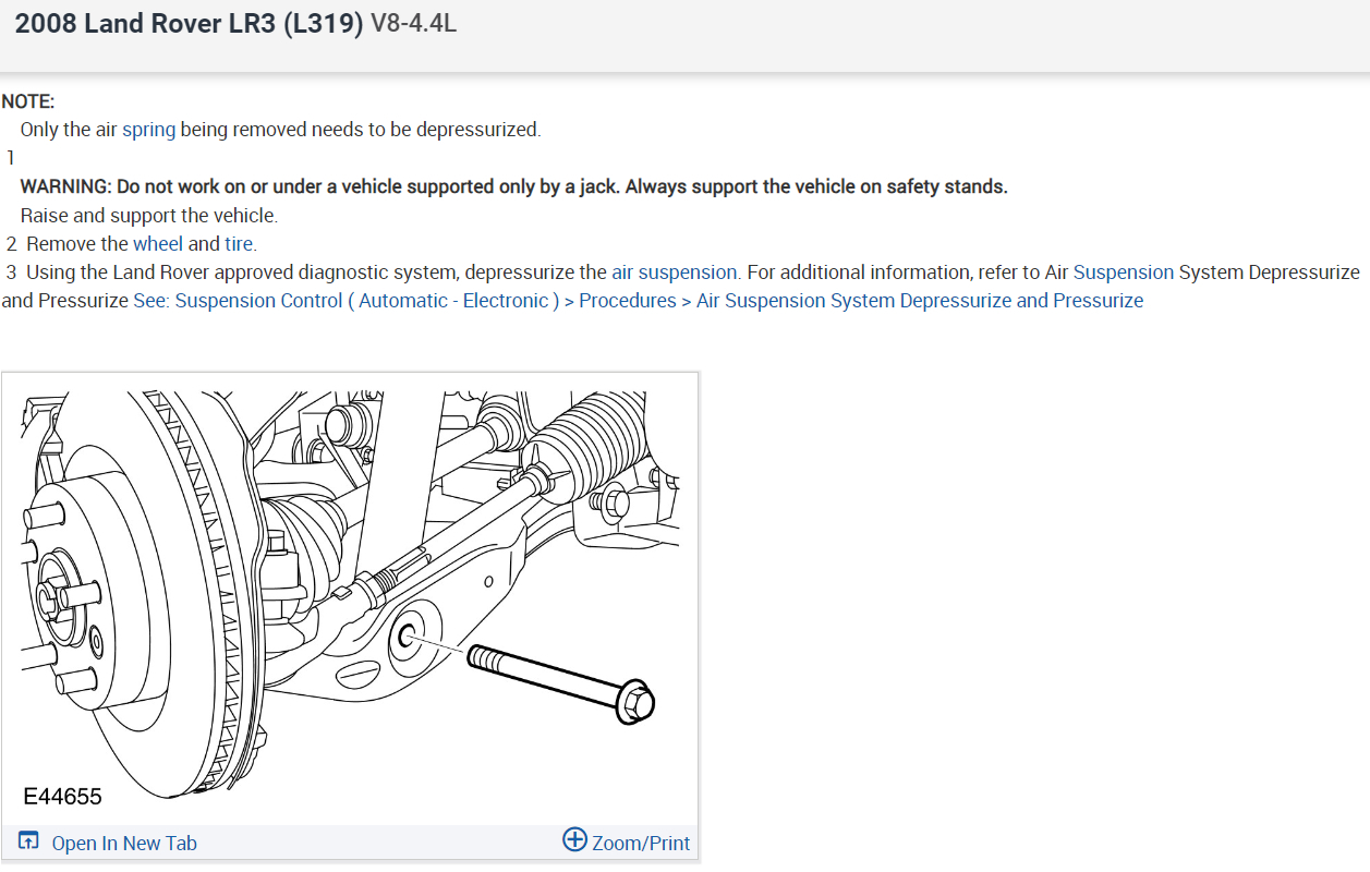

It is common for the air shock suspension to have a lean at the air shock itself, to confirm the leakage you can use a spray bottle of soapy water and spray it around the sock to see if there are bubbles confirming the failure, here are diagrams of the system and how to change the air shock out and depressurize the system. Check out the images (below). Please let us know what happens.
Aug 28, 2024 at 1:45 AM
PAGELHEATHER
Thank you so much. I'm wondering is it okay to drive it only a few short miles to my destination? It's hissing trying to rise up. (The front of the vehicle l)
Aug 28, 2024 at 1:59 AM
  • 55,694 POSTS
That is hard to say, it depends on how fast the leak is and if the front end is too low? Also, the compressor might time out and shut off FYI.
