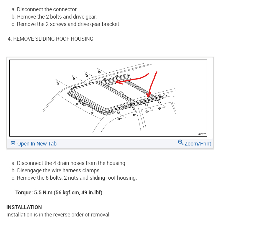

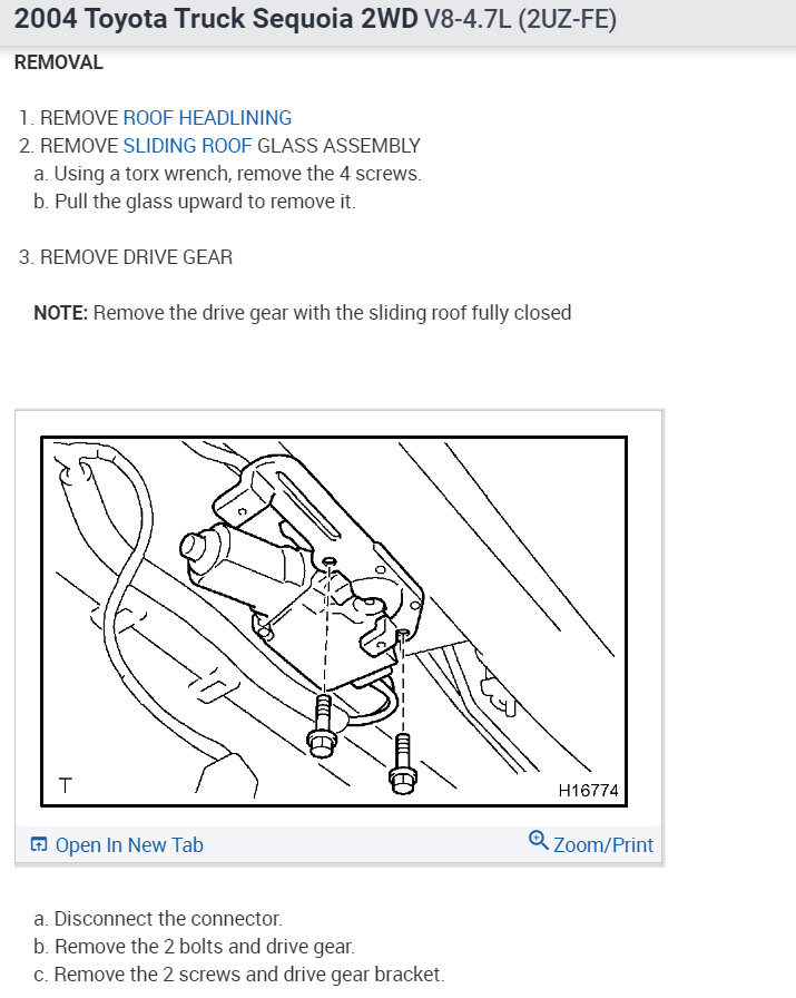

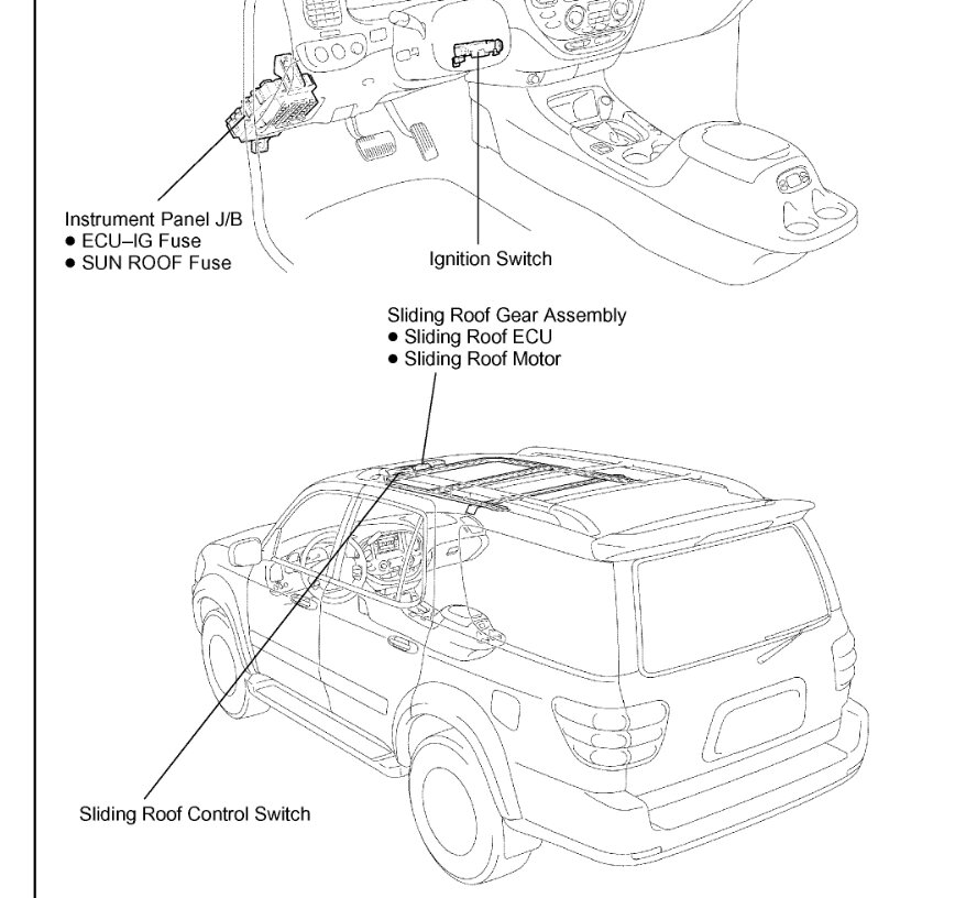

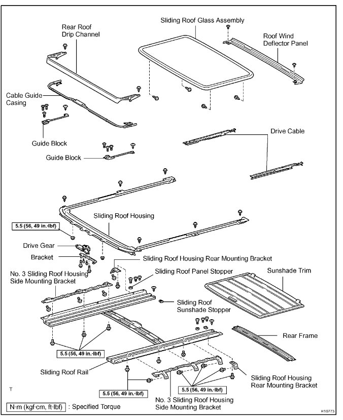

My sunroof motor works okay (I pulled it and operated it while disconnected from the regulator), but it won't actually move the sunroof when it's connected. It will try to move it when I push slide, but the gear only goes about 1/16 of a turn. Any tips would be greatly appreciated.
Jul 23, 2023 at 12:23 PM
  • 55,447 POSTS
So, the problem is the motor is weak or the slides needs to be serviced (WD40). Check out the images (below). Please let us know how it goes.
