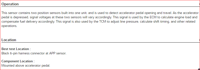

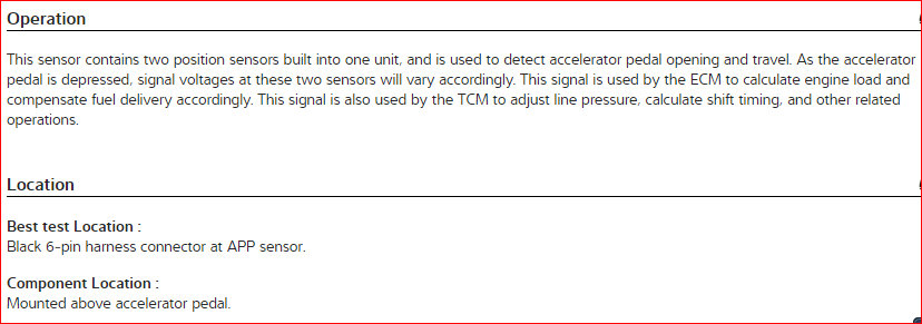

Sounds like you might be having a problem with the APP (Accelerator Pedal Position system). Most cars have a type of linkage connecting the accelerator pedal to the engine but yours is connected by an electrical system using the pedal as a potentiometer. It is also know as drive by wire. I have attached a picture that briefly explains its operation. I will do some more research and get back to you (maybe a dealer recall?). Hope this helps and feel free to ask any questions if needed. Thanks for using 2CarPros.

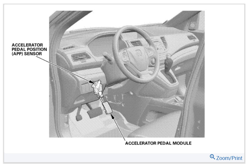

I have to agree with Danny L, when you hit the brakes it sounds like the sensor at the gas pedal is having a problem and giving a false signal to the computer to open the throttle. Here is the location of the sensor.
