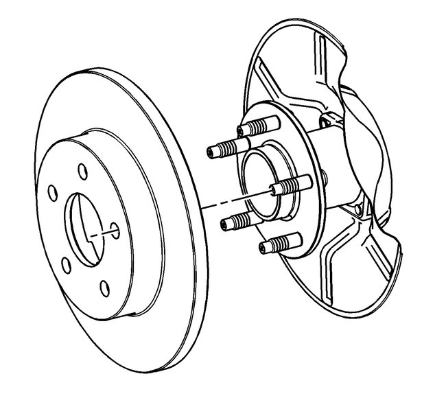

6. Install and firmly hand tighten 2 wheel nuts to opposite wheel studs in order to retain the rotor to the hub.

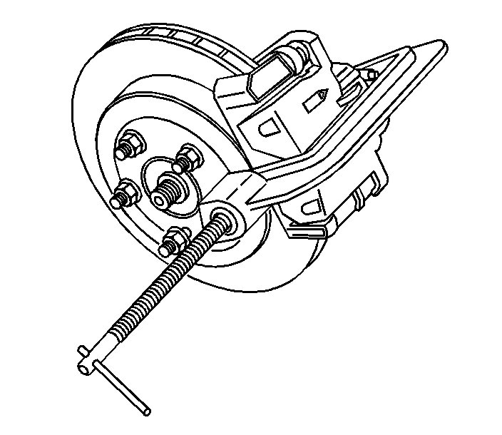

7. Install a large C-clamp, over the body of the brake caliper with the C-clamp ends against the rear of the caliper body and against the outer brake pad.
Caution: When using a large C-clamp to compress a caliper piston into a caliper bore of a caliper equipped with an integral park brake mechanism, do not exceed more than 1 mm (0.039 in) of piston travel. Exceeding this amount of piston travel will cause damage to the internal adjusting mechanism and/or the integral park brake mechanism.
8. Tighten the C-clamp just enough to compress the caliper piston 1 mm (0.039 in) of travel only.
9. Remove the C-clamp from the caliper.

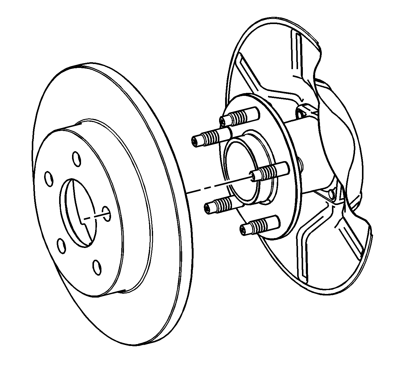

10. While using a wrench on the flats of the caliper guide pins (1), remove the brake caliper guide pin bolts (2).
Caution: Support the brake caliper with heavy mechanic wire, or equivalent, whenever it is separated from its mount and the hydraulic flexible brake hose is still connected. Failure to support the caliper in this manner will cause the flexible brake hose to bear the weight of the caliper, which may cause damage to the brake hose and in turn may cause a brake fluid leak.
11. Without disconnecting the hydraulic brake flexible hose, remove the caliper from the mounting bracket and secure the caliper with heavy mechanics wire, or equivalent.

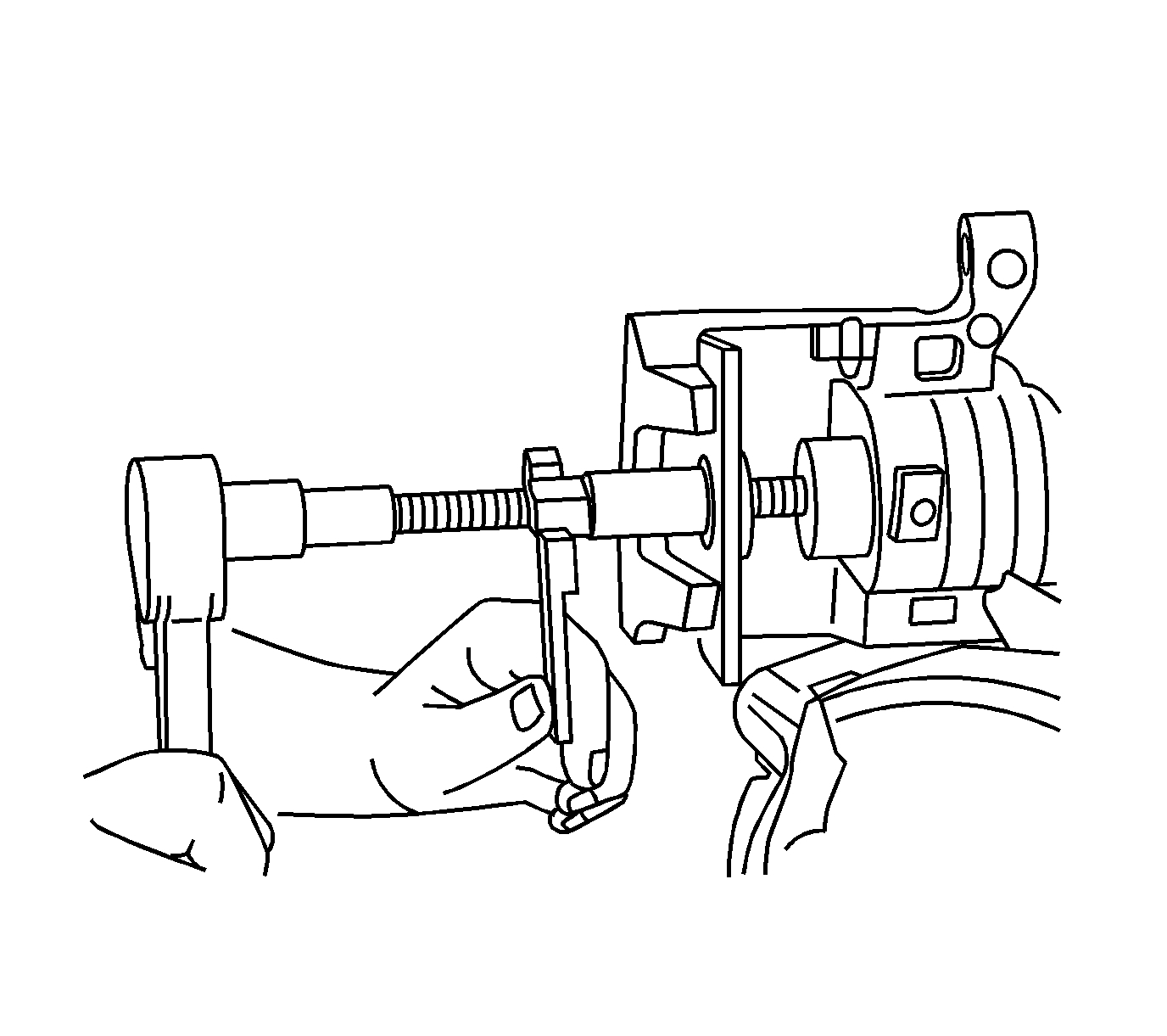

12. Remove the brake pads from the caliper mounting bracket.
13. Remove the brake pad retainers (1) from the caliper bracket.
14. Thoroughly clean the brake pad hardware mating surfaces of the caliper bracket (2), of any debris and corrosion.
15. Inspect the brake caliper guide pins for freedom of movement, and inspect the condition of the guide pin boots. Move the guide pins inboard and outboard within the bracket bores, without disengaging the slides from the boots, and observe for the following:
* Restricted caliper guide pin movement
* Looseness in the brake caliper mounting bracket
* Seized or binding caliper guide pins
* Split or torn boots
16. If any of the conditions listed are found, the brake caliper guide pins and/or boots require replacement.
pic 4
17. Using a spanner wrench type caliper piston installer, fully retract the piston into the caliper bore.

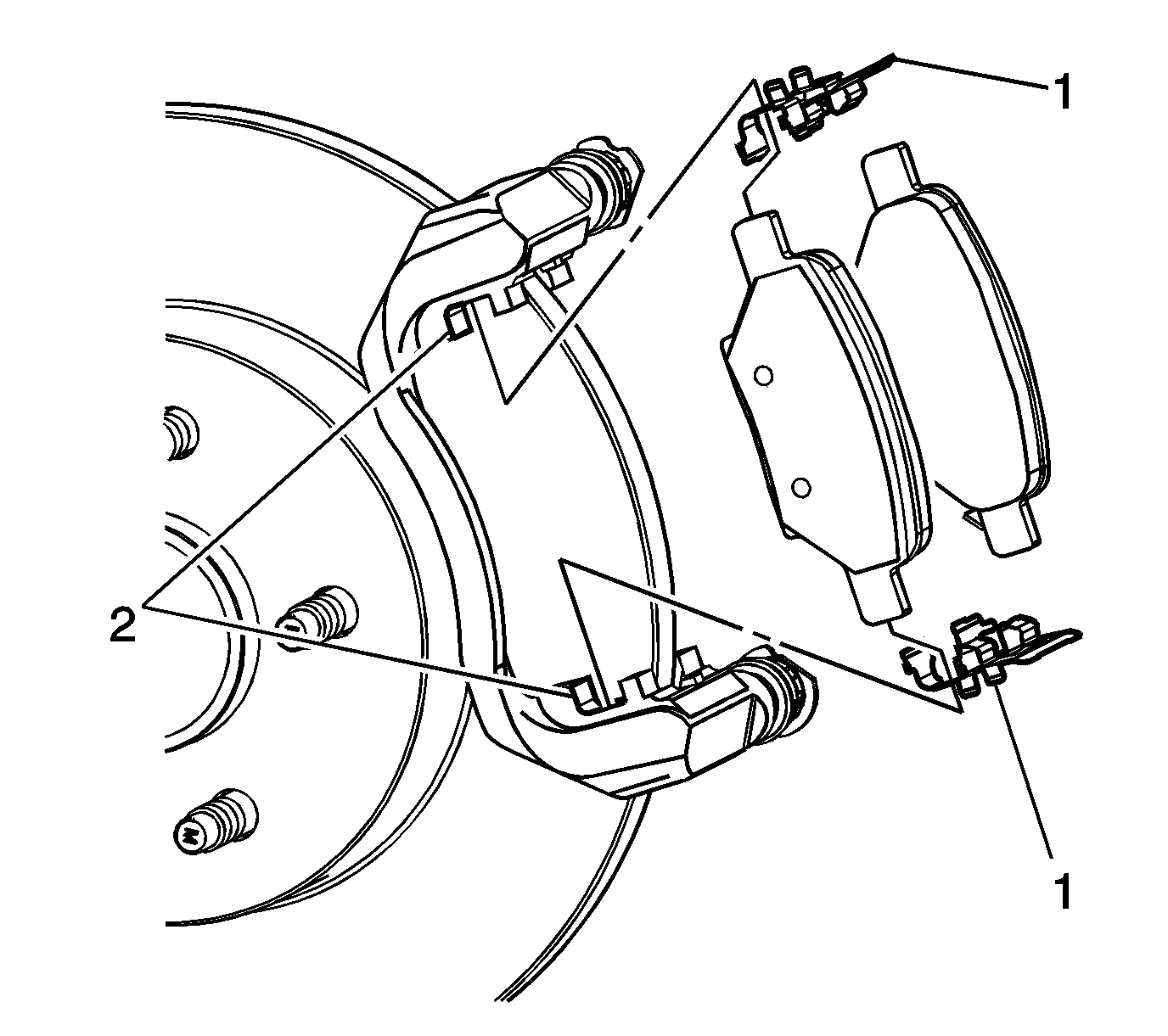

1. Apply a very thin coating of high temperature silicone brake lubricant to the pad hardware mating surfaces of the caliper bracket (2) only.
2. Install the brake pad retainers (1) to the brake caliper bracket.
Note: The wear sensor equipped disc brake pad must be mounted inboard of the rotor with the leading edge of the sensor facing the brake rotor during forward wheel rotation, or at the bottom of the pad when installed in vehicle position.
3. Install the brake pads to the caliper bracket.

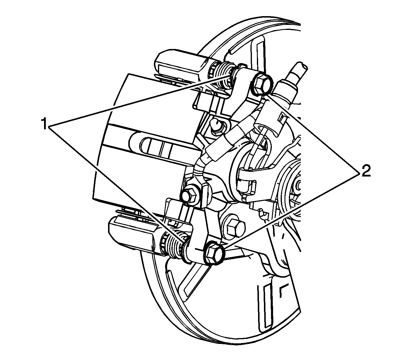

Caution: Refer to Fastener Caution (See: Vehicle > Vehicle Damage Warnings > Fastener Caution).
5. While using a wrench on the flats of the caliper guide pins (1), install the brake caliper guide pin bolts (2).
Tighten the bolts to 34 Nm (25 lb ft).
6. Remove the wheel nuts retaining the brake rotor to the hub.
