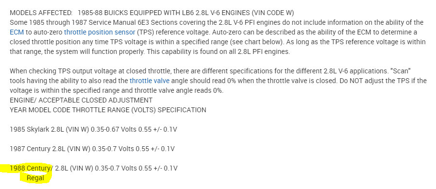

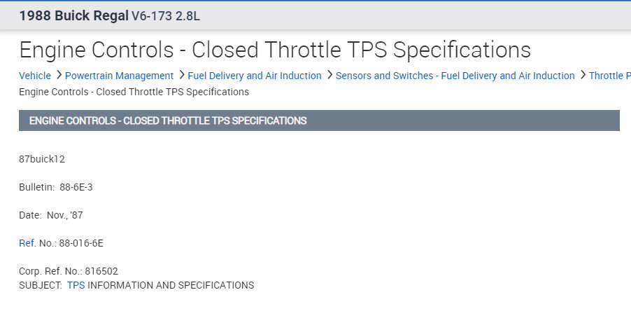

I also like to put a new TPS and IAC on. - Do you know the TPS output signal range for calibration?

As far as the TPS, nothing was listed, but I did find a technical service bulletin related to the TPS. It does show the voltage range. I attached the entire TSB below for you to see.
