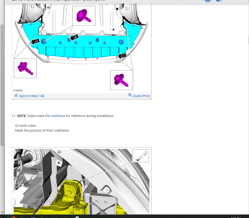

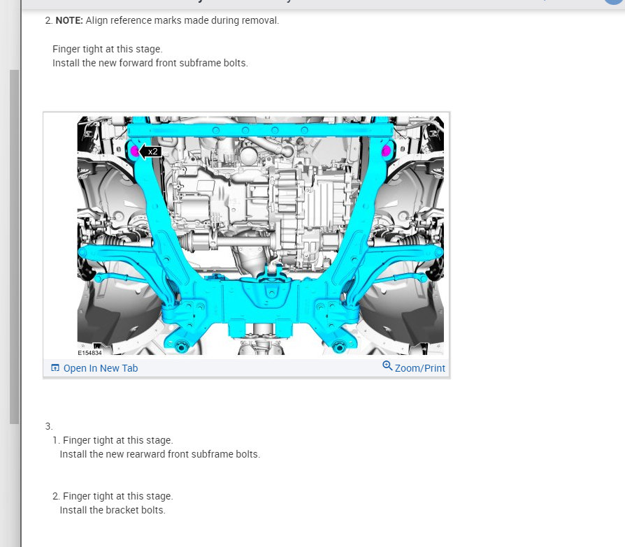

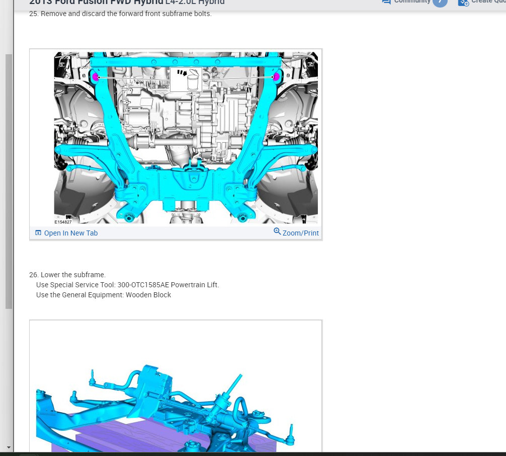

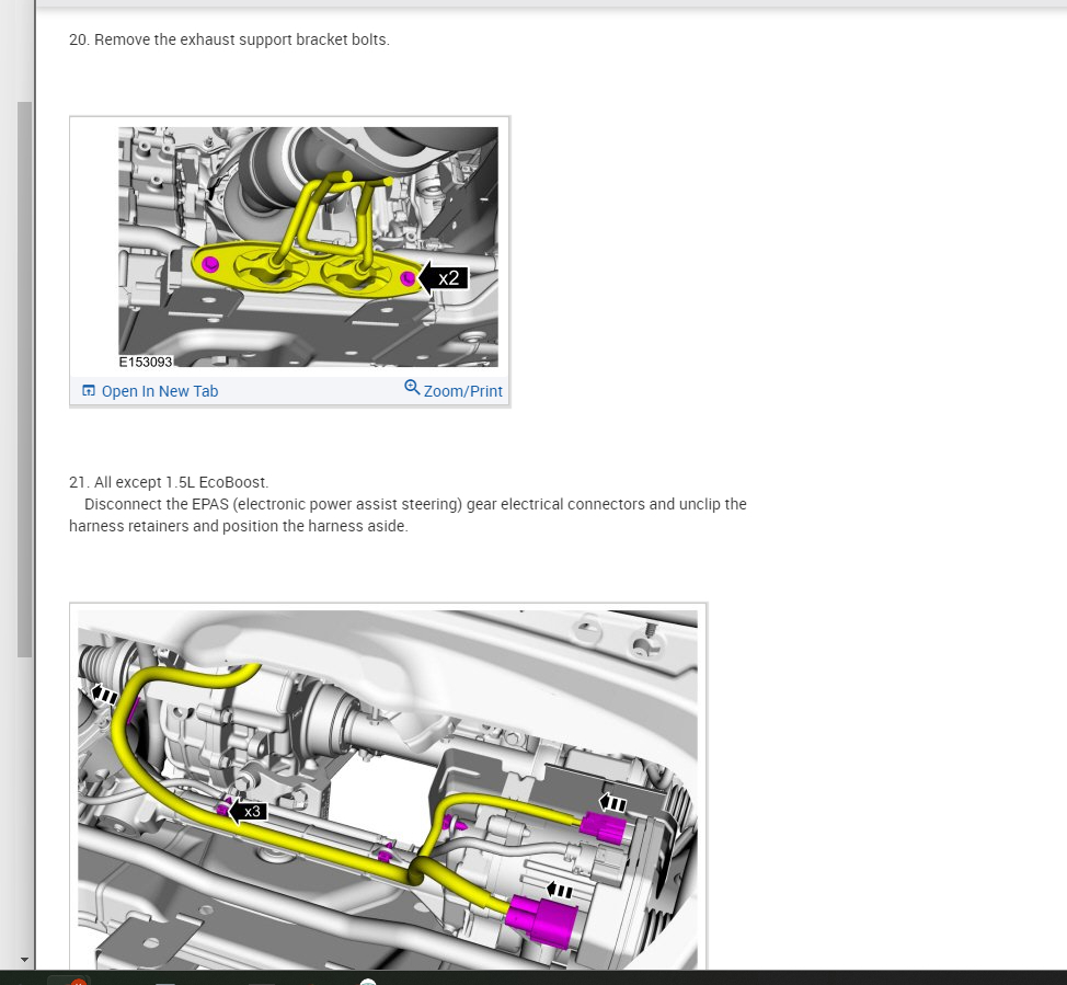

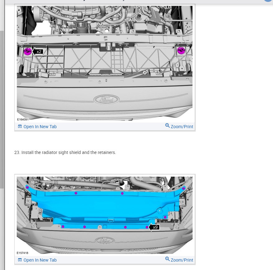

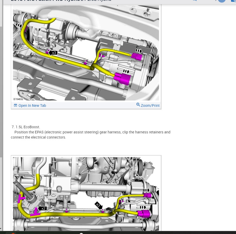

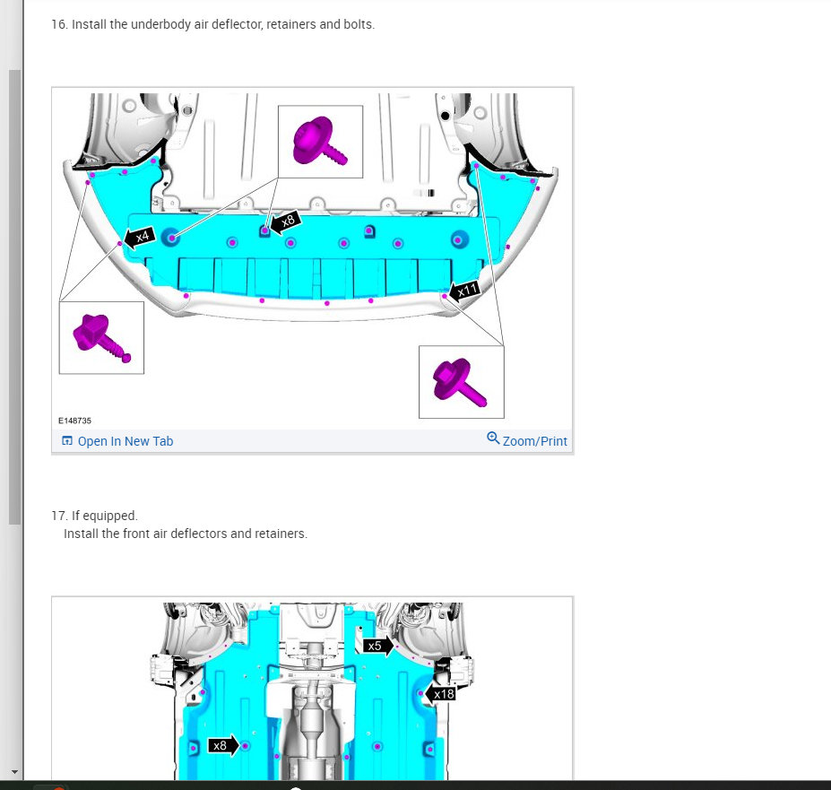

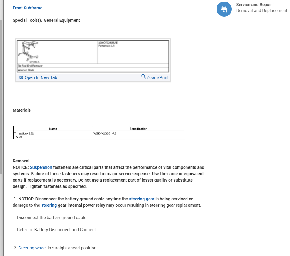

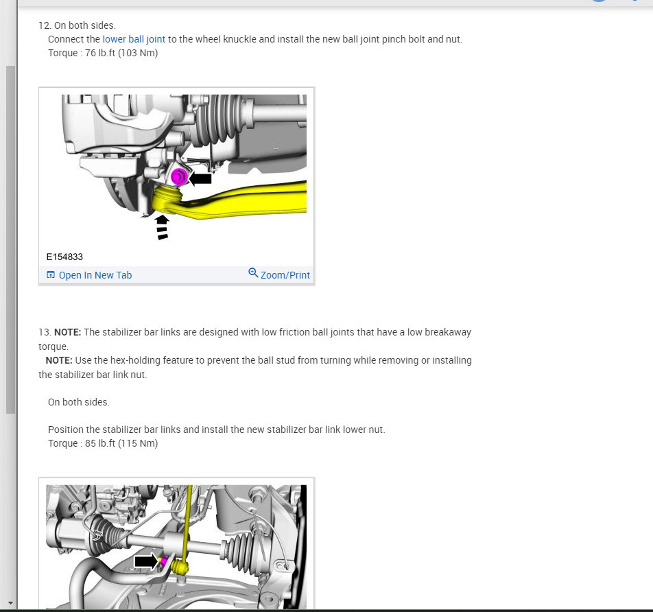

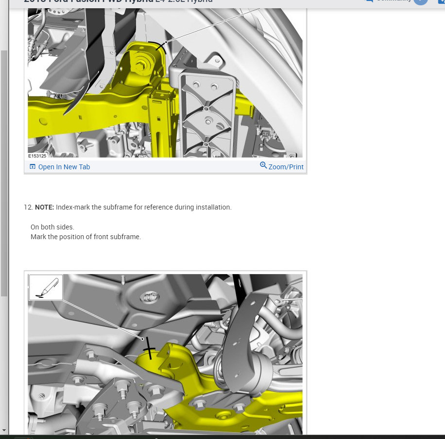

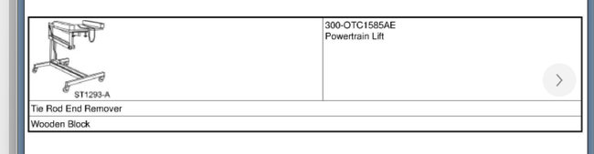

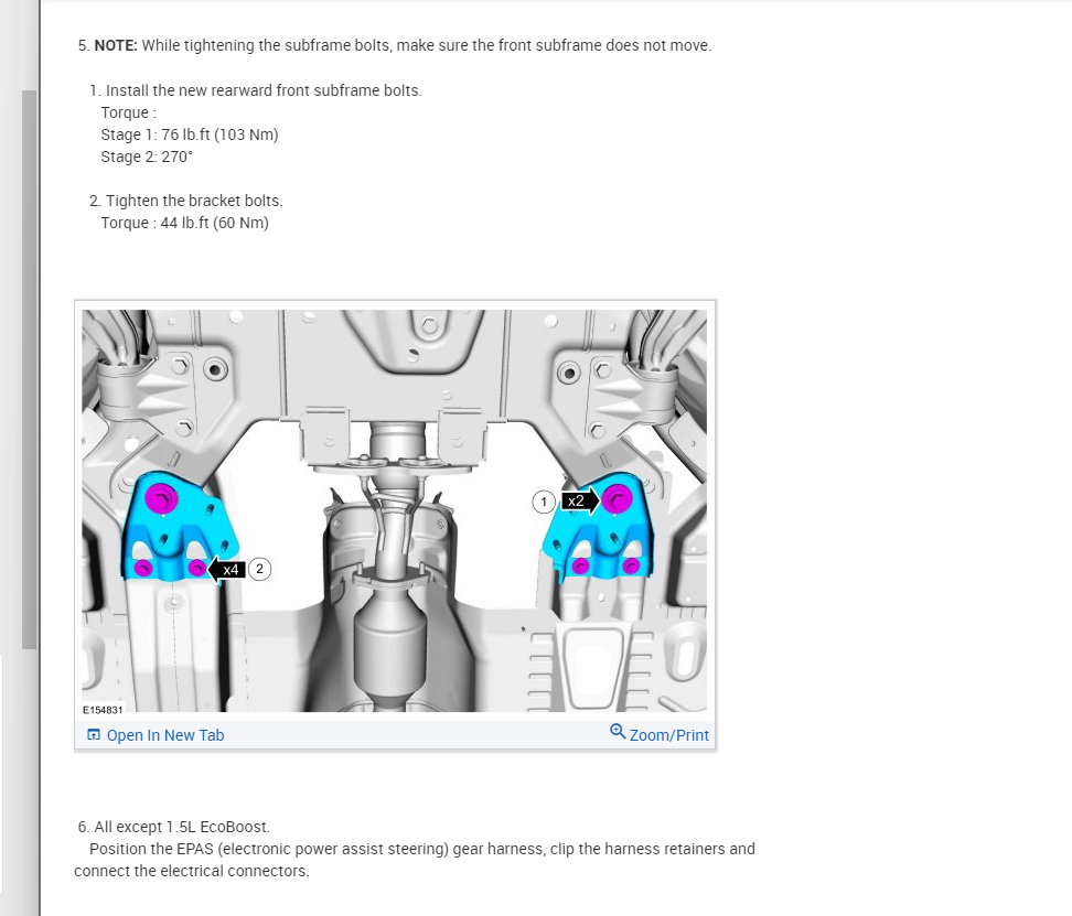

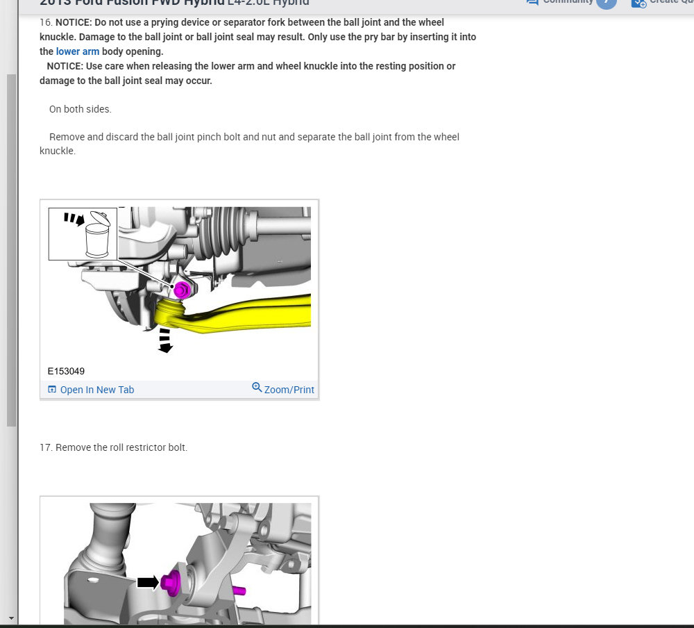

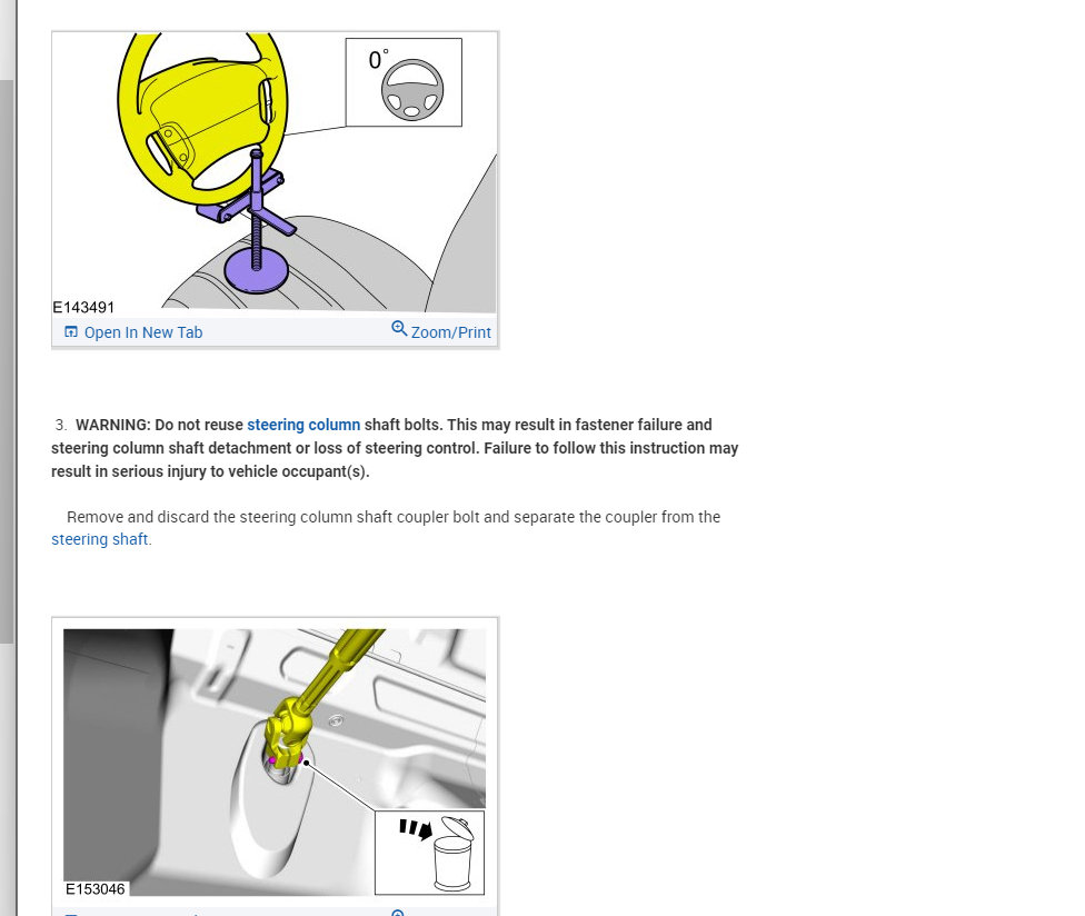

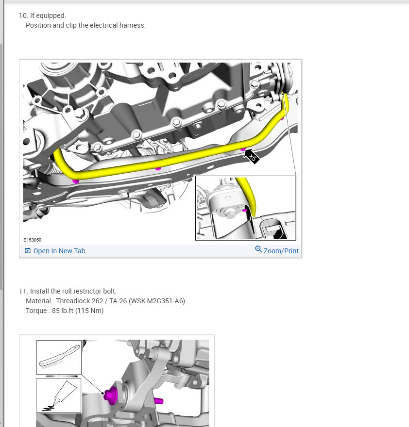

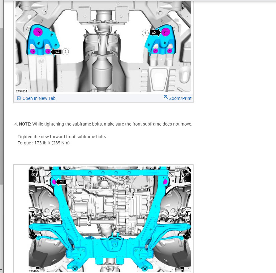

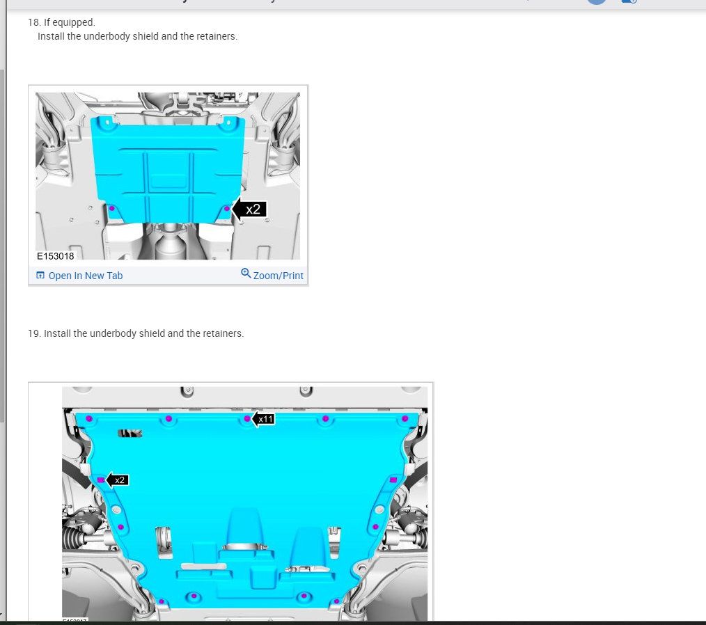

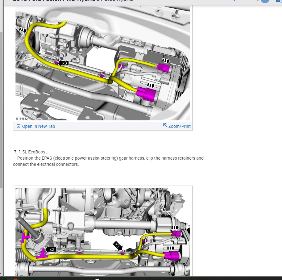

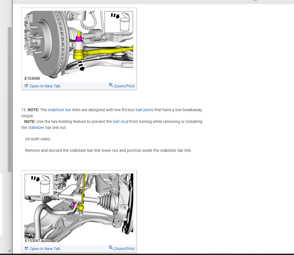

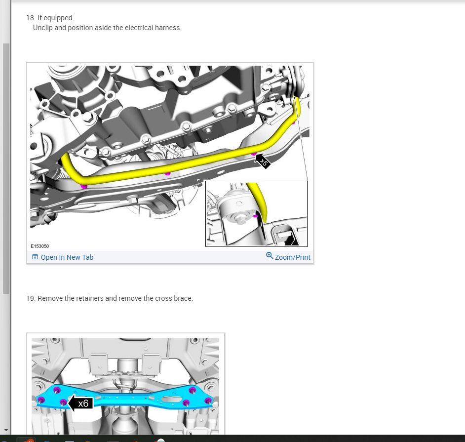

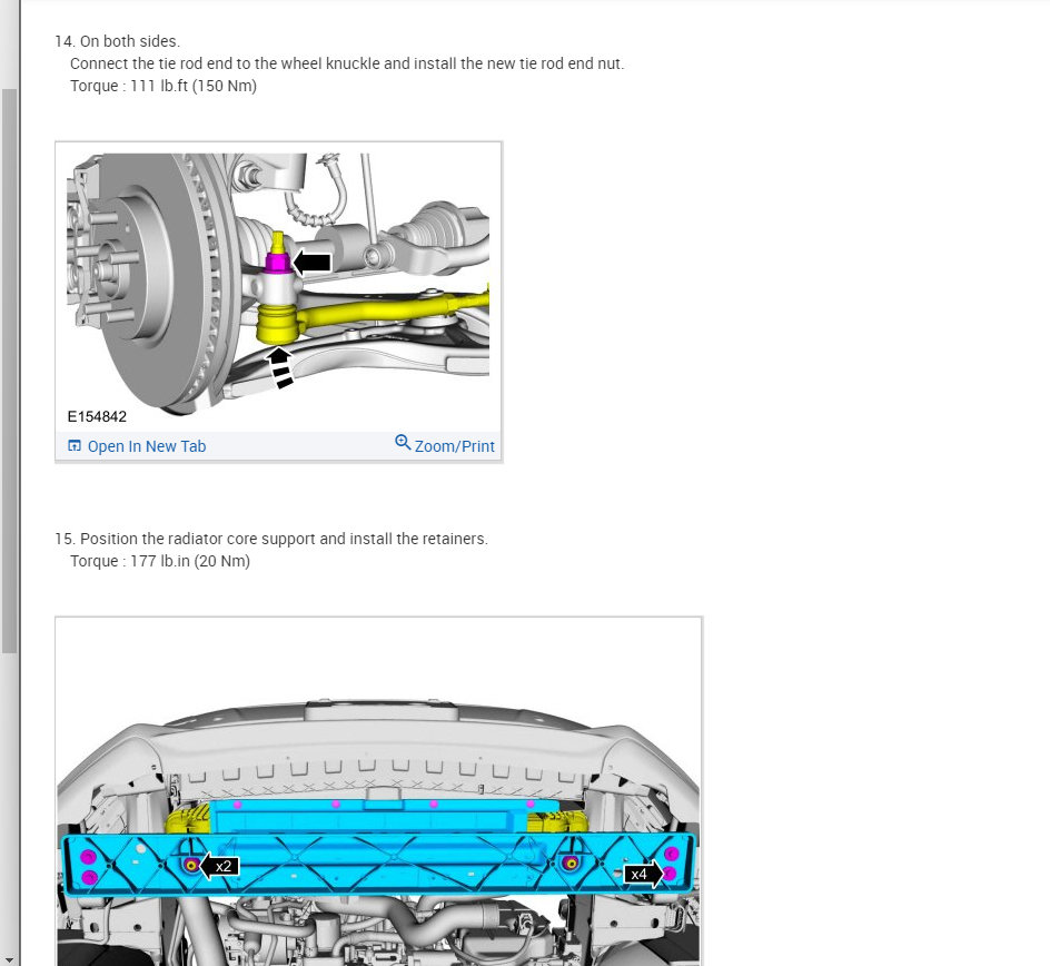

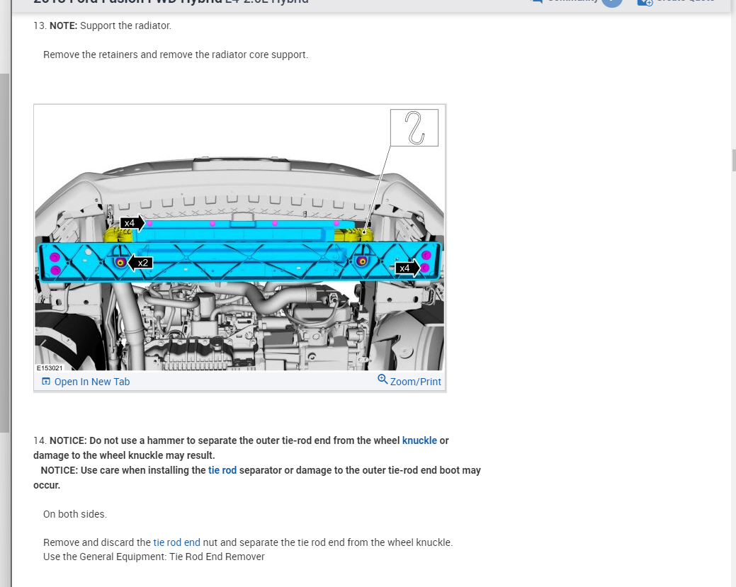

Can I get instructions on how to remove the subframe on my car please? Thank you.
May 22, 2022 at 7:40 AM

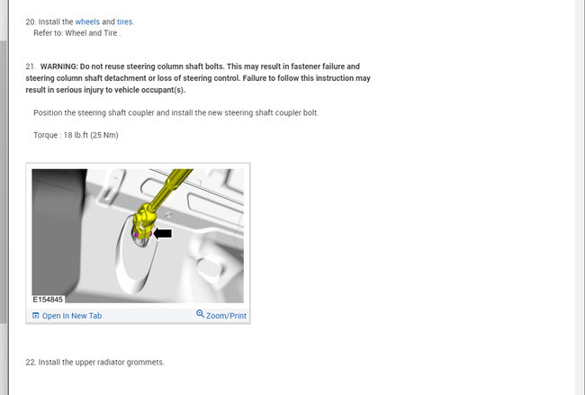

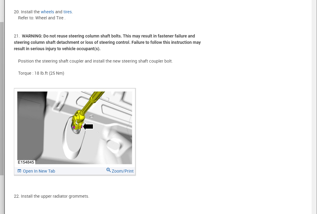

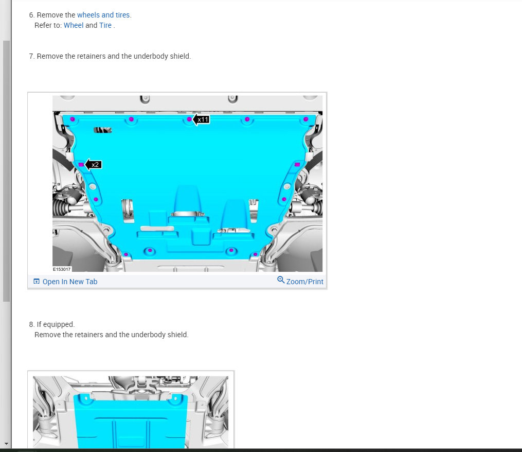

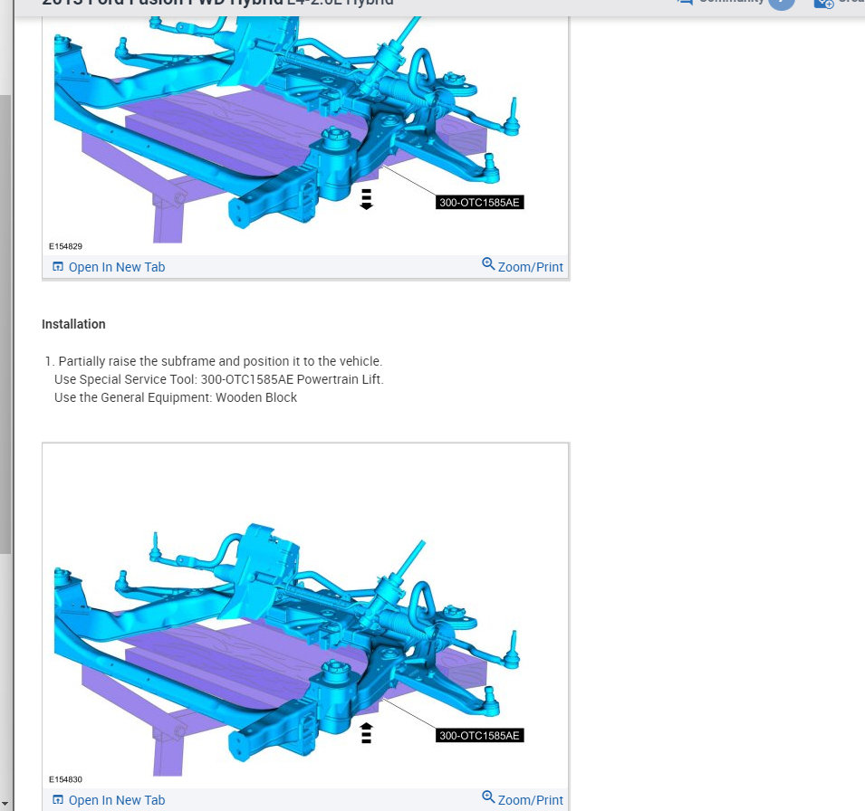

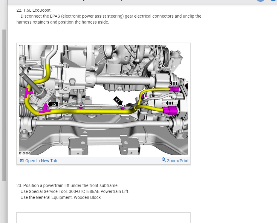

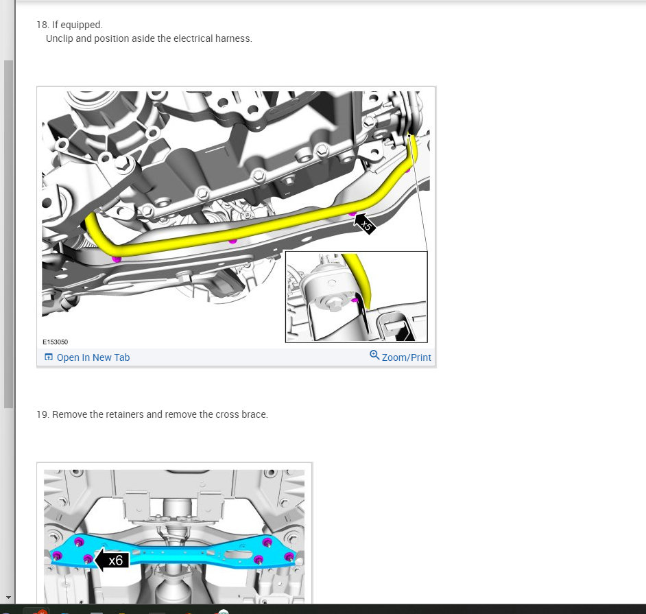

You are going to need a lift or safely jack the car, but you are not going to be able to put the jack stands on the control arms. So hopefully you have a lift.
I am attaching the instructions from the manual. Let us know what questions you have.
Thanks
