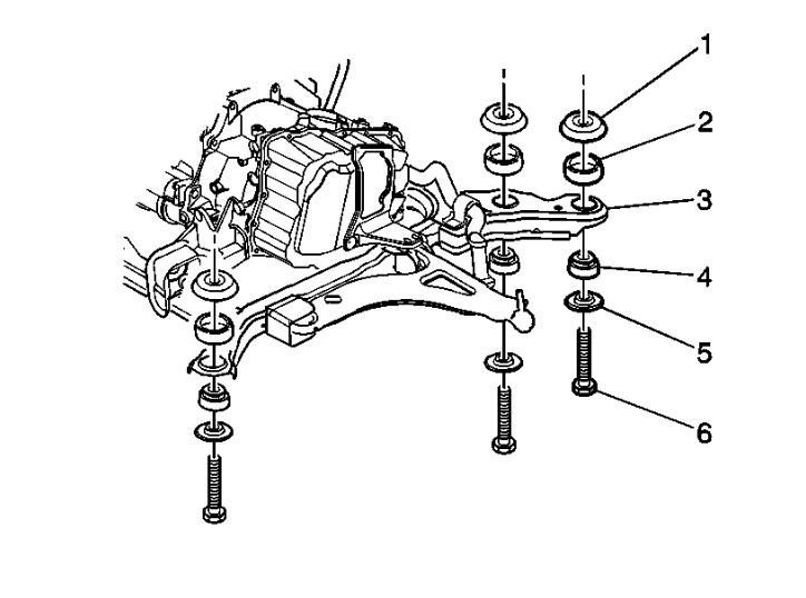

I need to have sub-frame bushings on the car listed above. Would like to know who would carry this part dealer/auto part store? and how to go about installing it.
Mar 4, 2019 at 8:37 AM
Good evening,

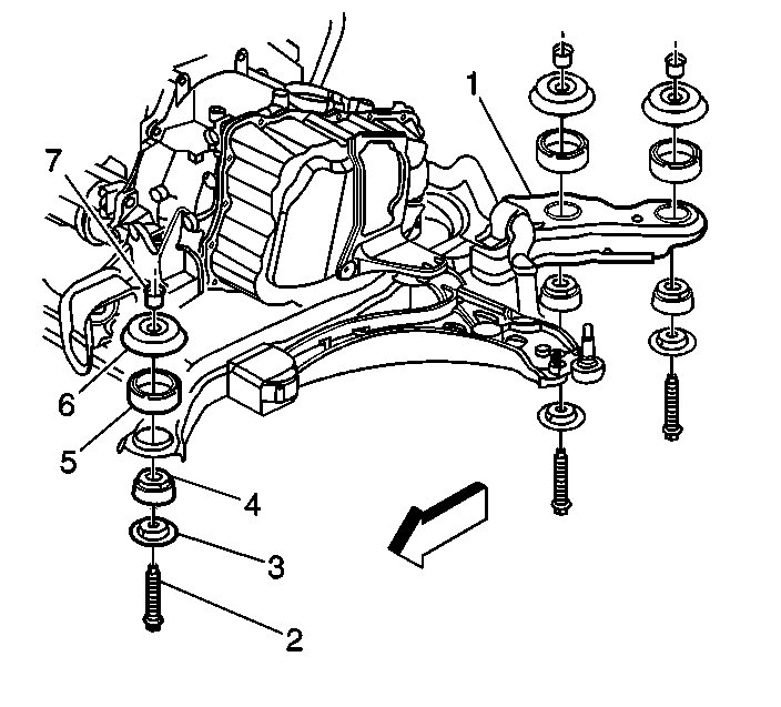

There are three sets of bushings on each side.
You can get them at a dealer parts department.
You need a lift with a jack will allow the frame to drop enough to access the bushings. This is not an easy job at all.
1. Remove the front air deflector. Refer to Front Air Deflector Replacement (See: Air Dam > Removal and Replacement > Front Air Deflector Replacement) in Body Front End.
2. Raise the vehicle using a frame contact hoist. Refer to Lifting and Jacking the Vehicle.
3. Support the frame near the insulator using jack stands.
4. Remove the following components from the insulator (4):
* The bolt (6)
* The retainer (5)
Important: If working on position #2 or #3, other insulator mounting bolts must be removed to remove insulator.
5. Loosen other insulator bolts.
6. Remove the lower insulator (4).
7. Raise the body slightly.
8. Remove the following components:
* The upper insulator (2)
* The spacer (1)
Mar 4, 2019 at 10:02 AM
  • 110,236 POSTS
With this type of job, I would recommend getting the parts from a dealer. You don't want to take a chance of having to replace them again in a year. IT isn't a simple job.

Here are the directions for removal and replacement of the front sub-frame assembly. You are not replacing the frame, so parts of these directions will not be relevant. The attached pictures correlate with the directions.
_________________
FRONT FRAME REPLACEMENT

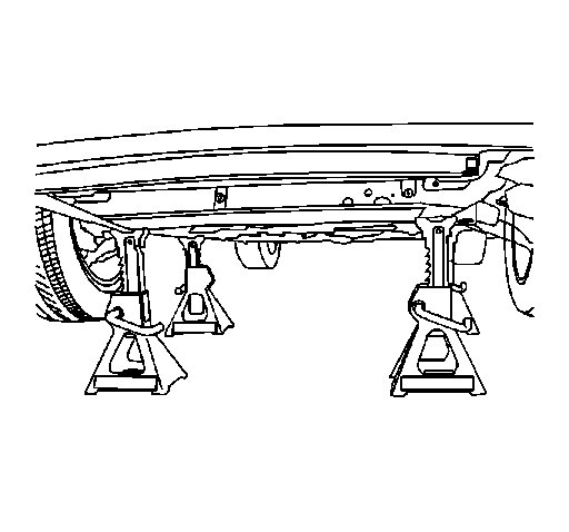

2. Raise and support the vehicle. Refer to Lifting and Jacking the Vehicle.
3. Remove the front tires and wheels. Refer to Tire and Wheel Removal and Installation.
4. Remove the stabilizer shaft. Refer to Stabilizer Shaft Replacement.
picture 1

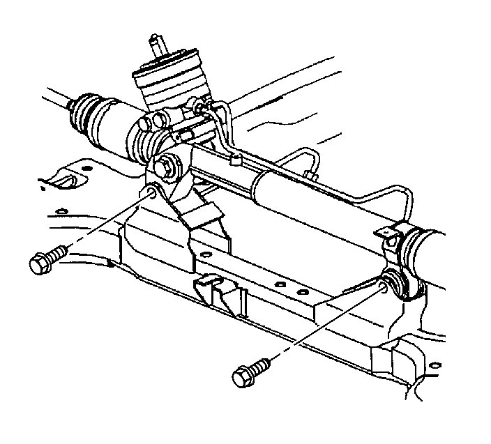

5. Remove the bolts retaining the steering gear to the engine frame.

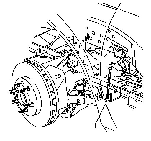

8. Remove the brake pressure modulator valve. Refer to Brake Pressure Modulator Valve Replacement.
picture 2
9. Disconnect the road sensing suspension links (1) from the lower control arm ball studs.

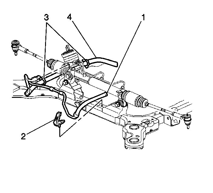

10. Remove the A.I.R. Pump. Refer to Secondary Air Injection Pump Replacement.
picture 3
11. Remove the brackets (2) retaining the power steering line (1) at the frame.
12. Remove the retainer clips (3) retaining the power steering line (4) along the left side of the engine frame.
13. Using mechanics wire, retain the steering gear to the body.

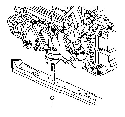

14. Lower vehicle until engine frame rests on suitable jack stands or J 39580.
picture 5

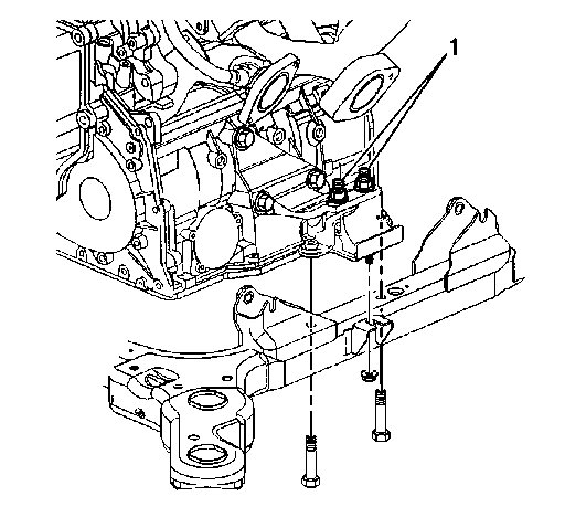

15. Remove the fastener retaining the front engine mount to the engine frame.
picture 6

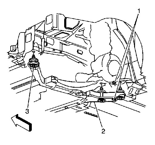

16. Remove the fasteners retaining the rear trans-axle mount (1) to the engine frame.
picture 7
17. Remove the engine frame insulator bolts (3) retaining the engine frame (2) to the vehicle.

19. Separate the engine frame insulators from the engine frame in the following order:
1. Remove the bolts (2) from the engine frame (1).
2. Remove the lower insulator retainer (3) from the lower insulator (4).
3. Remove the lower insulator (4) from the engine frame (1).
4. Remove the retainer (7) and the upper spacer (6) from the upper insulator (5).
Remove the upper insulator (5) from the engine frame (1).
