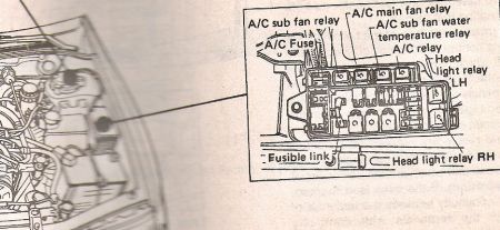

the car is a 1983 Subaru GL wagon. Whenever I put the headlights on bright, it last for a little while and then all the lights go out. I think it would be a circuit breaker, but I can't locate it. Could you help. Car has 382,000 miles on it.

headlight fuses on subaru are generally under the hood on the drivers side.
https://images.2carpros.com/forum/automotive_pictures/54223_fuses_1.jpg

behind the dash on the drivers side there is a row of relays (4 or 5),they look like cylindrical metal cans with a plug on the bottom, two of these are for headlights you can swap a known good one with each (1 at a time) to locate faulty relay(s). they snap right in easily.
This fixed my headlight's which had a very simaliar problem.
