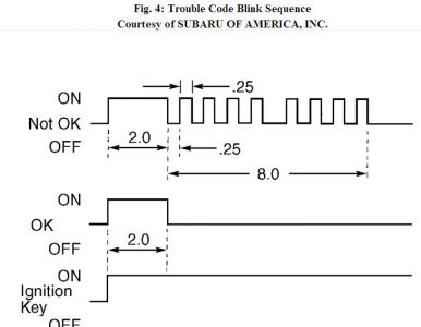

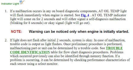

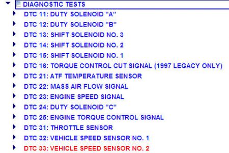

I sent some info to your e-mail. If it is not there, check your spam folder.
https://images.2carpros.com/forum/automotive_pictures/30961_su_1.jpg
https://images.2carpros.com/forum/automotive_pictures/30961_su1_1.jpg
https://images.2carpros.com/forum/automotive_pictures/30961_su2_1.jpg
Verify the flash codes, I think this will be #16
Oct 1, 2009 at 11:37 PM
