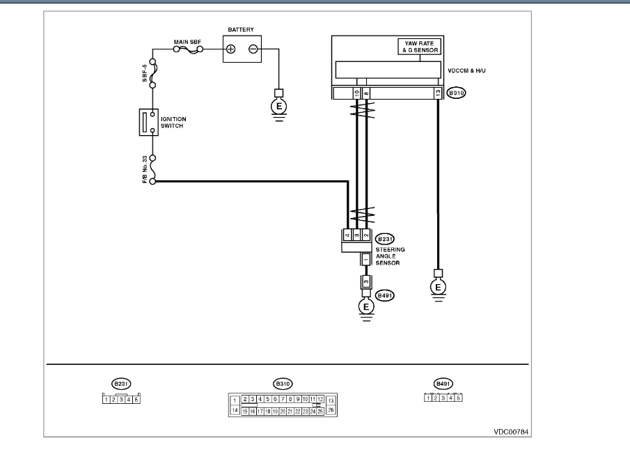

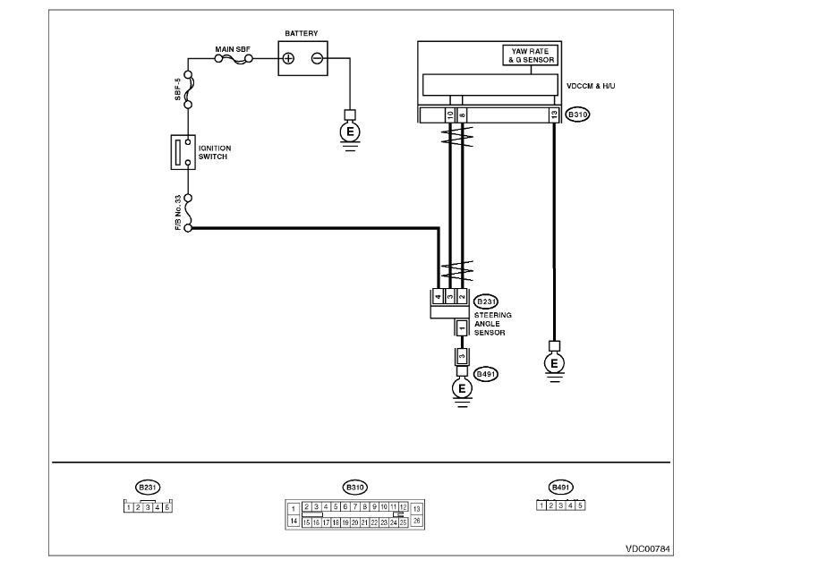

Some google-ing and research has led me to believe there is a chance this problem is electrical in nature, and potentially these sensors aren't getting enough "juice" from the battery. I have checked fuses 5 and 33 as suggested in another post, and my brake lights function properly.

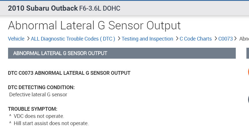

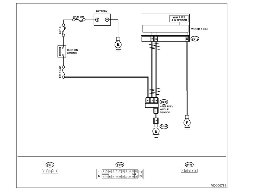

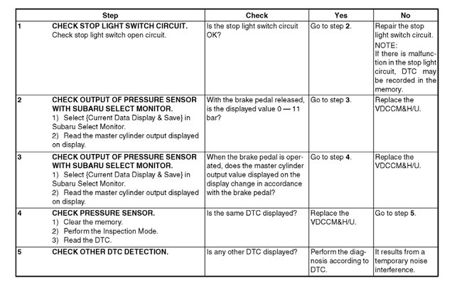

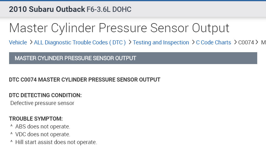

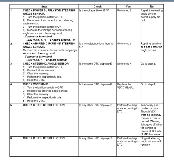

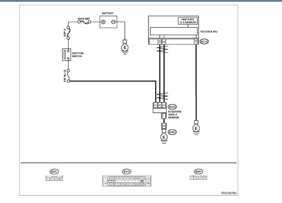

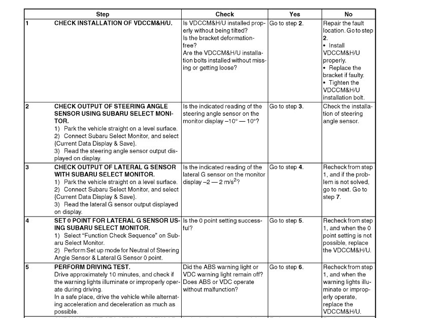

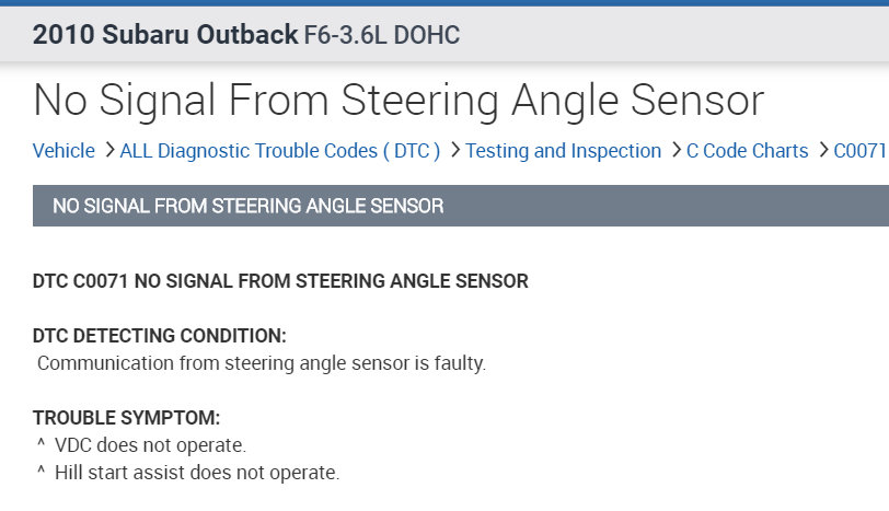

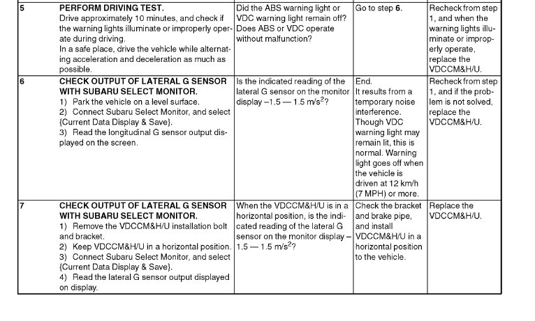

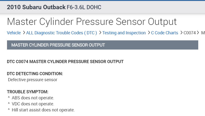

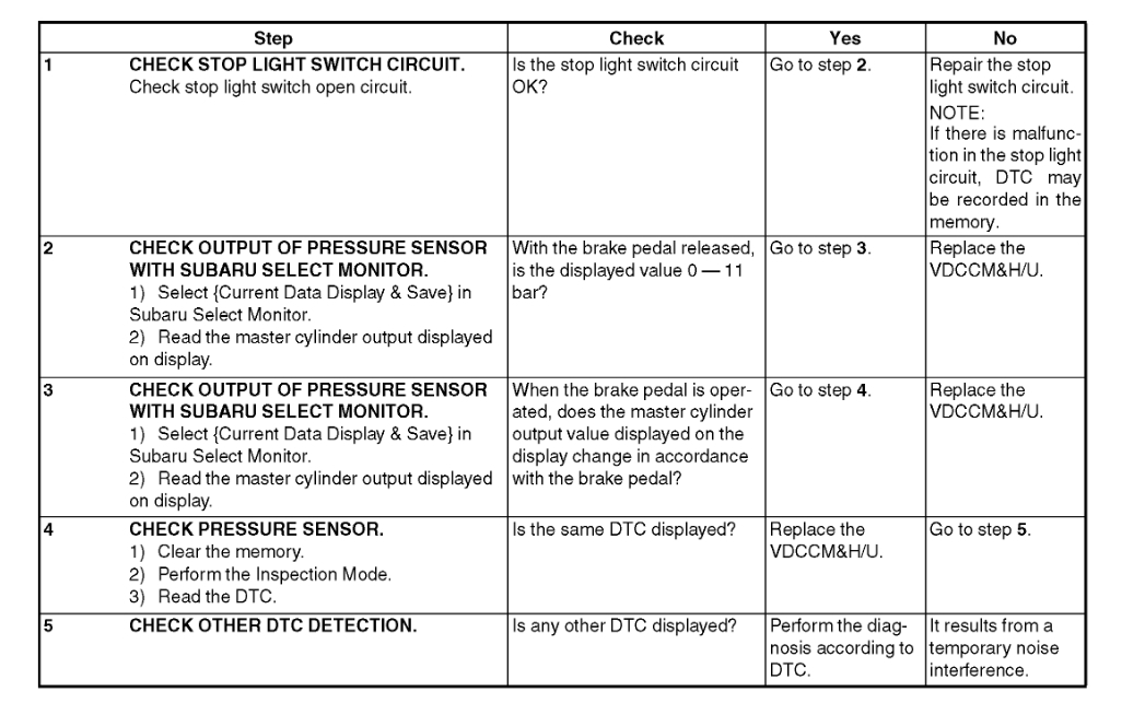

That is weird that unhooking your battery overnight didn't clear the Direct Trouble Codes (DTC)(s) from the Power-train Control Module (PCM)'s Keep Alive Memory (KAM). The preferred method is to clear the DTCs with the code reader, but unhooking the battery definitely should have done the job. Anyway, in the diagrams down below I have included the factory diagnostic troubleshooting guides for DTC C0071, C0073, and C0074 for your vehicle. Please go through these guides and get back to us with what you are able to find out.

I've been able to get the 0071 and 0073 codes to reset thanks to my local auto shop. He had a code reader that was actually able to "re-calibrate" (or reset?) both the steering angle sensor and the lateral g sensor. This fixed both of these codes, and got rid of the ABS light. Traction control remained lit, and brake light continues to flash. 0074 remains.
I have been following the troubleshooting guide you posted for 0074, and found that I did have a light out. I replaced that, and all rear lights are working so I think step 1 is okay? In step 2, my code reader indicated 0 bar. In step 3, the code reader indicated appropriate pressure, up to ~80 bar with a quick, deep push of the brake pedal. In step 4-1, it says to clear the memory. How does one do this? Is this just a generic "clearing of all codes"? Or is there a way (with the right diagnostic scanners) to force a reset on just the master pressure cylinder / vdcc, similar to what the local shop did with the other two sensors?

This is done using Subaru's Select Monitor. You may have to have Subaru or where you had your other sensors reset do this for you.
