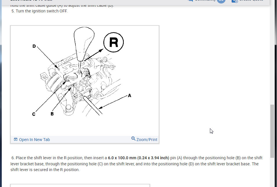

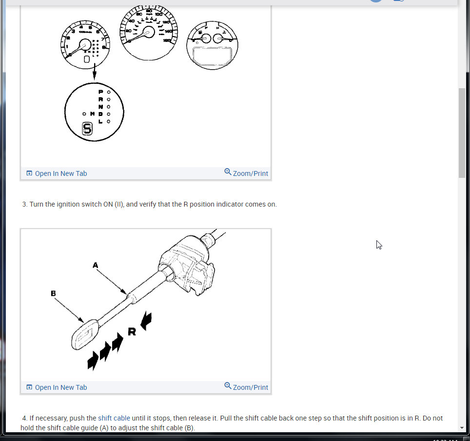

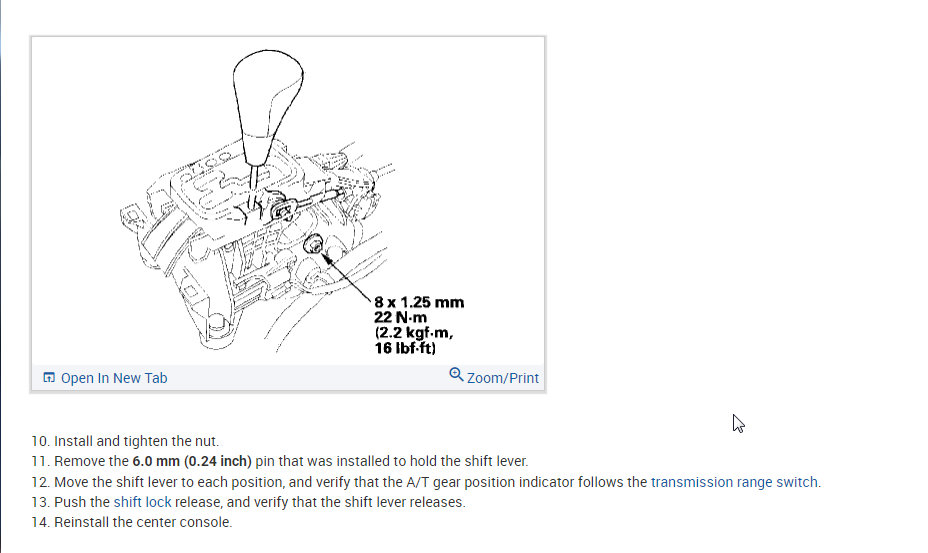

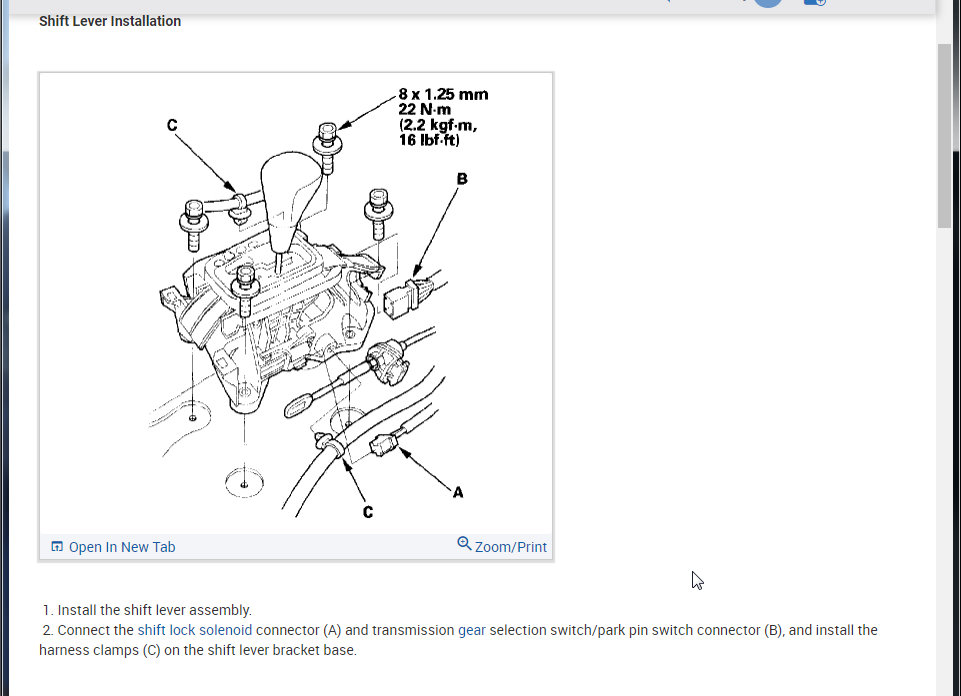

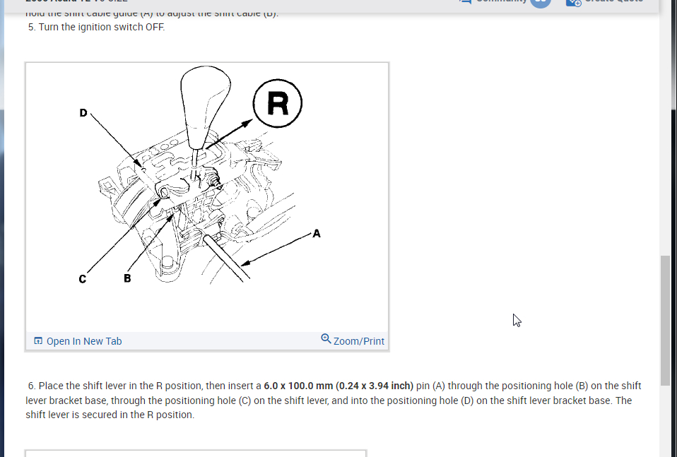

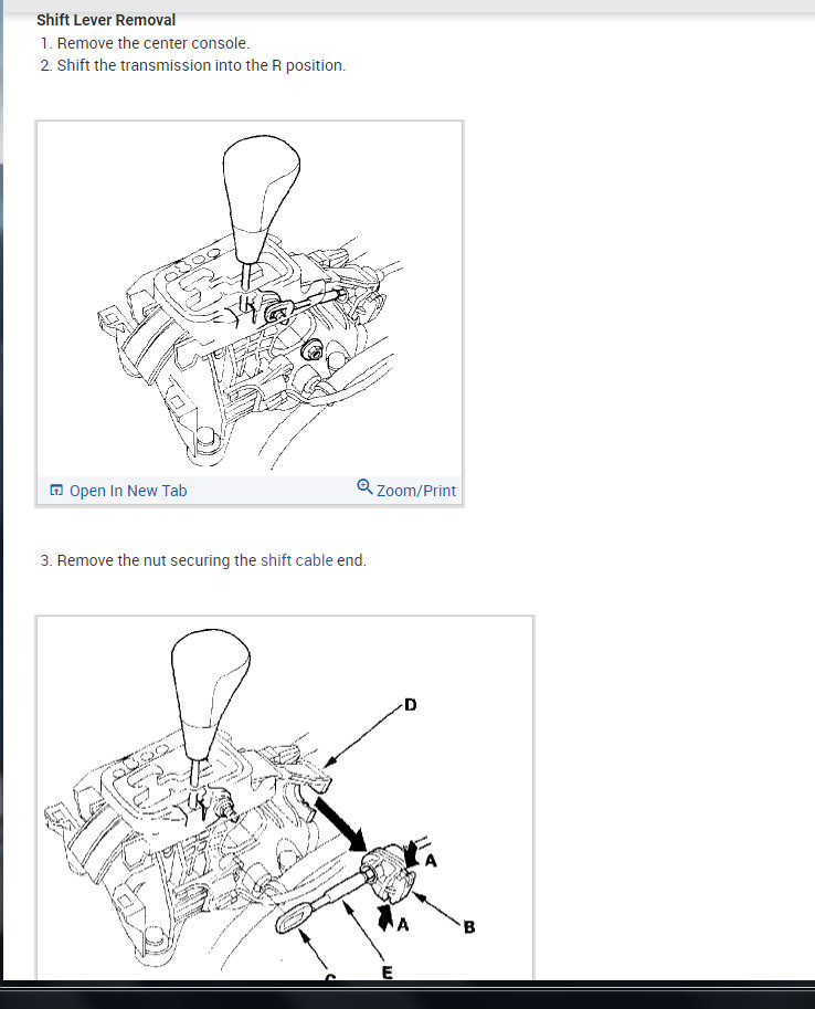

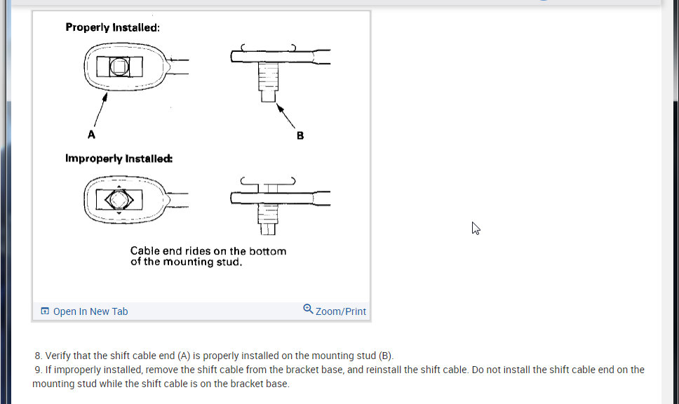

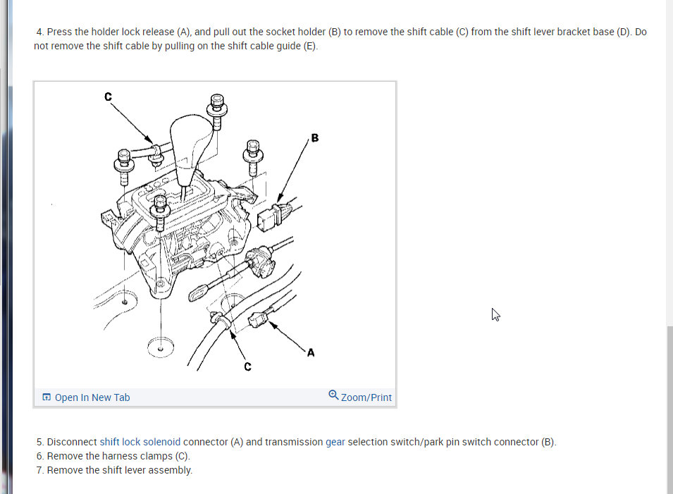

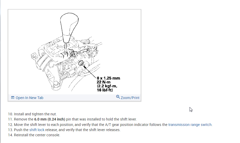

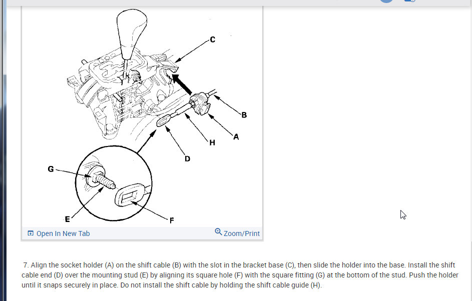

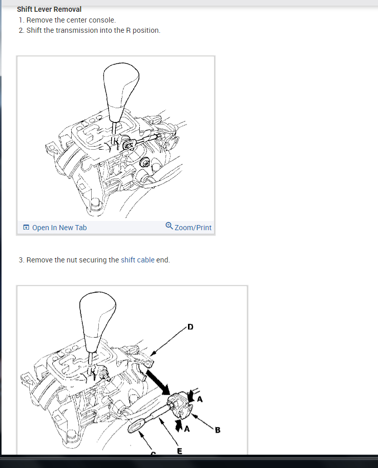

So if the shifter is stuck in manual, the only thing I can think that would prevent it from moving back over into D is the shift gate inside the shifter has broken or is stuck not allowing you to push it back over.
I am attaching the process on how to replace the shifter. I am not sure it needs to be replaced but I would at least take it apart and find out if you can see anything that may be blocking it. If not, you are going to have to replace it.
Let us know what you find with this. Thanks
