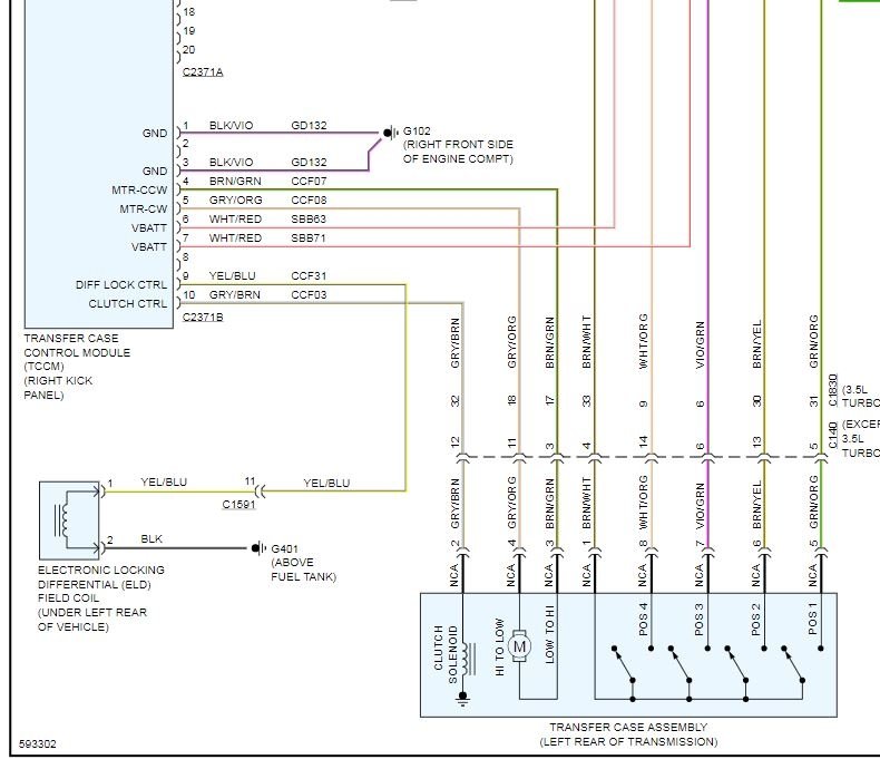

Good morning, I had a quick question about an issue on my truck. It currently seems to be stuck in 4H, and when I turn the knob back to 2H the 2H light flashes on the dash. However, I can tell it is still in 4H because I can feel some binding/rear wheel slip in a turn (just while test driving to see if it had gone back into 2H). I can hear the vacuum actuator running for a short while during the "shift" process but it obviously is unable to complete the shift to 2WD. I have checked fuses for the system, as well as tried to drive it forward and then for a bit in reverse to try and see if I could get the transfer case into a neutral loading so it could switch into 2WD. I normally try to do most of my car work myself, so I just wondered if there might be something else I'm missing and should check as I was hoping to avoid a tow, even if I do have to take into to a dealer once I get it back into 2WD. Thanks so much for any advice you might have!

Thanks for the reply and I don't mind you asking at all - totally logical question! Unfortunately as far as the warranty goes it's a little messy in this case - the vehicle was a test vehicle (my work does vehicle bench marking and auctions them off at the end of projects) and some of the ECU wires were extended for recording signals. All the wires are still connected but I know if I take it in for warranty work before I get the chance to remove the extensions and resolder the harness wires that they'll most likely turn it down for these modifications, even though the transmission wires weren't fiddled with (I know there's still a chance an ECU wire could cause an issue with communicating with the transmission, but I figured I'll get the harness repaired first).
On a different note though - I was able to get it lifted at work and with all four wheels in the air, I found out it is not stuck in 4WD. It was still binding however, so I believe it could be something related to the rear e-locking differential instead (all fuses are fine though, and the vehicle seems to think it is unlocked as far as dash indicators go). Do you know of any things that would be good to take a look at with these symptoms or is getting a better scan tool still the best recommendation?

It's very possible the rear axle is still engaged, however I'm not quite sure how that correlates to the flashing 2wd indicator as the rear axle locker does not have a position/status switch. It's simply a 12v coil that's energized by the Transfer Case Control Module to engage the locker. So the TCCM has no idea what state the locker is actually in. Based on your findings though, it does make sense to rule this out as a possible contributing factor. Attached is a diagram of the rear axle locker wiring. I would unplug the C1591 connector and see if the locker disengages. You should be able to verify this on the hoist by turning one of the wheels with the transmission in Park. If it's unlocked, the opposing wheel will turn in the opposite direction. If it stays locked up, you won't be able to turn it at all. Does the truck respond in any way when pressing the rear axle lock button on the dash? Also, what happens when you move the 4wd switch to 4Hi/Lock or any of the other modes?

Oh okay got it. that makes more sense regarding the coil and whether the TCCM would be able to tell what state it is in. I hadn't seen this reply yet so I haven't yet been able to try disconnecting the C1591 connector, but I did have it on the lift earlier and switched the locker knob between on/off a few times but it was still binding very noticeably when I first took it off the lift and tried to turn the truck. However, I repeated this one more time (just hoping for some luck I guess) and the wheels were turning in opposite directions when I moved one by hand. I put it back down and didn't feel any binding at all as I turned out of the workshop, then felt it binding again for the turn out of the parking lot, but then it seemed to disengage again after just that one turn (I didn't touch the knob or anything). It was fine going to the gas station and then back. As this seems to be intermittent I will try giving it a short drive after work again tomorrow and if/when it starts binding again I'll try and get it on the hoist and disconnect that C1591 coil connector.
By the way, in answer to your questions, the truck does not seem to respond in any way when pressing the rear axle lock knob in/out on the dash, though I will try putting it into the locked mode and turning the wheel by hand and then turning it off and trying this again to verify. For the 4WD portion of the switch, if I turn it from 2H -> 4H, a dash indicator appears saying it is switching to 4H and I can hear the vacuum actuator running for a few seconds until it finishes engaging and the message disappears. Very similar for turning it into 4L, though it first prompts me to put the vehicle in Neutral. When I go back to 2H from either of these, it gives a similar message saying it is transitioning to 2H (though from 4H -> 2H I don't hear the vacuum actuator running for a few seconds as it did in the other direction).
