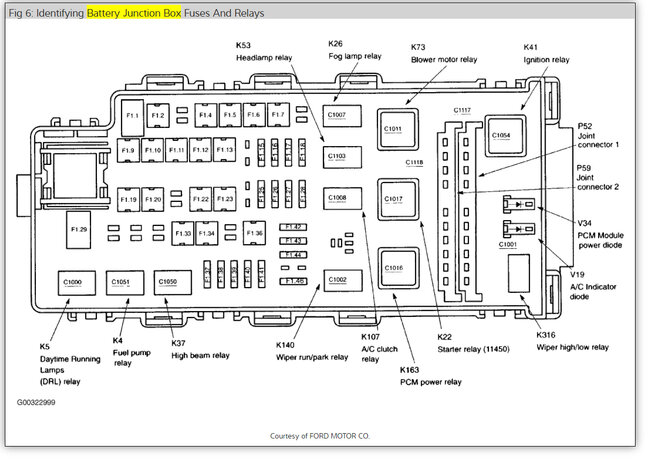

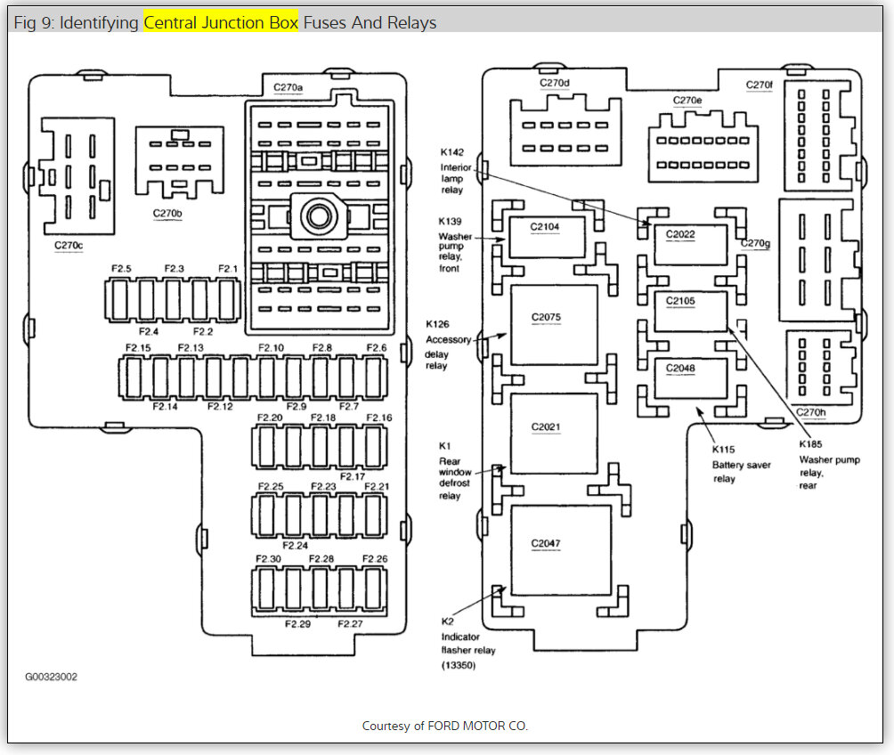

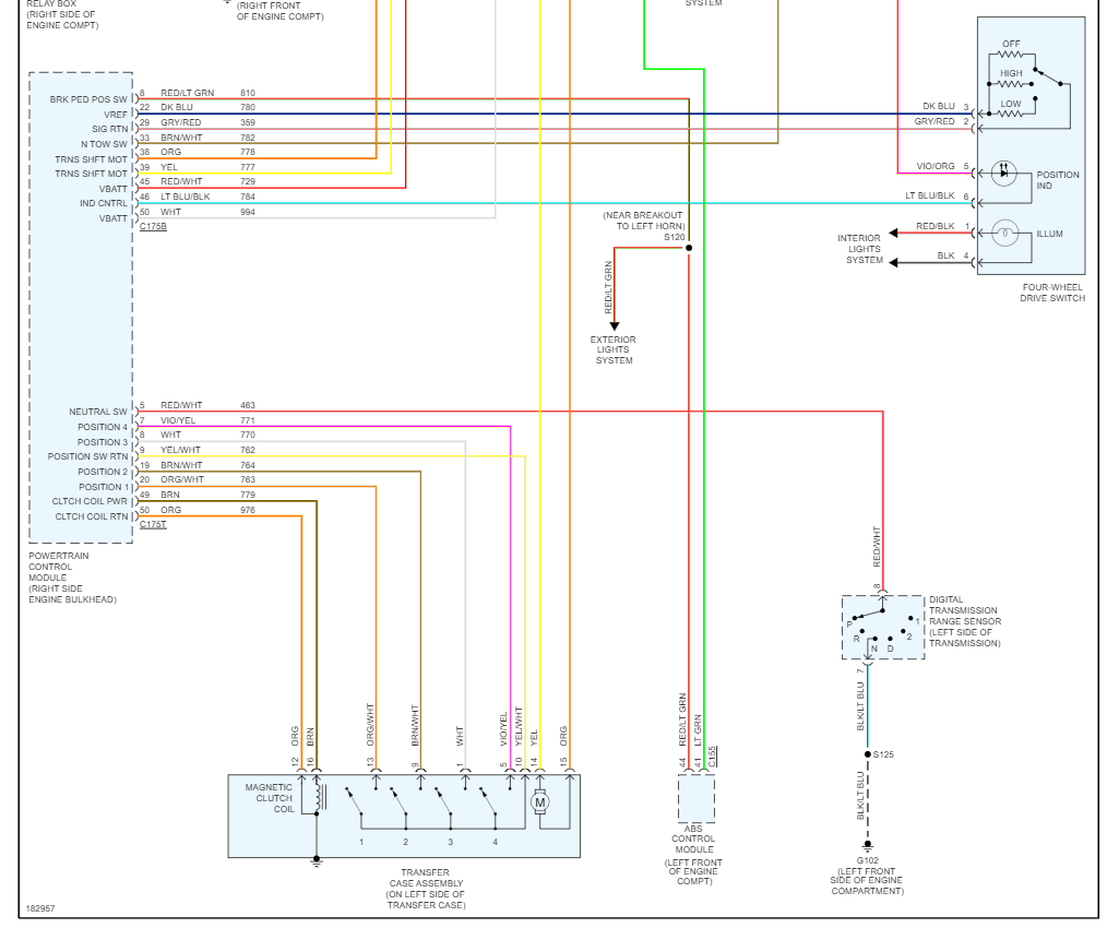

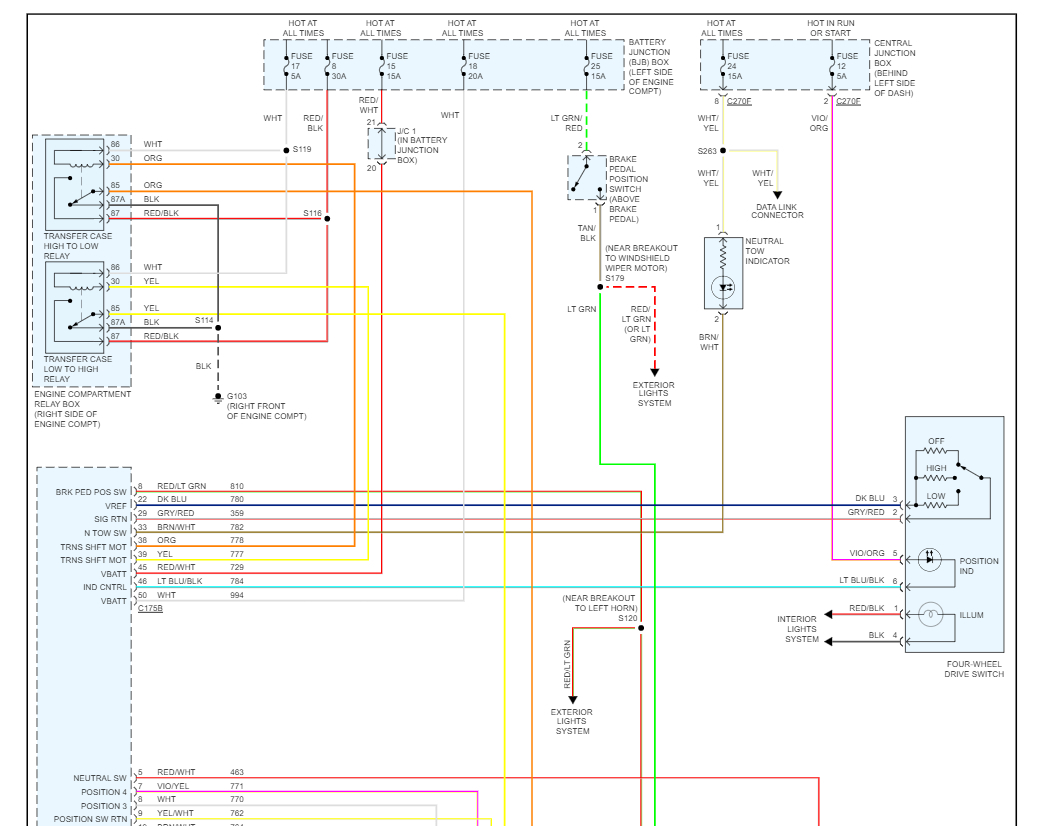

Can you please remove the shift motor and leave the wires connected? Then turn the key on and work the control to see if the shift motor works/moves? This way we can tell if the problem is internal to the transfer case or electrical. Also, can you check the fuse # 17, 8, 15, 18 and 25 in the under-hood fuse panel and fuse# 24 and 12 in the interior fuse panel on the left side of the dash. Here is a guide to help and the fuse locations I also have included the wiring diagrams for the transfer case so you can see how the system works.
Please check the images below and get back to us.
