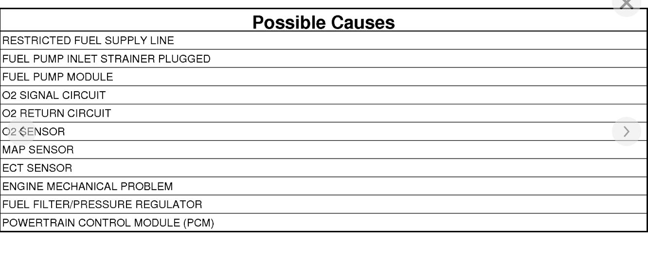

A while back I had my car give me all these fuel and emission related codes after getting contaminated from bad gas which are now gone after replacing a good amount of sensors and parts. Most recently I replaced the fuel pump and filter but it still threw P1128 and P1129, o2 sensors are all new and I even replaced the coolant temperature sensor and it still gives me those code. What could it be?
Monday, March 30th, 2020 AT 11:34 AM
  • 52,797 POSTS
Good afternoon,

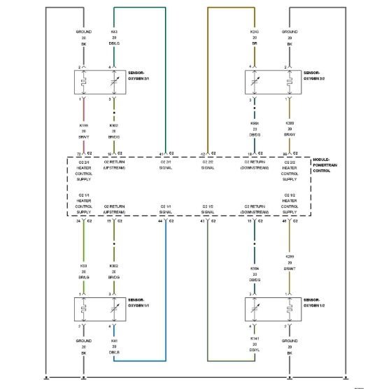

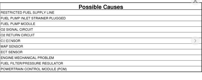

These codes are for no closed loop operation from the upstream O2 sensors. It does not mean it is the sensor but it could be many things. I posted below a flow chart and possibilities for the failure. They must be checked to find the root cause of failure.
P1128-CLOSED LOOP FUELING NOT ACHIEVED - BANK 1
Special Tools:
For a complete wiring diagram, refer to the Wiring Information .

Enable conditions are met and the O2 Sensor has not been in closed loop control at least once on each of the two consecutive trips, the MIL illuminates and the DTC is set. Two Trip Fault. Three good trips to turn off the MIL.
Always perform the Pre-Diagnostic Troubleshooting procedure before proceeding. See: Computers and Control Systems > Initial Inspection and Diagnostic Overview > Pre-Diagnostic Troubleshooting Procedure.
1. ACTIVE DIAGNOSTIC TROUBLE CODE (DTC)
1. Diagnose all other DTCs before continuing.

2. CHECKING FUEL PRESSURE
WARNING: The fuel system is under a constant pressure (even with the engine off). Before testing or servicing any fuel system hose, fitting or line, the fuel system pressure must be released. Failure to follow these instructions can result in possible serious or fatal injury.
1. Turn the ignition off.
2. Install Fuel Pressure Decay Tester to the fuel rail.
3. Ignition on, engine not running.
4. Using the scan tool, actuate the ASD Fuel System test and observe the fuel pressure gauge.
NOTE: Fuel pressure specification is 400 kPa +/- 14 kPa (58 psi +/- 2 psi).
5. Turn the ignition off.
Choose a conclusion that best matches your fuel pressure reading.
Within Specification
Go To 3
Above Specification
Replace the fuel filter/pressure regulator.
Perform the POWERTRAIN VERIFICATION TEST. See: A L L Diagnostic Trouble Codes ( DTC Verification Tests > Powertrain Verification Test.
Below Specification
Go To 12 CAUTION: Stop All Actuations.
3. O2 SENSOR OPERATION
1. Start the engine.
2. Allow the engine to reach normal operating temperature.
NOTE: If one of the O2 Sensor Signal or Return circuits are shorted to ground the scan tool will display all O2 Sensor voltage readings low. The O2 Sensor that is shorted to ground will display a voltage reading near or at 0 Volts.
NOTE: If one of the O2 Sensor Signal or Return circuits are shorted to voltage, the scan tool will display all O2 Sensor voltage readings high.
NOTE: After the repairs have been made, verify proper O2 Sensor operation. If all the O2 Sensor voltage readings have not returned to normal, follow the diagnostic procedure for the remaining O2 Sensors.
3. Using the scan tool, monitor the O2 Sensor 1/1 voltage reading.
Is the voltage switching between 2.5 and 3.4 Volts?
Go To 4
Go To 8

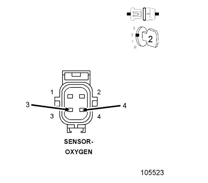

4. O2 SENSOR 1/1 HEATER OPERATION
NOTE: Wait a minimum of 10 minutes to allow the O2 Sensor to cool down before continuing the test. Allow the O2 Sensor voltage to stabilize at 5.0 Volts.
NOTE: Perform the following test on all O2 Sensors.
2. Ignition on, engine not running.
3. With the scan tool, actuate the 1/1 O2 Heater Test.
4. Using the scan tool, monitor 1/1 O2 Sensor voltage for at least two minutes.
Does the voltage stay above 4.5 Volts?
Verify that there is good pin to terminal contact in the O2 Sensor and Powertrain Control Module connectors. If OK, replace the O2 Sensor.
Perform the POWERTRAIN VERIFICATION TEST. See: A L L Diagnostic Trouble Codes ( DTC ) > Verification Tests > Powertrain Verification Test.
Go To 5

7. ENGINE MECHANICAL PROBLEM
2. Check for any of the following conditions/mechanical problems:
AIR INDUCTION SYSTEM - must be free from leaks
ENGINE VACUUM - must be at least 13 inches in neutral
ENGINE VALVE TIMING - must be within specifications
ENGINE COMPRESSION - must be within specifications
ENGINE EXHAUST SYSTEM - must be free of any restrictions or leaks
ENGINE PCV SYSTEM - must flow freely
TORQUE CONVERTER STALL SPEED - must be within specifications
POWER BRAKE BOOSTER - no internal vacuum leaks
FUEL - must be free of contamination
FUEL INJECTOR - plugged or restricted injector, control wire not connected to correct injector
Are there any engine mechanical problems?
Repair as necessary.
Go To 11

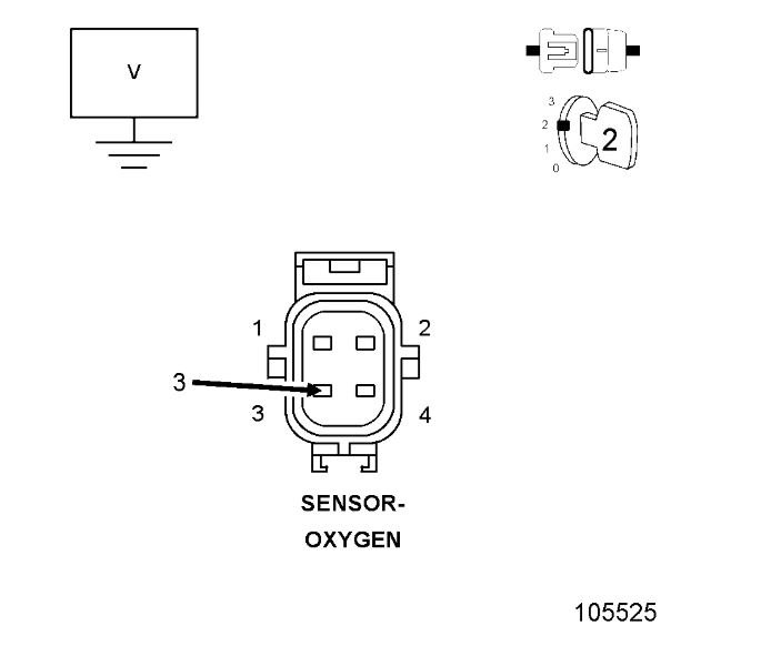

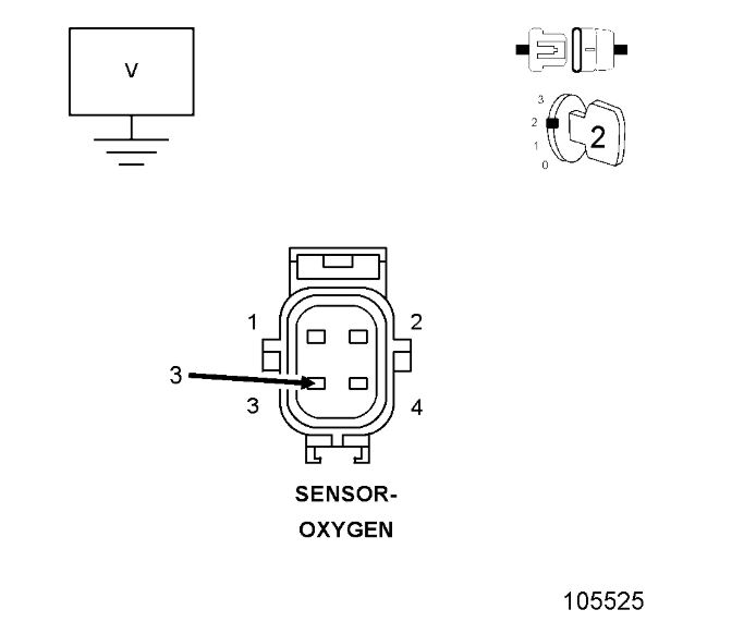

8. O2 SENSOR
1. Ignition on, engine not running.
2. Disconnect the O2 Sensor 1/1 harness connector.
3. Using the scan tool, monitor the O2 Sensor 1/1 voltage.
4. O2 Sensor voltage should read between 4.1 and 5.0 Volts on the scan tool with the connector disconnected.
5. Connect a jumper wire between the (K99) O2 Sensor 1/1 Signal circuit and the (K902) O2 Sensor Return circuit in the O2 Sensor harness connector.
NOTE: The voltage should drop from between 4.1 and 5.0 Volts to 2.5 Volts with the jumper wire in place.
Did the O2 Sensor voltage change from between 4.1 and 5.0 Volts to 2.5 Volts when the jumper wire was installed?
Go To 9
NOTE: Remove the jumper wire before continuing.

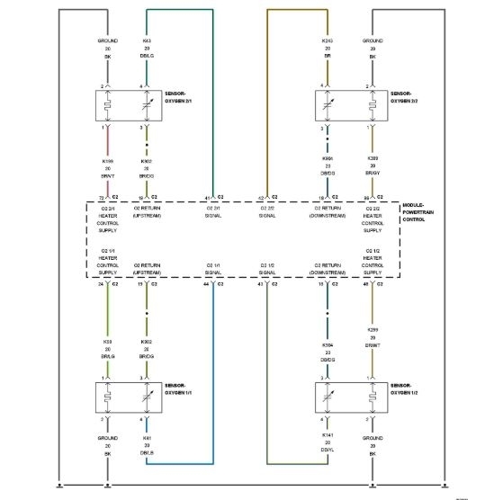

9. O2 SENSOR SIGNAL CIRCUIT
1. Using the scan tool, monitor all the O2 Sensor voltage readings with the jumper wire removed.
NOTE: The scan tool will display all O2 Sensor voltage readings approximately 5.0 Volts when only one O2 Sensor Signal circuit is shorted to voltage.
NOTE: The scan tool will display one O2 Sensor voltage close to zero and the others will read lower than normal when one O2 Sensor Signal circuit contains excessive resistance.
Is the voltage between 4.1 and 5.0 Volts?
Go To 10
Check all the O2 Signal circuits for a short to ground, open or short to voltage. Inspect the O2 Sensor connector and the PCM harness connector. If OK, replace and program the Powertrain Control Module.
10. (K902) O2 SENSOR RETURN CIRCUIT
1. Measure the voltage on the (K902) O2 Sensor Return circuit in the O2 Sensor harness connector.
Is the voltage at 2.5 Volts?
Go To 11
Check the (K902) O2 Return Upstream circuit for a short to ground, open or short to voltage. Inspect the O2 Sensor connector and the PCM harness connector. If OK, replace and program the Powertrain Control Module.
11. POWERTRAIN CONTROL MODULE (PCM)
1. Using the wiring diagram/schematic as a guide, inspect the wiring and connectors between the related Sensor and the Powertrain Control Module (PCM).
2. Look for any chafed, pierced, pinched or partially broken wires.
3. Look for broken, bent, pushed out or corroded terminals. Verify that there is good pin to terminal contact in the related Sensor and Powertrain Control Module connectors.
4. Perform any Technical Service Bulletins that may apply.
Were there any problems found?
Replace and program the Powertrain Control Module.
