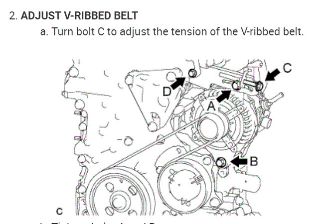

It sounds like the accessory drive belt needs to be tightened or replaced. If possible, record the sound and upload it so I can hear it. That way I will know if that is where the sound comes from'
Or, with the engine off, open the hood and locate the accessory drive belt at the front of the engine. Inspect it for cracks, fraying, or anything that seems out of the ordinary.
Next, does the belt feel loose? If so, try tightening it a bit to see if the sound goes away.

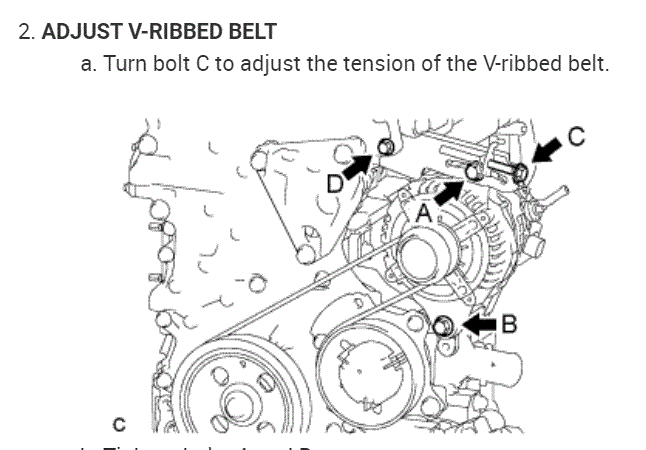

If you look at the pic below, it shows what needs to be loosened to adjust the belt. In the pic, letters A, B, and D point to the mounting bolts that need to be loosened. Loosen them (don't remove them). Letter C points to the adjuster. When you tighten the bolt (C), it will pull the alternator toward you tightening the belt. Once you feel the belt is tight, then retighten the other bolts.
See pic below.
