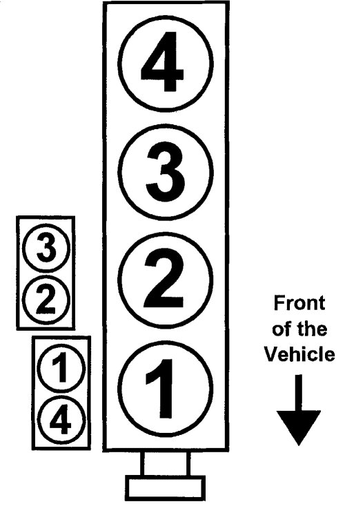

Hi, a few years back my truck listed above got a misfire on a single cylinder. I replaced the plugs, coils, checked injectors and replaced fuel filter. I have decided to start working on the truck again and am looking for any advice.
When I step on the gas it shakes crazy and engine light blinks. Funny enough randomly the misfire switched from one cylinder to another, still just one cylinder is misfiring though. Then my fuel pump randomly goes out when I tried to start it. Could it be that the pump was weak and causing a single misfire that ended up moving to another cylinder? Any ideas would be much appreciated. Thanks, God bless.

The fuel pump is certainly a suspect. Do you have a scan tool to see specifically which cylinders are misfiring? The blinking CEL indicates it is happening.
Also, does the fuel pump always shut down? Does the engine ever continue running? If so, if you have a live data scan tool, check the short-term fuel trims when the engine is at operating temperature and let me know what they are.

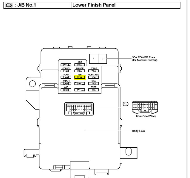

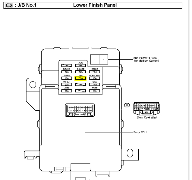

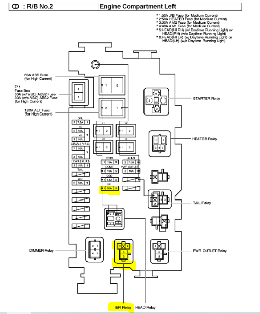

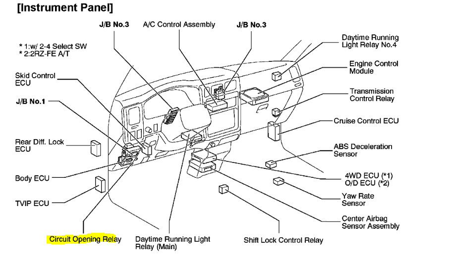

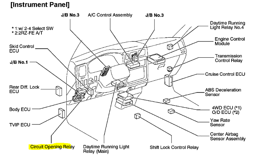

Will the engine start if you use starting fluid? If it does and then stalls, we can confirm it is a fuel issue.
Next, there is a chance we aren't getting power to the pump. There is a fuel pump relay (circuit open relay) that may be faulty. It is located in the vehicle (lower left side of the dash). Also, there is an EFI relay and fuse and an ignition fuse that may be causing issues. The injector fuse/relay is under the hood in the relay box and the ignition fuse is under the dash.
Check these things. Here are two links you may find helpful:
Dec 30, 2023 at 12:28 PM

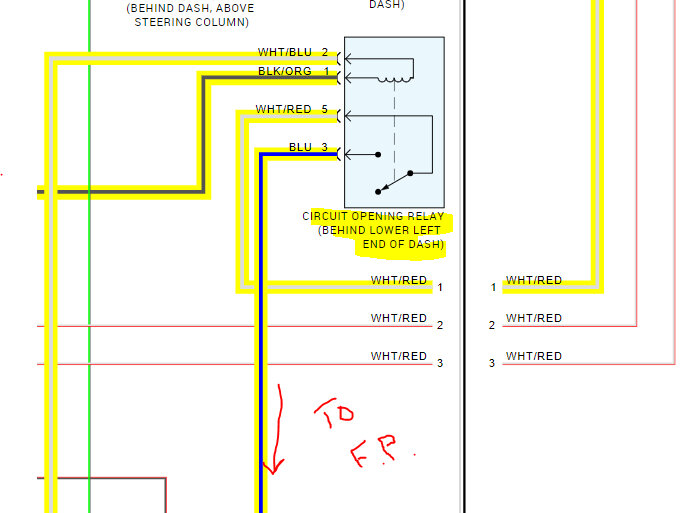

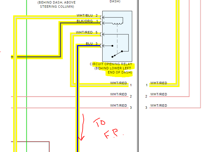

  • 110,244 POSTS
No problem whatsoever. I feel bad it isn't fixed. LOL Have you checked the circuit open relay to confirm if it has the power it needs? If the fuel pump still isn't running, we need to check if there is actually power to it. You may have a faulty pump.
See pic below.
Mar 10, 2024 at 1:25 PM

Thanks, how would I go about checking for power, all I have multimeter, I don’t have test light or scan tool?.
Mar 10, 2024 at 2:24 PM
  • 110,244 POSTS
You could use the multimeter. Set it to voltage, connect the negative connector to a known good ground location, and then use the positive side to probe for power.
Also, here is a link that explains how to test a relay and its circuit:
Let me know if this helps.
