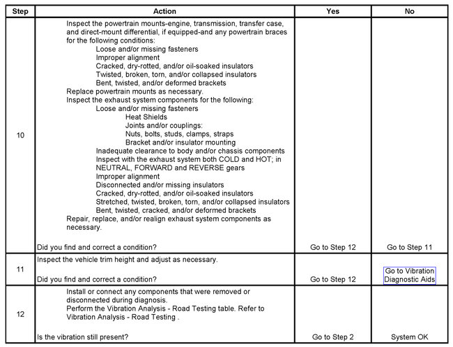

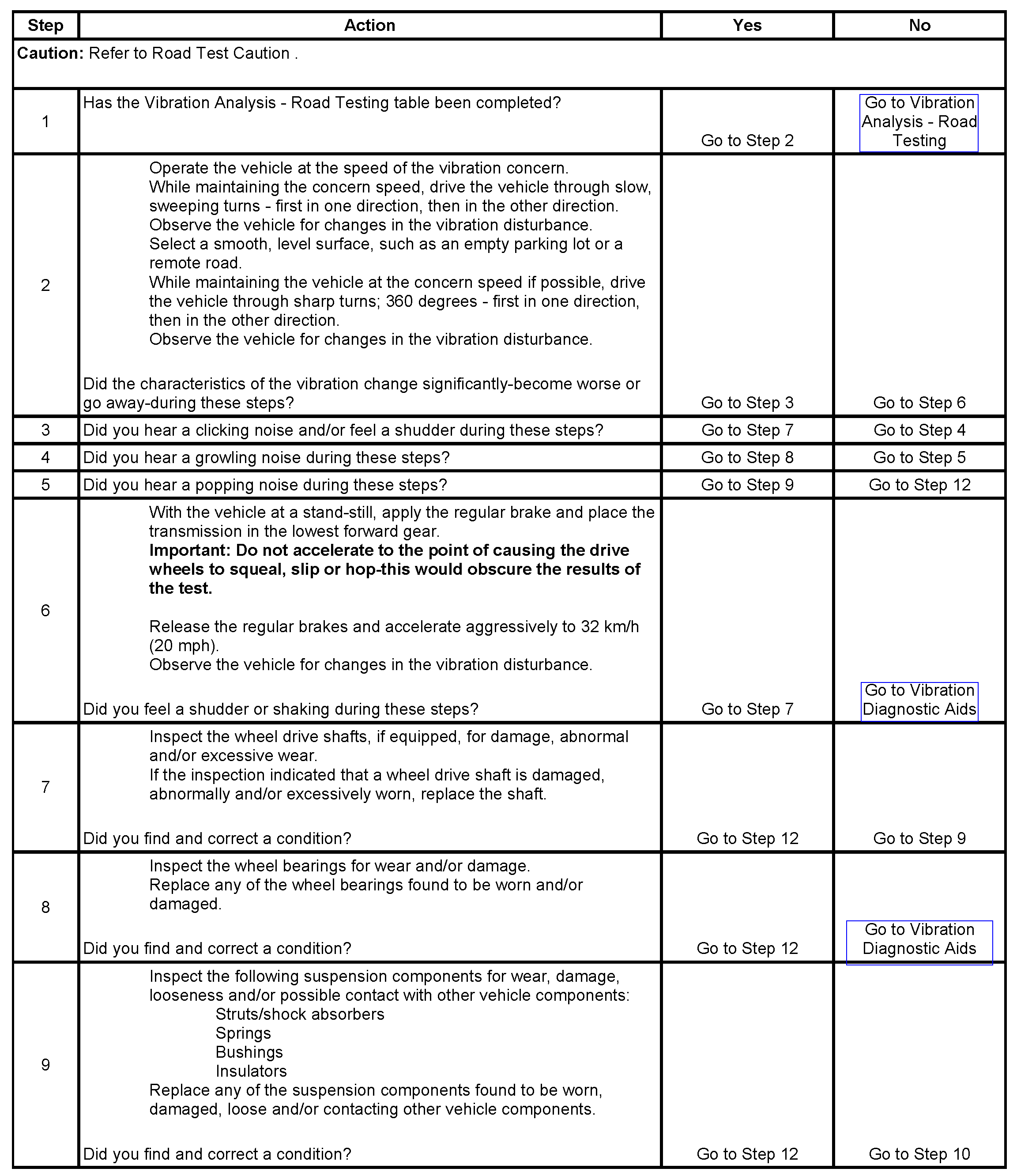

Here are directions to diagnose a hum or vibration. Pictures 1 and 2 correlate with these directions and describe how and what to check.
Vibration Analysis - Hub and/or Axle Input
Test Description
The numbers below refer to the step numbers on the diagnostic table:
2. This test will determine the effect of turning input on the vibration.
6. This test will determine the effect of an initial heavy torque load on the vibration.
7. Damaged or worn wheel drive shafts may cause a noise or vibration that may be transferred into the passenger compartment.
8. Damaged or worn wheel bearings may cause a noise or vibration that may be transferred into the passenger compartment.
9. Damaged or worn suspension components may cause a noise or vibration that may be transferred into the passenger compartment.
10. Damaged or worn power-train mounts and/or exhaust mounts may cause a noise or vibration that may be transferred into the passenger compartment.
11. Incorrect trim height may cause binding and/or interference between components that may produce a vibration.

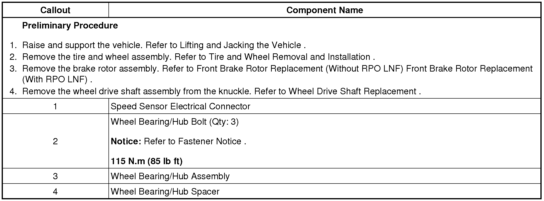

Here are the directions specific to your vehicle for replacement:
Front hub bearing see pictures 3 and 4

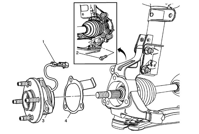

4. Disconnect the electrical connector from the wheel speed sensor.
See picture 5
5. Remove the wheel bearing/hub assembly mounting nuts.
6. Remove the wheel bearing/hub assembly and the disc brake backing plate from the rear axle assembly.
Installation Procedure
See picture 5
1. Install the wheel bearing/hub assembly and the brake backing plate to the rear axle assembly.
Notice: Refer to Fastener Notice .
2. Install the wheel bearing/hub assembly mounting nuts to the axle assembly. Tighten the nuts evenly, in a cross-pattern.
Tighten the nuts to 45 N.m (33 lb ft) plus 30 degrees.
3. Connect the electrical connector to the wheel speed sensor.
4. Install the brake rotor, and install the brake caliper and bracket as an assembly. Refer to Rear Brake Rotor Replacement .
5. Install the tire and wheel assembly. Refer to Tire and Wheel Removal and Installation (See: Wheels and Tires > Removal and Replacement > Tire and Wheel Removal and Installation) .
6. Lower the vehicle.
______________________________

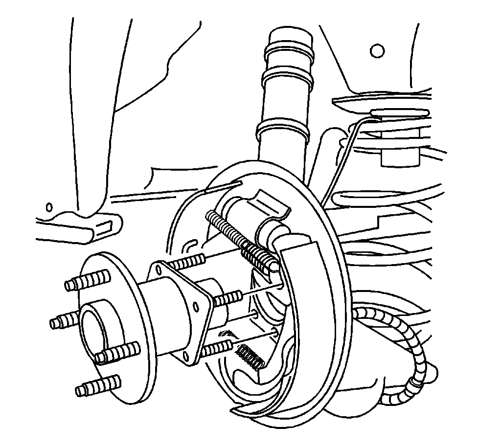

with rear drum brakes:
Rear Wheel Bearing and Hub Replacement (Drum Brake)
Removal Procedure
1. Raise and support the vehicle. Refer to Lifting and Jacking the Vehicle .
2. Remove the tire and wheel assembly. Refer to Tire and Wheel Removal and Installation (See: Wheels and Tires > Removal and Replacement > Tire and Wheel Removal and Installation) .
3. Remove the brake drum. Refer to Brake Drum Replacement .
See picture 5
4. Remove the plug from the drum brake actuator access hole in the backing plate. Using the access hole, install a support (1) for the brake backing plate.
5. Disconnect the electrical connector (2) from the wheel speed sensor, if equipped with ABS.
6. Remove the wheel bearing/hub assembly mounting nuts (3).
See picture 6
7. Remove the wheel bearing/hub assembly from the rear axle assembly and brake backing plate.
See picture 6
1. Install the wheel bearing/hub assembly to the brake backing plate and the rear axle assembly.
See picture 5
2. Install the wheel bearing/hub assembly mounting nuts (3) to the axle assembly. Tighten the nuts evenly, in a cross-pattern.
3. Connect the electrical connector (2) to the wheel speed sensor, if equipped with ABS.
4. Remove the support (1) from the brake backing plate.
5. Install the plug to the drum brake actuator access hole in the backing plate.
6. Install the brake drum. Refer to Brake Drum Replacement .
7. Install the tire and wheel assembly. Refer to Tire and Wheel Removal and Installation (See: Wheels and Tires > Removal and Replacement > Tire and Wheel Removal and Installation) .
8. Lower the vehicle.
