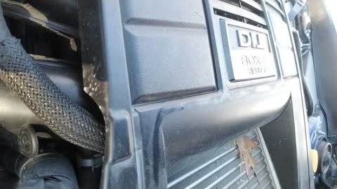

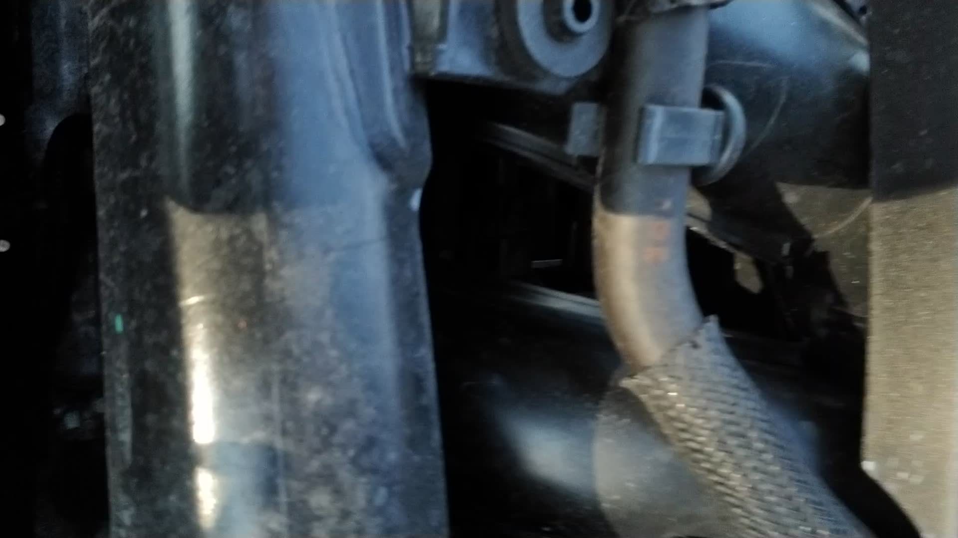

The sound continues while the car idles. Sound seems to be coming from just behind the engine somewhere under the inter-cooler. As far as I can tell it isn't related to any other systems.
