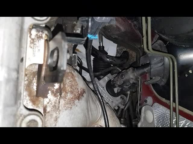

I have replaced the steering pump and attempted to bleed after but over an hour air still bubbles out, neighbors have a nice problem, fluid levers are at max before and after pump replacement. When front tires are off the ground steering isn't bad just when on the ground. Car hasn't been driven for over a year but has been turned on as well as moved around my unit car park every month. No new noises apart from this creaking sound when turning. Tires are slightly flat. We have inspected wiring around steering pump and covers over wiring have no damage and no leaks around pump itself.

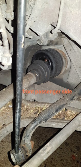

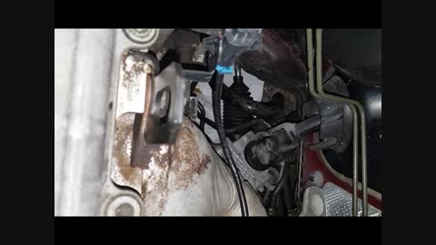

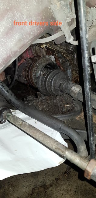

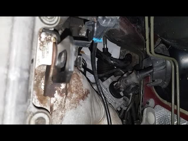

Hello, sorry for the late reply. I have attached 2 videos as I wasn't sure if you wanted the engine on or off, it seems to do it more when it's off the ground as well as with how heavy the steering still is. as you can properly tell it's very hard but in the process of doing this i noticed the driver's side first and thought I'd better check the passenger's side and saw what's in the photos and even I know that's not good so another thing to replace but could this be the reason my steering is so heavy. Unfortunately, I haven't been able to get much help with this but managed to find a way, I do hope this helps you to help me.

As far as pic 3 and 4, those are CV joint boots. They are there to keep the grease in the joint and prevent dirt from getting in. If one of the joints is bad, you may hear a clicking, feel a vibration, or notice a loud clicking when turning. However, I don't see how they would affect the steering assist.
Have you checked the ball joints? Can you tell if the sound is on the left or right side? If you have a helper turn the steering wheel (engine on or off) carefully place your hands on the ball joints, rack, and other steering items to see if you feel the vibration.
