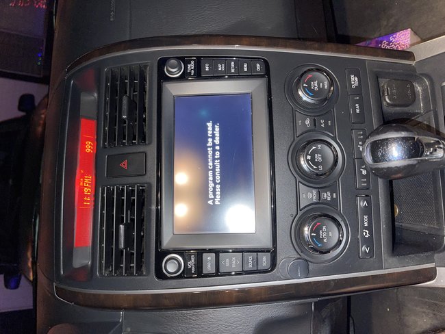

I recently bought the vehicle listed above and I only have one pending issue with it. The stereo screen displaying a message saying the following “a program cannot be read please consult a dealer”. I have been looking on several forums and videos online, but they all are for different models or years, and I keep reading about this SD card slot you have to remove and reinsert to fix the issue. I cannot find that anywhere in this truck. Can I please get help here?

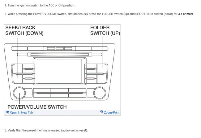

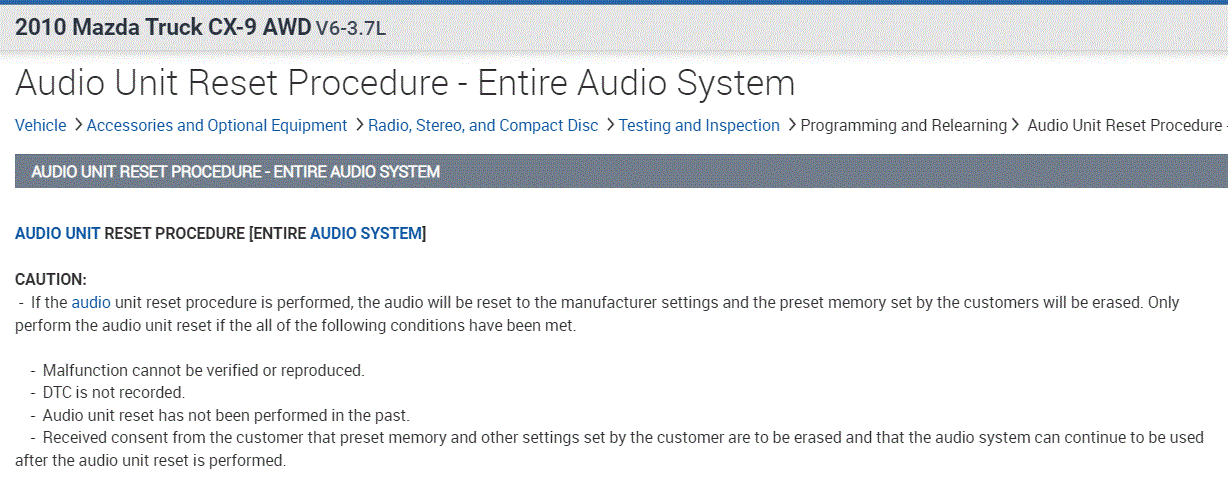

If there are no diagnostic trouble codes, then I would try to reset the unit. This will cause you to lose presets.
I looked through my schematics for the audio and there is nothing indicating an SD card.
Let me know if the reset works.
Dec 22, 2021 at 5:35 PM
JGONZO2398
  • 372 POSTS

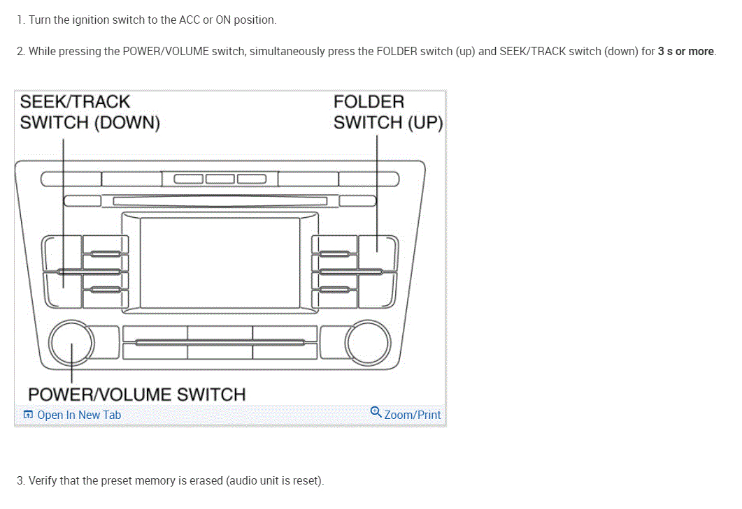

I don’t see a “folder switch” button.
Dec 22, 2021 at 5:45 PM
  • 110,194 POSTS
That looks slightly different than what my manual provided. Is there anything listed under the info or menu selections?

None of those buttons have any function since the screen is stuck with that message. That is the issue.

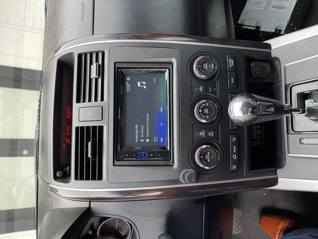

Problem fixed. haha
Dec 27, 2021 at 7:17 PM
  • 110,194 POSTS
Thanks for the update. I'm glad to hear you got it taken care of. What was the ultimate fix?
Dec 27, 2021 at 7:38 PM
JGONZO2398
  • 372 POSTS
I just installed a new stereo. Did not feel like going through the trouble.
Dec 27, 2021 at 7:51 PM
  • 110,194 POSTS
LOL... That will fix it. Regardless, I'm glad it's working again, and thanks for the update.
