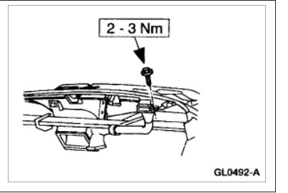

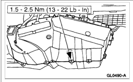

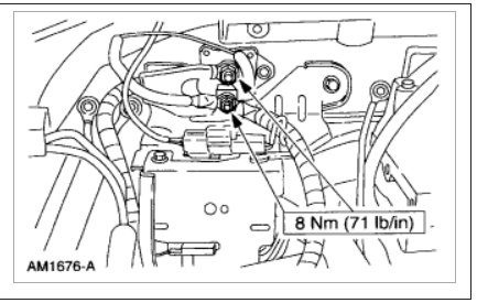

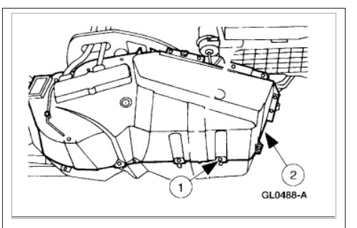

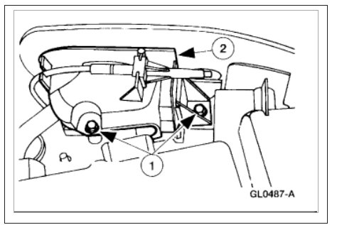

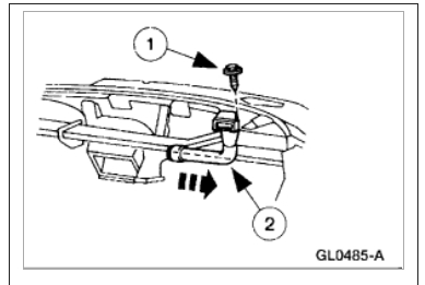

My front heater core went out on my vehicle listed above it is an XLT model. Can I get information on how to take care of this problem? If I am able to look at some pictures or diagrams on how to take care of this problem, it would make things a lot easier to show and explain the process of this project to my son. My son is eleven years old and has worked on any and all projects I have done myself since he was old enough to get a wrench out of my box. Thank You!
Dec 14, 2017 at 4:07 AM
  • 55,758 POSTS

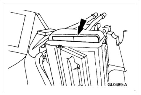

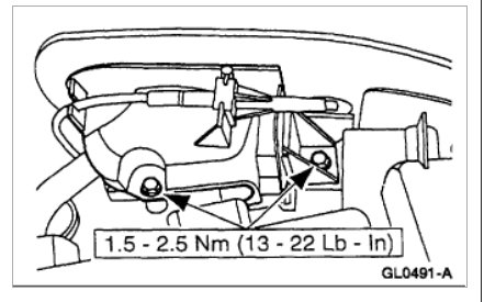

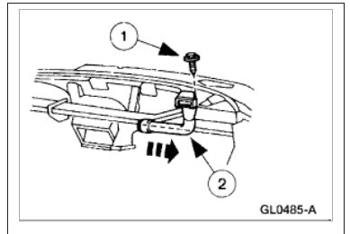

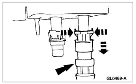

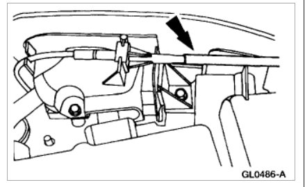

Ya know I had a talk with my dad about why people become mechanics and he said because they have it in their heart. Will never be good unless they want it. I am happy to say your son going to be one of the best. There is one thing I am pretty confident about a computer will never fix a car. Here is a guide that will give him an idea of how to do the job and the diagrams (below) on how it will be on your car.
https://www.2carpros.com/articles/replace-heater-core
If your car has air conditioning or if the system needs to be
