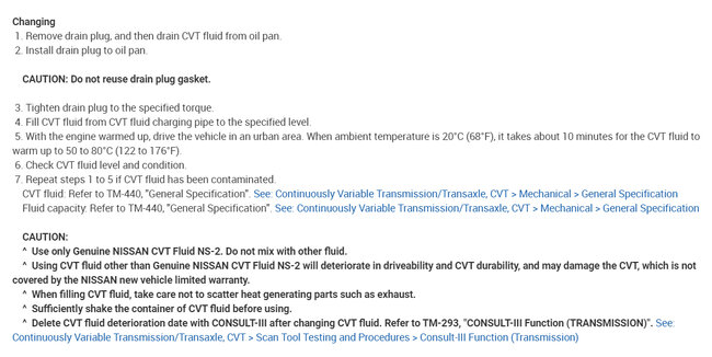

I don't know what steps to take to change the transmission fluid. I know some vehicles you have to leave it in neutral and flat level ground to check the fluid. Is my car like that or how do I check the transmission fluid. Thank you

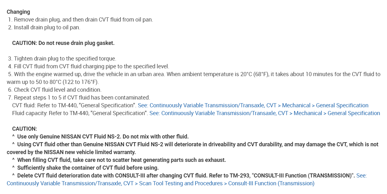

Sure, here is a guide to help you service the transmission in your car with instructions below as well:
Model RE0F09B .................... 10.2L (10-6/8 US,qt)
Model RE0F10A .................... 8.3L (8-3/4 US,qt)
Type .................... Genuine NISSAN CVT fluid NS-2
NOTE: Use only Genuine NISSAN CVT fluid NS-2. Using transmission fluid other than Genuine NISSAN CVT fluid NS-2 will damage the CVT transmission, which is not covered by the NISSAN new vehicle limited warranty.
Check out the images (below). Please let us know if you need anything else to get the problem fixed.
