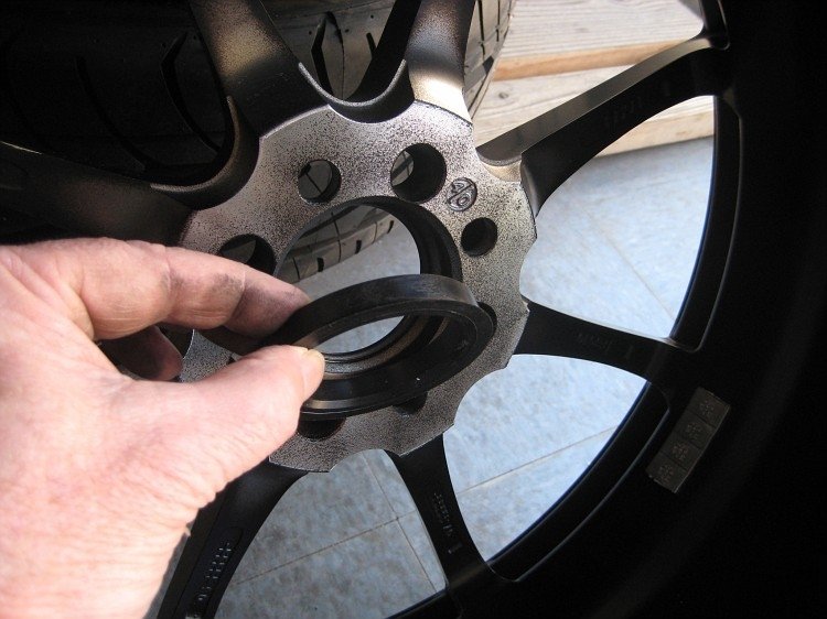

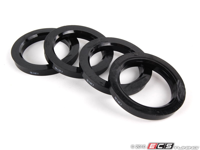

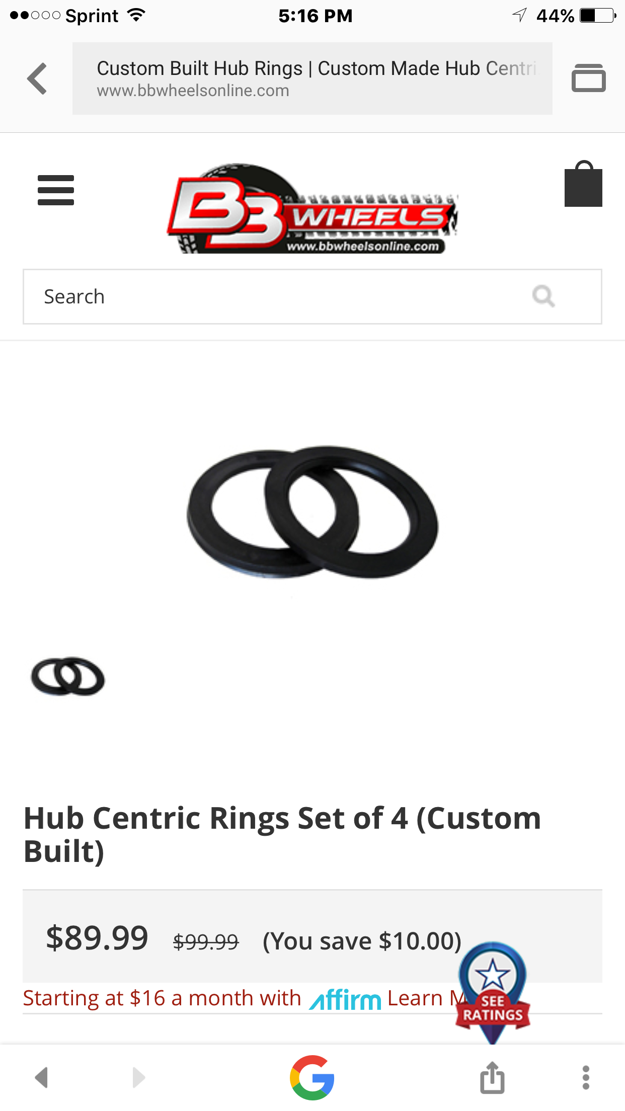

Update: Replaced my ball joints, which at second glance did not appear all that bad for an 11 yr old car. This did not change anything as far as my steering wheel wobble. It was still there! I called one of the shops that did my tire rotation and they do in fact use a Road Force Balancer and reiterated that my tires had no issues. I checked my brakes again, no hang ups or any issues with them. Finally I went back to google and saw an article about hub centric rings. I thought to myself that I did not see them when I removed my tires countless times for inspections. I think that one of the shops that did one of my balances/rotations did not put them back on my wheels before attaching to the hub. I ordered a set for $25 (74.1mmX69.5mm) and installed them yesterday. Steering Wheel Wobble gone!! Thanks for all the help gentlemen, really got my brain thinking and it was awesome to hear several different perspectives and experiences to zero in on my issue. Have a great day!

Dandy. Any chance you could post a photo of the part, or a place to go to look at a photo? I've been a suspension and alignment specialist for over 25 years, but I've never heard of that part. I'm wondering if those are some type of spacers used for non-standard wheels.

No problem Doc! So they can be plastic or metal, you put them in the bore of the wheel, then place the wheel on the hub, and as you torque the wheel down, you are essentially press fitting them on the hub to ensure a tight fit, then presto no steering wheel wobble!

Normally the center hole of the wheel just matches the hub. I learned something new today. Thank you for posting that.
